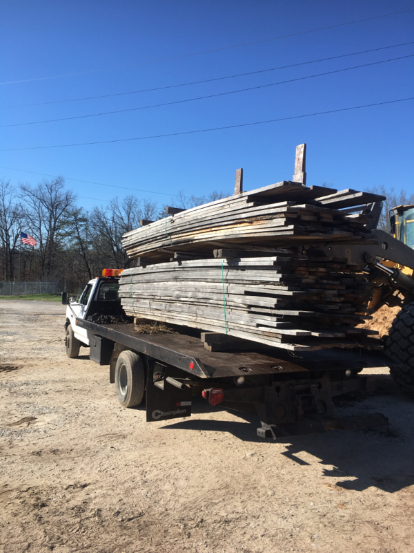

   / New (to me) safe, need ideas. #40
This bottom stack of lumber weighs as much as the safe in question. As long as you're properly equipped it's not scary stuff. I'd hate to go at it with winches and ramps.
