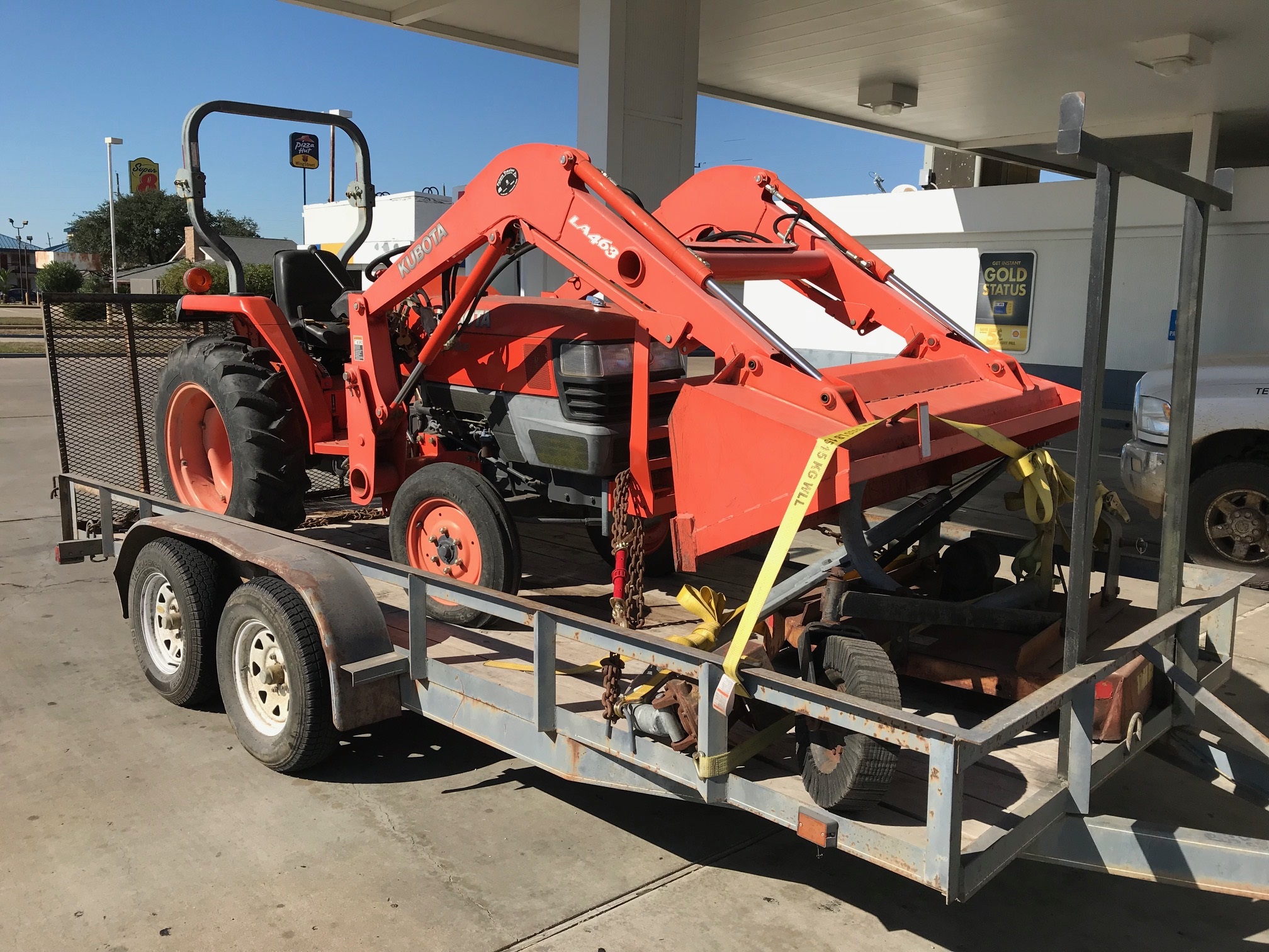

Hey guys, new to the forum. I just purchased a 2007 Kubota L2800F, with just 32 hrs on it. Its in great mechanical shape and guy threw in a brush cutter, grader blade, and post hole digger with 2 augers all for $5K. I am really stoked about it, it was a neighbor of mine at some hunting property I own in Texas. It's a little sun faded from sleeping outside, but in great shape otherwise. Oh and it has a FEL on it also, which is what I have a question about. I read in the manual to keep max air pressure in front tires for the FEL use, but not sure that means max psi marked on tire or the recommended pressure in owners manual. Anybody know?

Wow sounds like a fantastic deal. Personally I would go with max pressure printed on tire. Let’s see some pics
