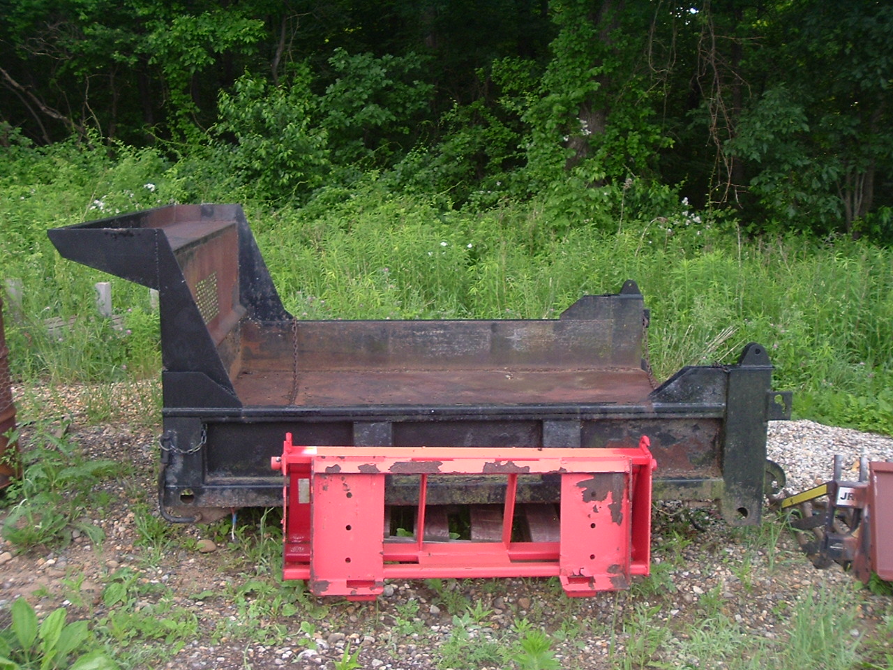

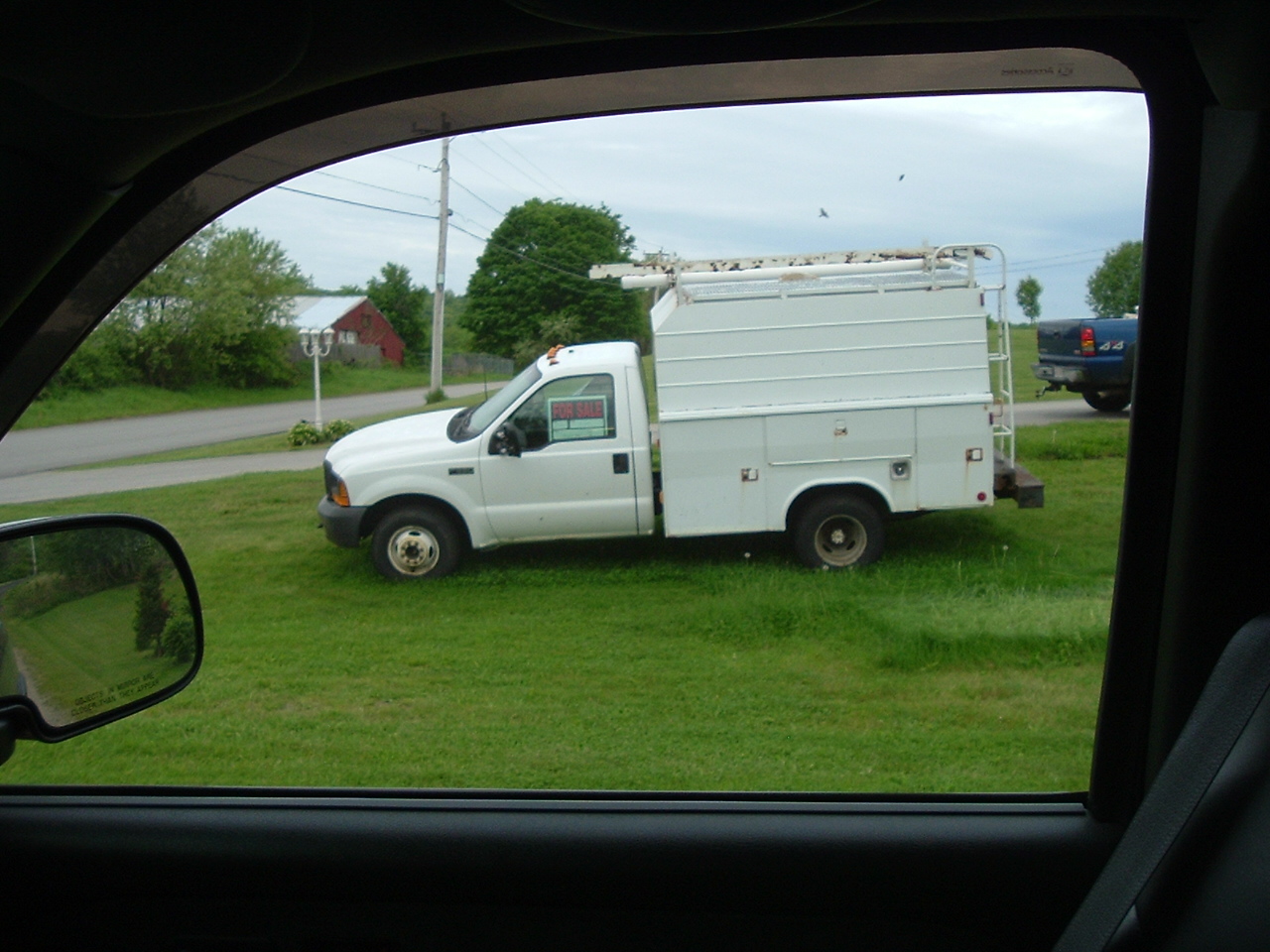

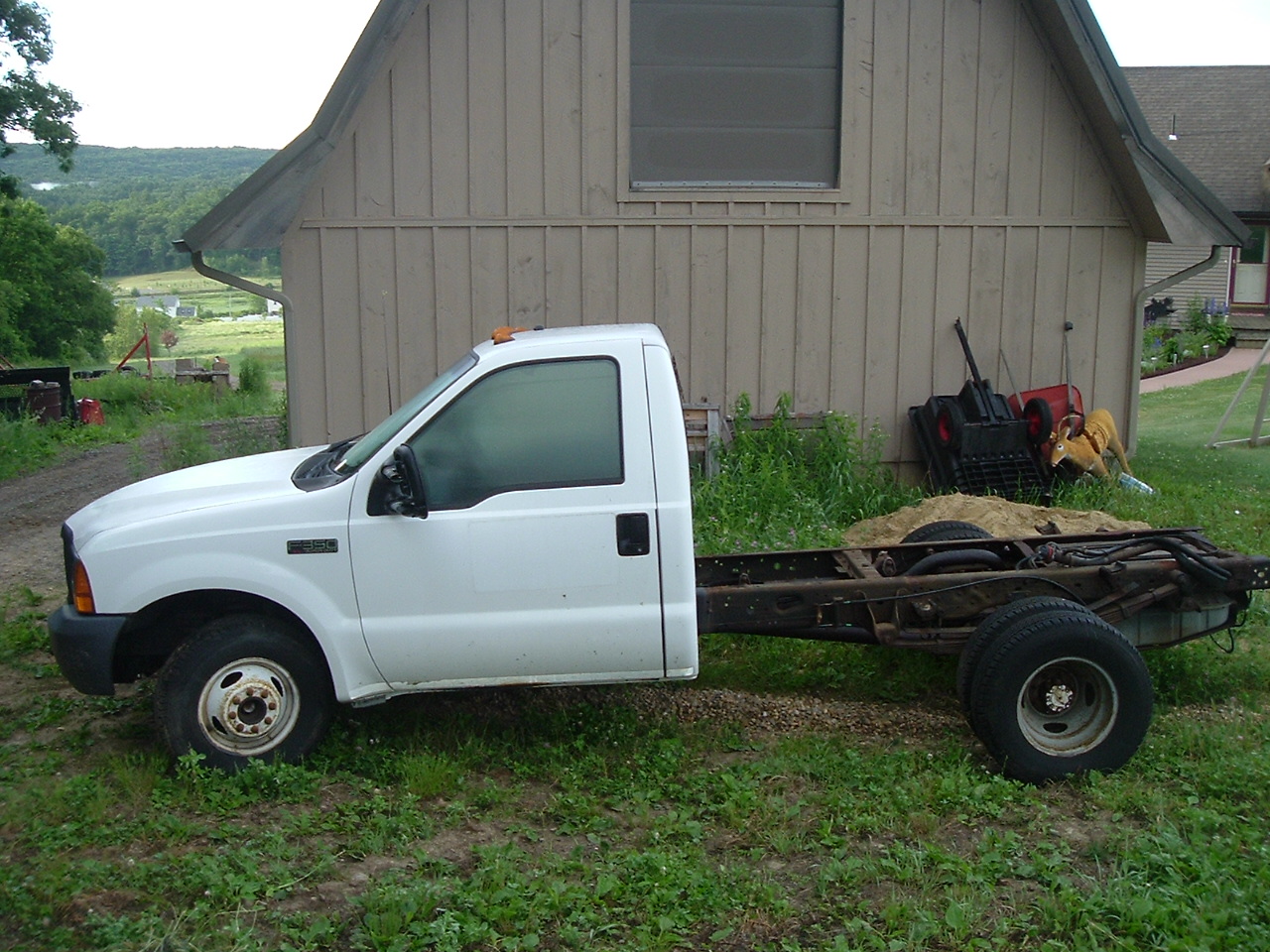

OK, here goes:
Truck as it was at my neighbor's
Truck body we bought (that's too short!)
Truck with utility body removed
