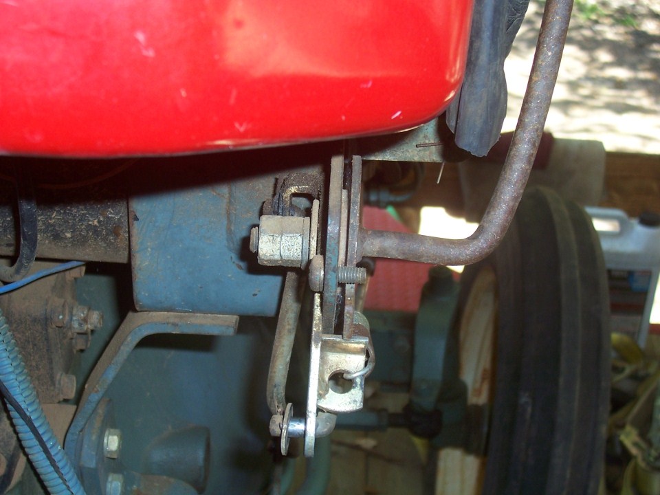

3. When I let off the throttle, the tractor doesn't want to idle. It seems as though the vibrations are working the hand throttle all the way forward by itself and killing the engine. Is this normal? If not, is there an easy fix?

3. I am sending you a pm so you can email me and I will share something with you to shown you the friction washers on your throttle and how it all goes together.

Winston pretty much covered it. There is a friction washer where the throttle lever pivots in front of your knee. I tried making one, a couple of times. That never worked well. I gave up and bought the proper one from hoyetractor.com.

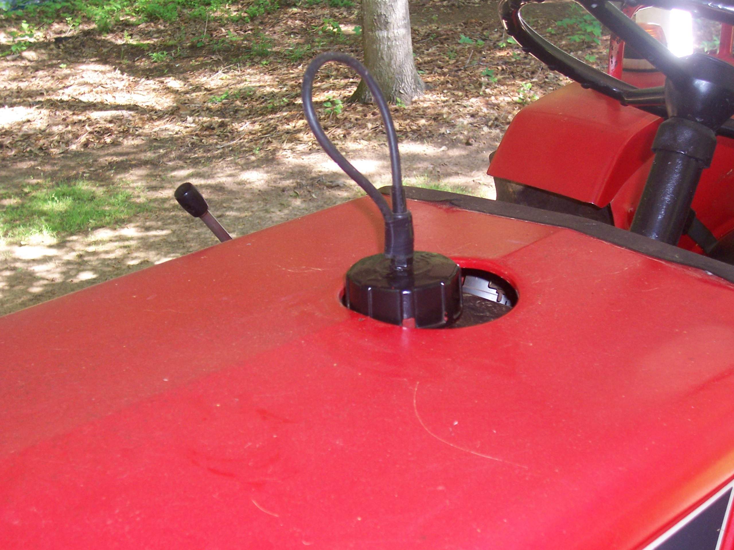

I would replace that bogus fuel cap immediately to avoid condensation in the diesel. Two choices: first is the proper cap and a mesh screen that goes under it for filtering when you refuel. From hoyetractor. Other choice is a $65 cap with a fuel gauge in it. Ask Hoye if the float in this one is calibrated for the size of your tank.

On #3 if you look at your throttle lever there is a washer/friction plate in between that holds it in place. I'm sure it's on the Dia. winston may have sent and Cali. mentioned. Not much to it!! In the pic. is what it looks like new you can see it. They wear and get old and brittle. Mine fell apart and came out when I tried to Adj. it. The two locking nuts is how you Adj. it and adds tension. Fredricks mailed mine in a reg. Env. Yrs. ago when I just bought my 2000 and I'm sure they're pretty much the same. FP.8220 is the # of it. And just vent the cap to prevent condensation I just posted it and received a good reply well done on it and didn't cost me anything. Came off a old ATV. It's just a tube. Here is the pic. of it while your here.
