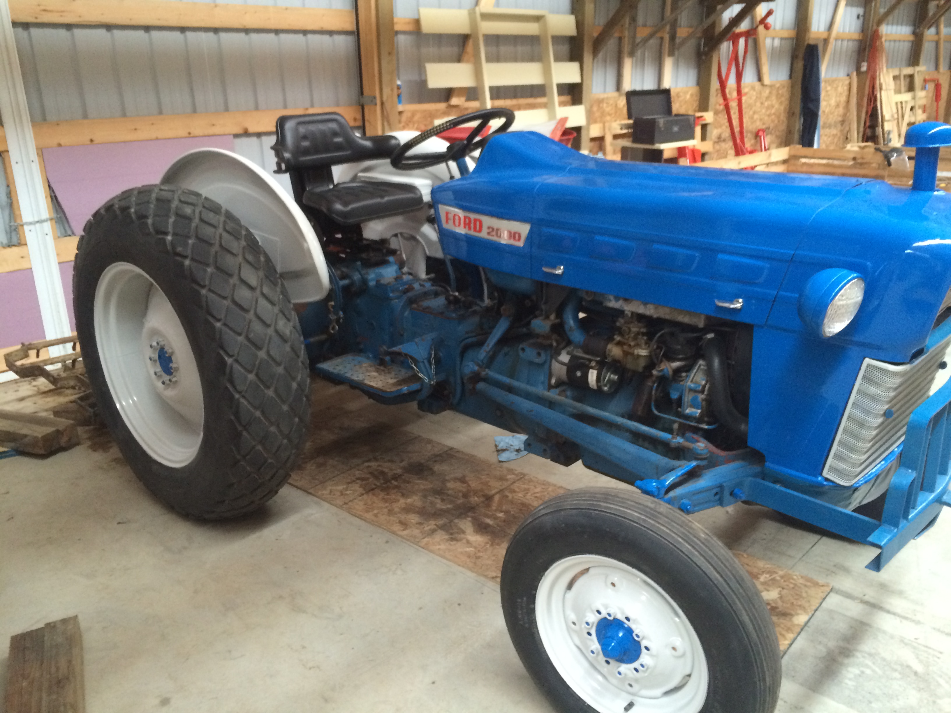

The base coat is still curing. It is a Tisco gloss industrial enamel.
While I wait, I wonder if it is advisable to wet sand it with 2000-3000 grit prior to the clear coat application?
In the past, I have used lacquer paints and have always done so. Your thoughts?

Update:
I took a chance and sprayed 2 coats of Majik gloss clear coat over cured Tisco gloss Industrial Enamel and it went on beautifully and thus far, 3 mos. later, it still looks beautiful. Shiny and smooth.

I waited 2 weeks for a good cure. Took the wax and the subsequent shine without a problem.

Ask and ye shall receive.
Before:
After:
Note two items:
1. The frame is not yet painted. Impossible to do during a Michigan winter when the tractor is being used regularly. I will peck away at it this summer.
2. This is Tisco's version of the old Ford "Empire" blue. To my perception, it is more consistent with the current New Holland blue instead of Ford's Empire blue. I prefer a softer shade of blue, but you get what you get. Tisco's New Holland blue is a deeper and louder shade of blue than you see on the tractor here just in case you think someone bought the wrong paint. The Majik "Old Ford blue" is, in my opinion, much closer to the factory paint job. The rims and fenders were painted Tisco's "Light Ford Gray" and are spot on. I took the liberty of painting the fenders gray even though this tractor came from the factory (Sept. 13, 1965) with blue fenders. Evidently, a few of the very early 3-cylinder "Thousand series" tractors sported the blue fenders. I did some research from Ford's original brochures to find that tidbit. Shortly into production, it appears that painting the fenders light gray came into vogue. Finally, it was a real challenge to find two original mylar stickers for the hood. We found one in Wisconsin where it was in storage since 1993 and the second in Georgia where it was collecting dust since 1984.
