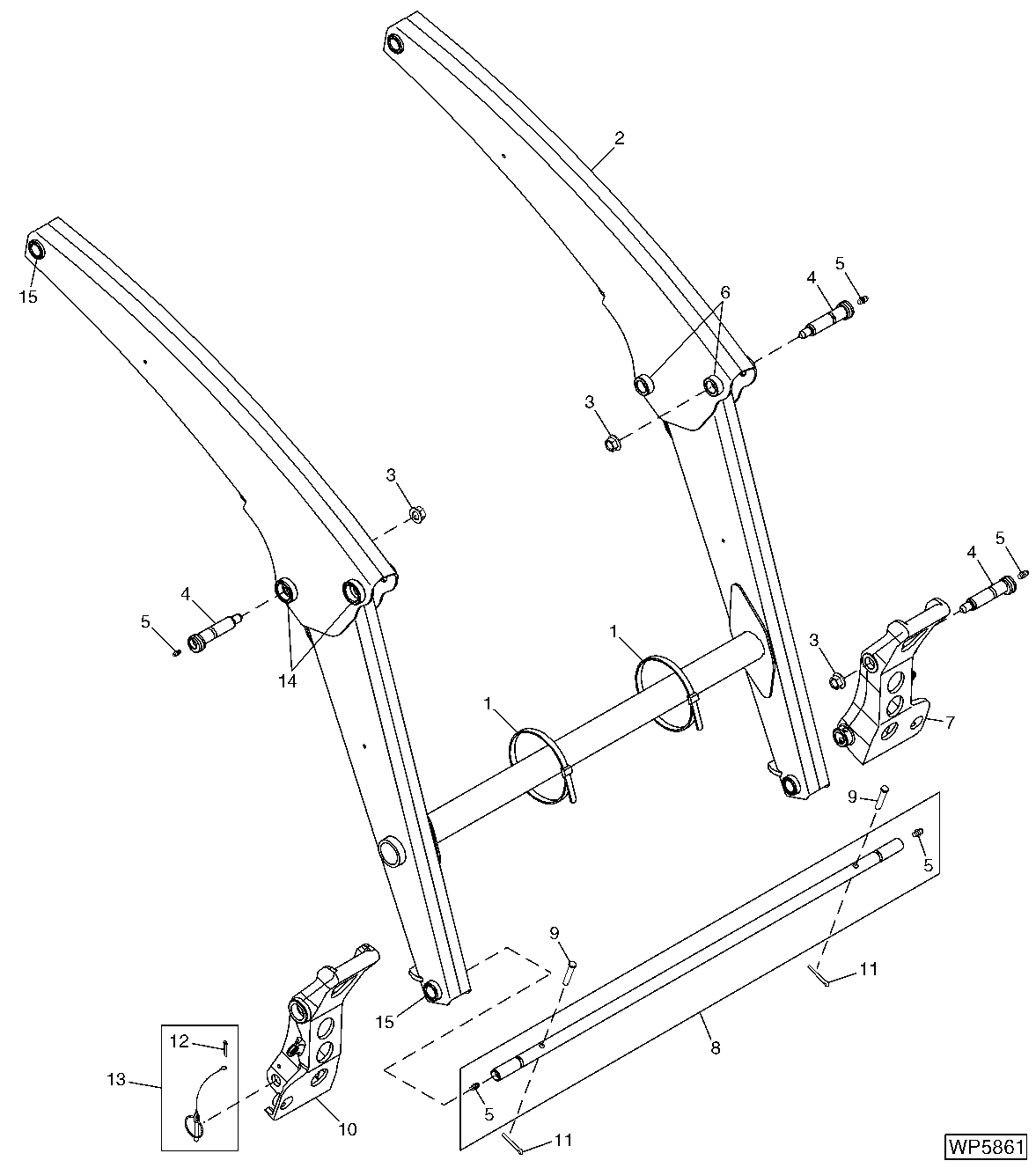

:confused: The JD QA is incorporated as part of the FEL (a 300CX in my case).
Not a good answer. If it were to come off to be replaced by the universal SSQA, there would not be 132# added. The amount added would be 132#- whatever the Deere coupler weighs.
   / New to tractors and heard a rumor about Kubota #26
According to JDparts.com holders(parts keys 7 & 10) weigh 13.47#s each & timing pin(parts key 8) weighs 9.46#s on a JD 300CX.
Sorry about that. I didn't understand the the question... correctly I guess. Hence the "confused" icon. As Tx Jim has provided (thank you) a breakdown of my FEL, a SSQA would have to be added to, not replace, the existing attachment configuration.
Further to my confusion is my lack of knowledge of other tractor FEL attachment configurations and/or methods. I've only ever owned/operated my JD 4105 and I only have the two FEL implements; which are simple to swap around... which is a good thing for me as I'm a very simple man. :)
   / New to tractors and heard a rumor about Kubota #29
So ~36# for the proprietary adapter vs 132# for the the SSQA for a difference of ~96# plus perhaps a little bit of lift lost (depending on how much the attachment is pushed forward from the pins.
Aaron Z
   / New to tractors and heard a rumor about Kubota #30
It does replace the items Jim has listed.
