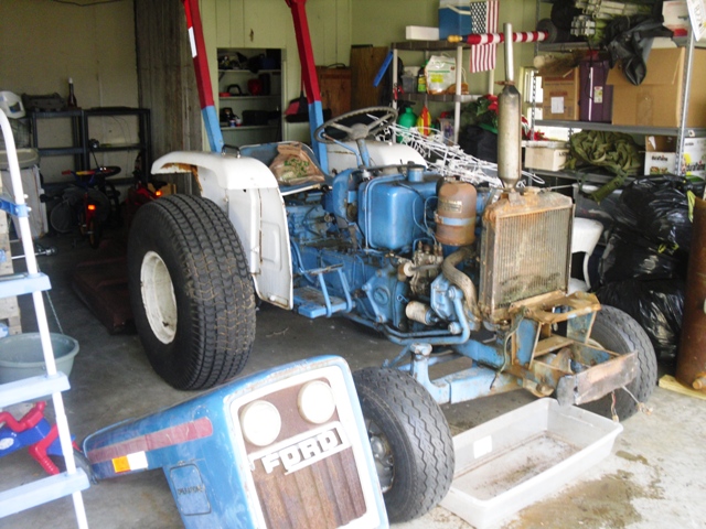

thanks for the replys...i have the oil bath filter cup on the way from NH, since it was missing when i got it... i cleaned the rest of the air screen for about 2 hours until the cleaning fluid ran clear. They no longer sell the gaskets though, do you think i could just use RTV to make the seal? Previous ownere had an inline filter on it instead of fixing the cracked fuel bowl (on the way from NH). Cleaned out all the dirt dobbers and will replace the bowl and o rings. Im glad you mentioned the lights because the dash is part of the wiring mess i had mentioned. Not having an idea of what it used to look like is hard for me to know what got changed over the years, though i know some things did because there are holes and extra switches, I dont see any lights though. The tach and meters worked when i got them so thats why im hesitant to mess with them? Here are some pictures..

Congrats on the "new" 1700. I see you also have the turf tires like JC. Mine has the ag tires so it sits alittle different, and a roll bar, which I dont think either of us have on ours. All the maintenance you are or will be doing is the most important steps to take. I agree with JC also, it should have no trouble with the 5' mower. I run a 5' also with no trouble. When you get it all back together, how bout a few more pics of it in action. TB

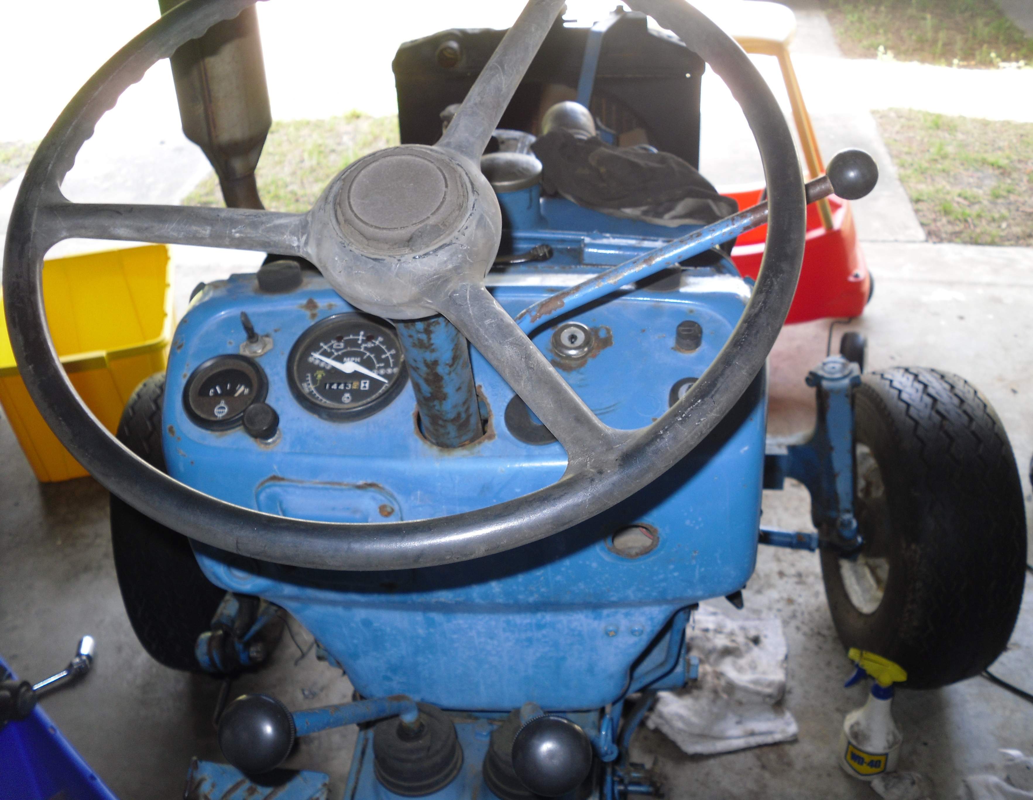

Dash has been changed as follows: Big Hole at bottom used to be the Key, Where the key is now used to be a glow plug visual indicater, Top right was and probably still is the horn, Below that is the flasher light switch (missing knob). Looks like some major changes.:confused2:

Anyone have a pic on what the dash or wiring should look like, as you can see mine is wacked?
Is there a foot pedal for the throtle for this model...looks like something was there on mine at one time?

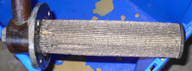

Got to the Hyd screen/filter today and was surprised it wasnt as bad as i thought it would be. How can i get the rest of it out if all i have is a shop vac? Thanks for the help to the newbie.

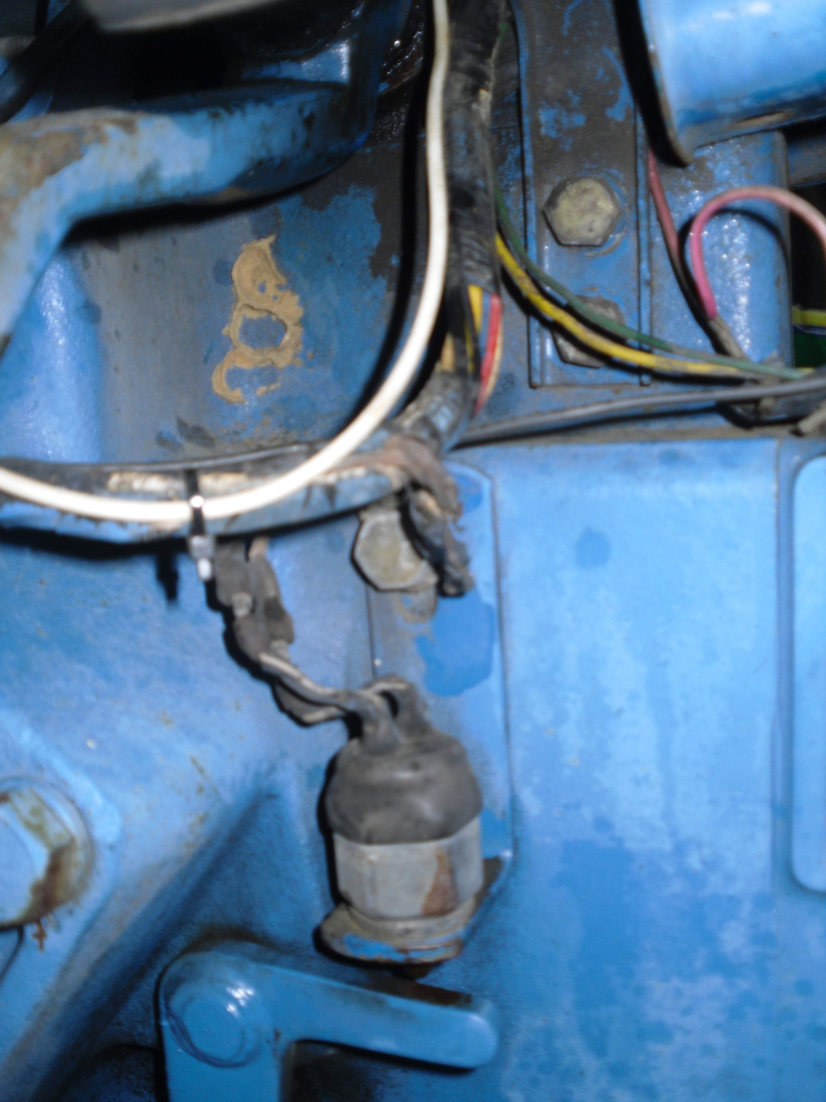

more pics to the questions above..... The clutch switch is stripped to bare wires and wrapped together. Like i said the wiring is a mess.

No pics on the wiring.
You are missing the foot throttle.

I just use a hand wire brush and old kerosene, camp stove fuel etc to clean the screen.
