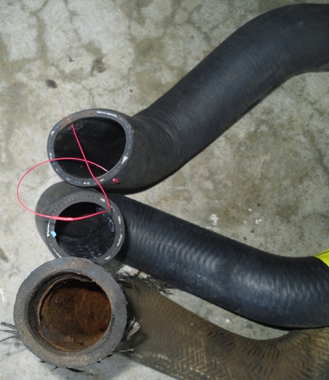

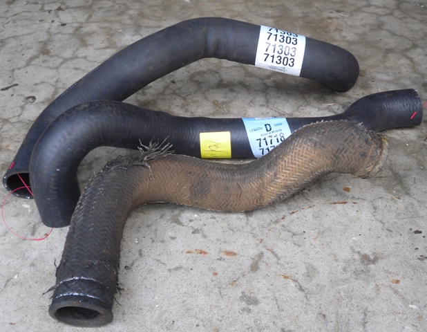

JC- I ran into a small issue with the aftermarket coolant hoses (adv auto) and was wondering if you were aware of it. The top was easy and not an issue however the bottom one based on the SKU# came back to a 71303 hose. The dia on this hose is slightly larger and thinner and i dont believe it would seal well. (top hose in the dia comparison) I was able to have them look up the 71718 hose which they have as a D. That hose dia fits perfect and is more in line with the original. After a little trimming on both ends it fit fine. The funny part is the 71303 looks to be a much easier fit (shape wise) than the 71718 except for the dia issue. Any how, just wondering if they changed the sku on you after you had originally bought them.
BG,
it's been several years since I have done it. I had to trim the end a tad for good fit but dia was perfect and it never leaked in the last 4 years.
JC,
   / New to tractors ford 1700 question.
#22
Do you remember if it was that 71718 hose or not because that sku is #5371880 for the 71718 hose.
In your post you had hose 71718 sku #5191785 (which comes back to the 71303 hose with sku# 5191785). Believe me im not complaining...i just wanted to point it out because i know a lot of people use your tips about the aftermarket hoses. I had bought both and used the 71718 hose with a sku of #5371880 for the lower. Thanks again...i wouldnt of gotten close without your help on it.
Are you kiddin me? I can't rememberer what I had for supper last night:D. I went to my handy notes and the hose # was 71718CS rather than 71718.
When I changed my hoses, I drained the system first and took the hoses with me. I knew one of the guys at the counter and he suggested me to go to back of the store and eyeball, compare and contrast and pick the best matching one. SKU's don't always stay the same and it might have changed and obviously I don't keep up with that. I still have my old ones in a bucket for future reference if I need.
