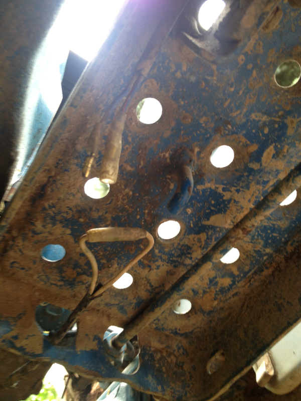

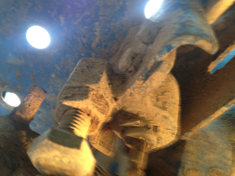

The proof meter is not working and is filthy on the inside with the needle sitting sideways at the bottom of the guage, so I have no idea how many hours are on it. The tractor has a good deal of surface rust, but with the exception of the proof meter everything worked untill the day it was dropped off at the house. It started fine when the fine gentleman from whom I purchased it pulled it off his trailer, but then the next day it would not crank. I can use a jump box to the starter and it fires right up (glow plugs seem fine), but the key won't do it, no clicking, no noise, nothing. He told me it was the 'clutch safety switch' and he'd be willing to look at it, but its been a week and I don't expect he'll be out to help me (nor is he really obligated to do so I guess) but from what I am reading, there is not one safety switch dedicated to the clutch, just one for ensureing it's in neutral? Can anyone give me clarity here and tell me where the switch(s) are? I have the ordered an original operators manual, wiring diagram, and shop manual so i can educate myself on this cool old tractor. Plan to use it on 8 acres to brush hog, plow snow, maintain a gravel driveway, dig some serious post holes.
So basically for now just two questions -
1) where are the neutral safety switches cause the wife is pissed I bought a tractor that won't start!
2) are the 1600 and 1700 pretty similar to one another?

Please read the link below. Look at the post #9 with a pic for 1700. You need to look at the clutch mechanism and it mechanism. Somewhere it has to activate a normally open switch closed by pressing the clutch to complete ignition circuit. This is to avoid tractor moving forward if in gear and you start.. not a good thing. You can for the purpose of testing jump the wires to see if tractor start. You can simply test the switch with a test light or ohm meter like it is pictured.

Ok, i found my switch, not in the same place as the one on the 1700 pictured earlier in this thread. Mine is under the left footrest near the back. Pick attached, simple to bypass and she started right up. When i have time i will work to repair or replace it
I always like to do a postmortem on dead part. You might have rusty contact on the switch. I'd take a rubber cover off and start looking to see if I can open up the switch to see the innards. You might be able to clean the contact and reuse it again.

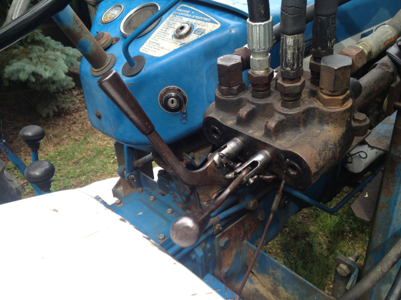

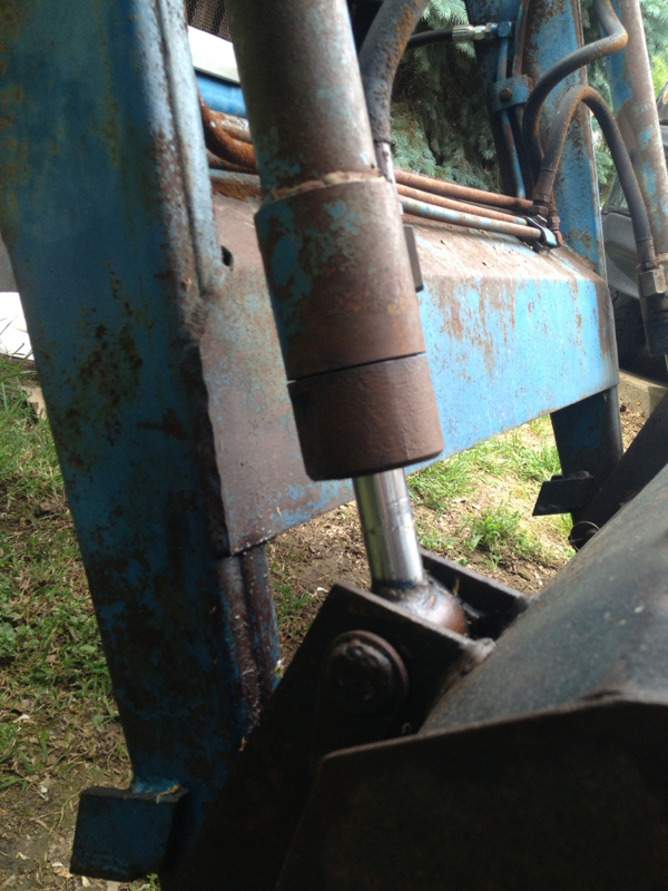

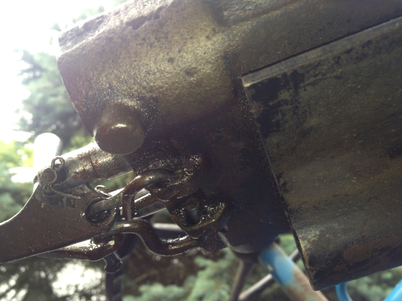

Next set of questions ..........leaky hydro. My joystick drips from the right lever, and a cylinder on the bucket drips. Are these tough to repair?
Also, any comments on how similar a 1600 is to a 1700?
