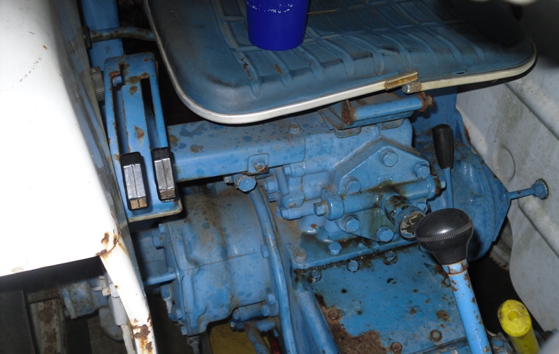

What is the inside lever on the hyd side for and where should i set it at? Ive greased every fitting i could find, and am getting ready to actually start to bush hog the next time i get out there.... having never done it before is there any thing special or tricks to it? Thanks for everyones help i never would of gotten it this far if it wasnt for all of you.

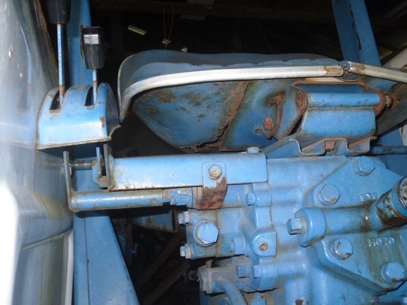

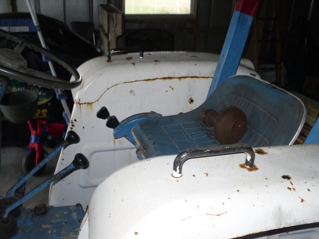

Here is a pic of the lever....the one closest to the seat. Where should i set this one?......Im sure the flower beds wouldnt be a good idea on mothers day....next week however is a different story:D

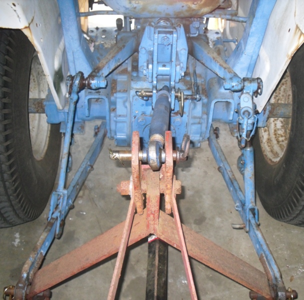

Hmmm. looks different than any 1700 I have seen. The one on the right is most probably your 3 point lift lever. what happens when you move it with the engine on? does your lift arm move? you see it has a upper limit(adjustable). loosen it, move the handle as far as you can move up till you here relief valve chattering, lower it just a tad just as quits chattering , that's you max lift, tighten the upper limit. The one to the left of is some extra hyd remote or draft control. take a pic of the back of the tractor like the pic below and we might be able to tell. what would happen with you move the left handle up or down? or can you tell?

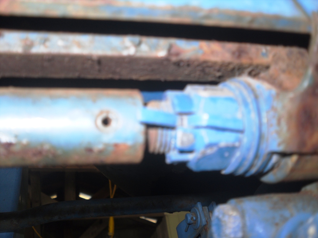

Ok i took a couple of pics so hopefully that will help out... i dont see any kind of upper limit adjustment on mine? Thanks for all the tips on the hogging..ill use them all.
The outside lever moves my 3point up and down.. not sure if the inside is doing anything that i can tell.

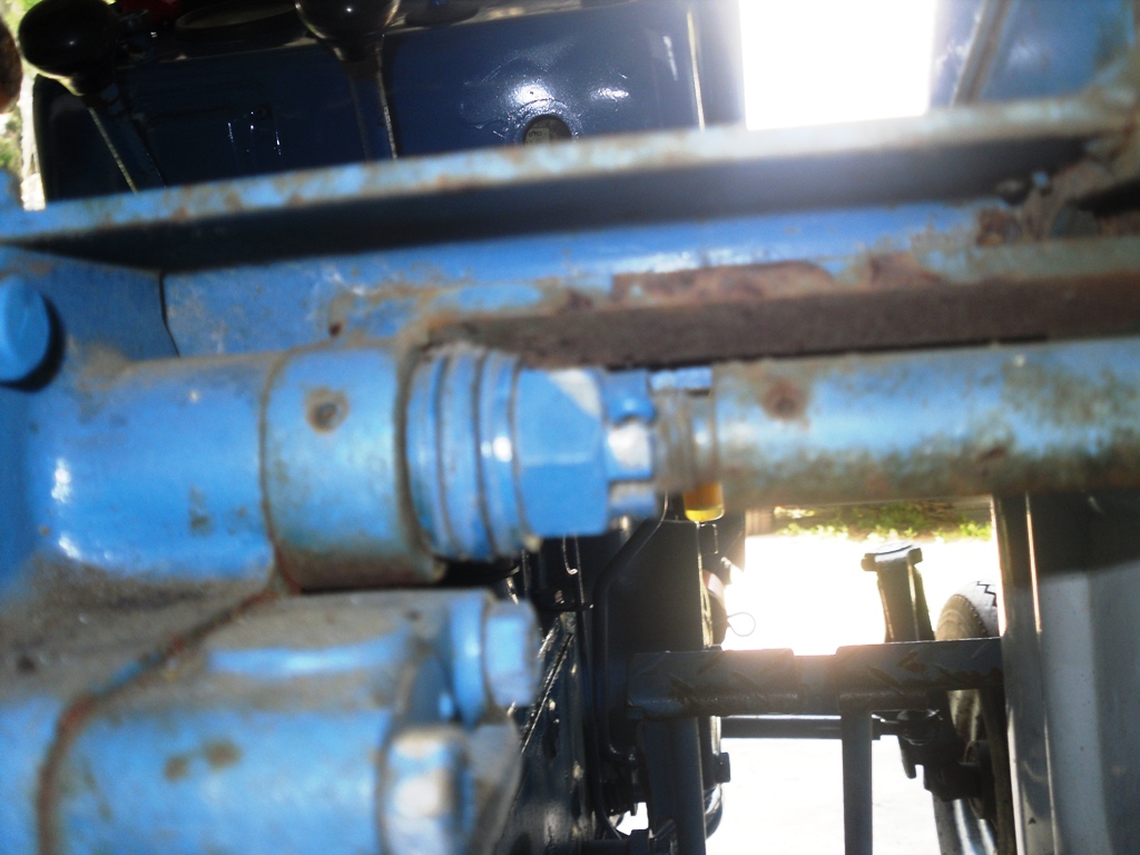

Although I have not seen draft control for 1700, yours appear to be one. The top link bracket is different. draft control maintain a constant depth for ground engaging application like plowing. Can you take a picture where it shows the linkage from smaller lever and how it attaches to control valve or lift arm. I don't see any hydraulic remote(connection ) in the back. do you have any hydraulic connection in front or middle of the tractor.
I hope guys with draft control experience chime in to corroborate or discredit what I just said.

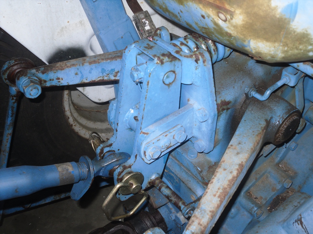

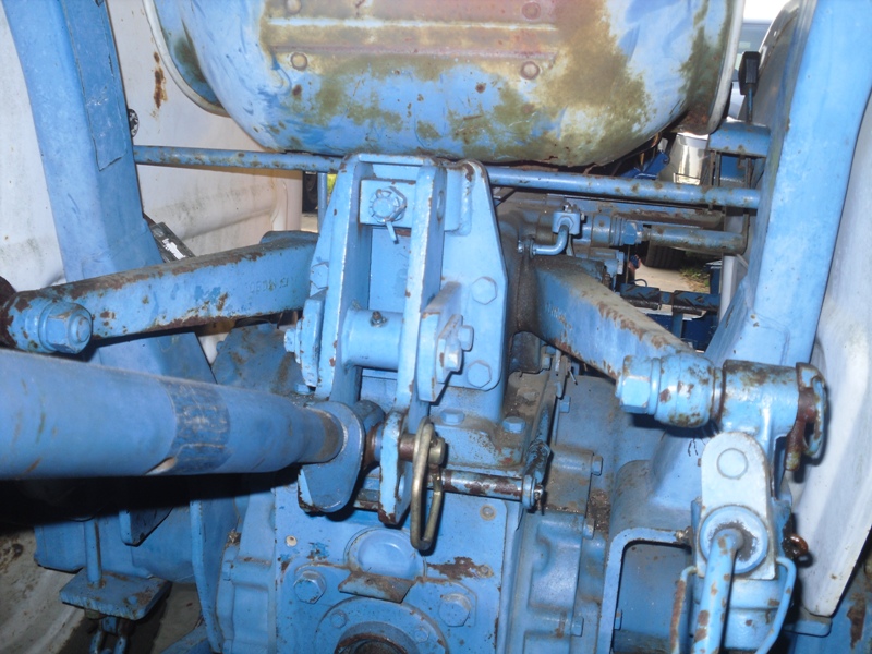

#60
No remote hyd connections on it.... i read some of the posts after a search of draft control. So basically this lever is used to set the lowest height that i want it to lower down to? So when im running the hog i should set it and then just use the main lever to raise it if i run over something big like a log or so? JC i took some pics of where it connects, sorry it doesnt show much.
