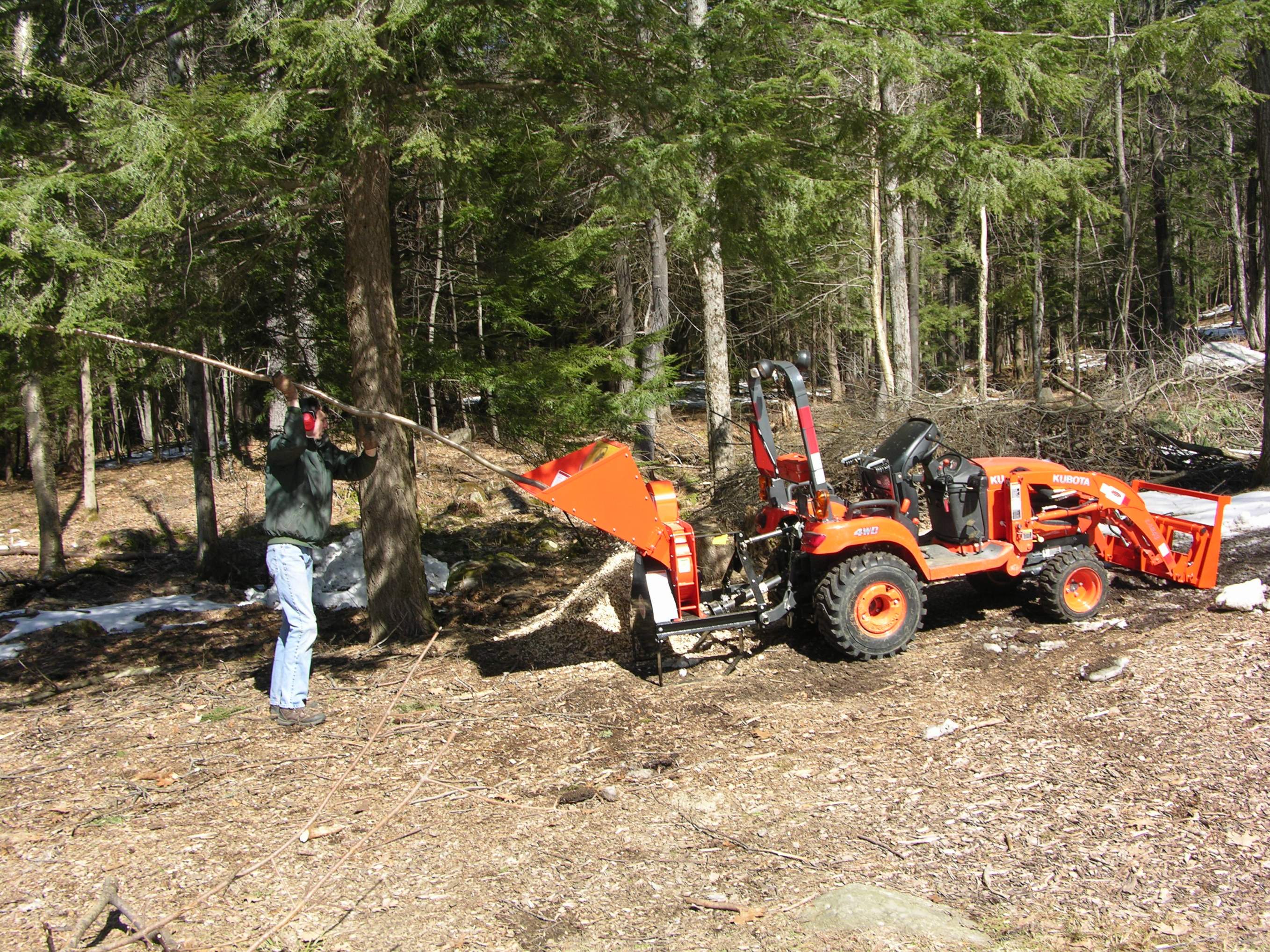

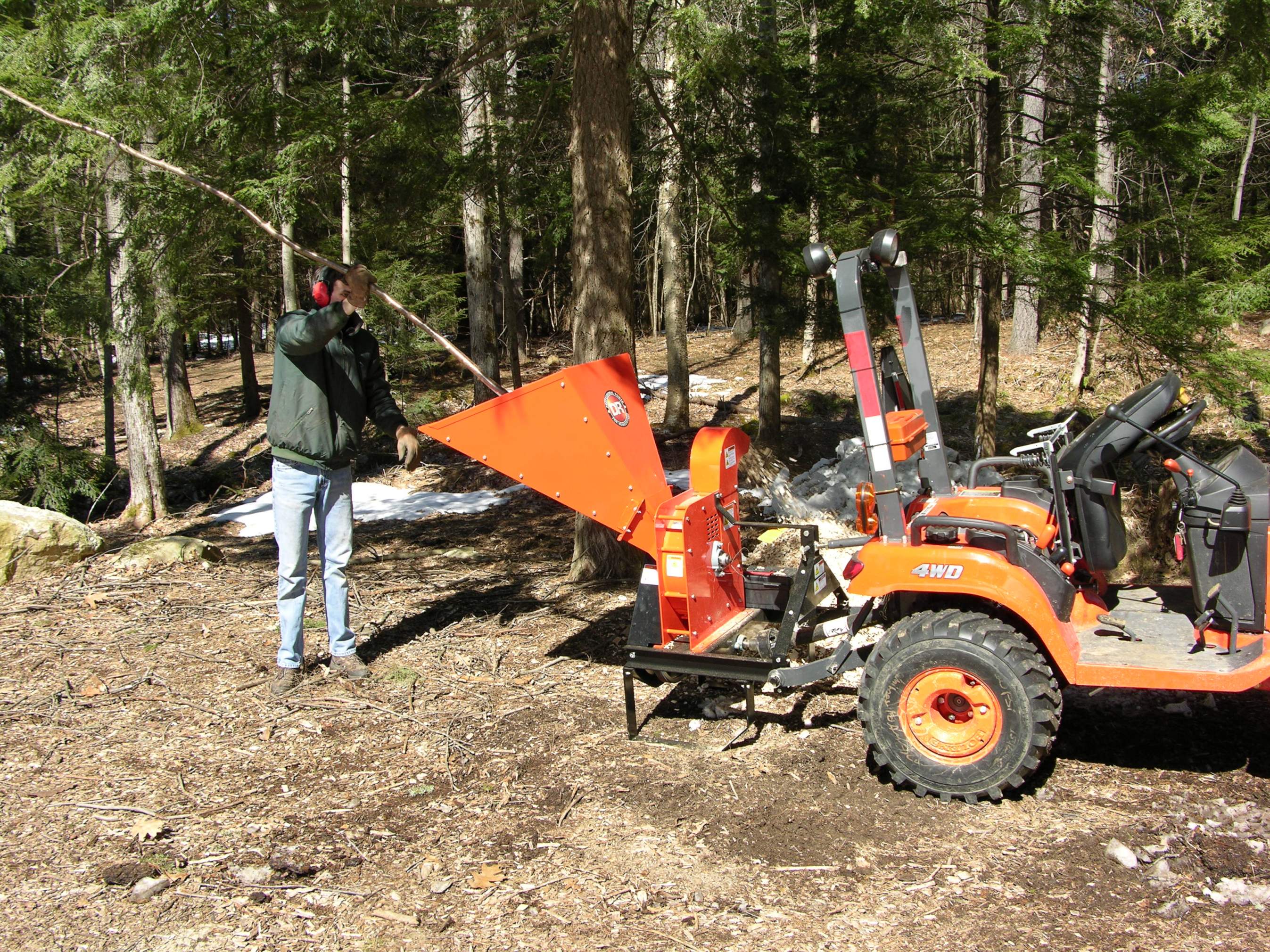

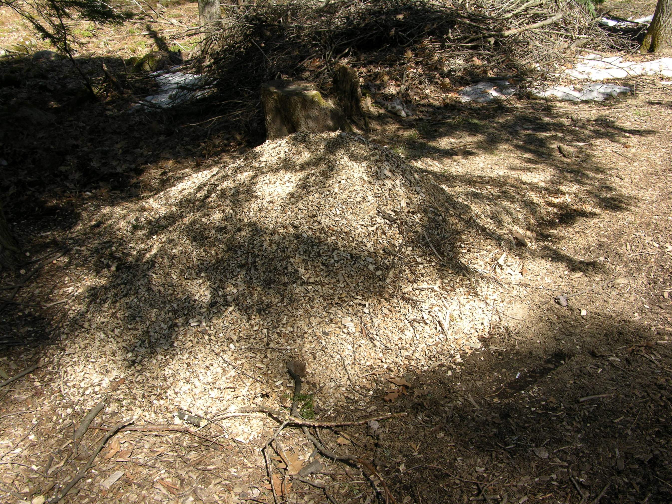

I got to play, excuse me, work with the DR chipper yesterday. Very please with its performance. put a varity of material through it. the thickes being 4 inches. handle it with no problems.my bx 2360 as well. had the rpm's set at 3000. no noticeable slow down of tractor or chipper handling the large piece or multiply pieces going through. No its not a chipper that can handle and 8, 10, 12 inch log with auto feeders on it. it will do what I want it to do.
Here is the pile of chips created in about an hour, first picture

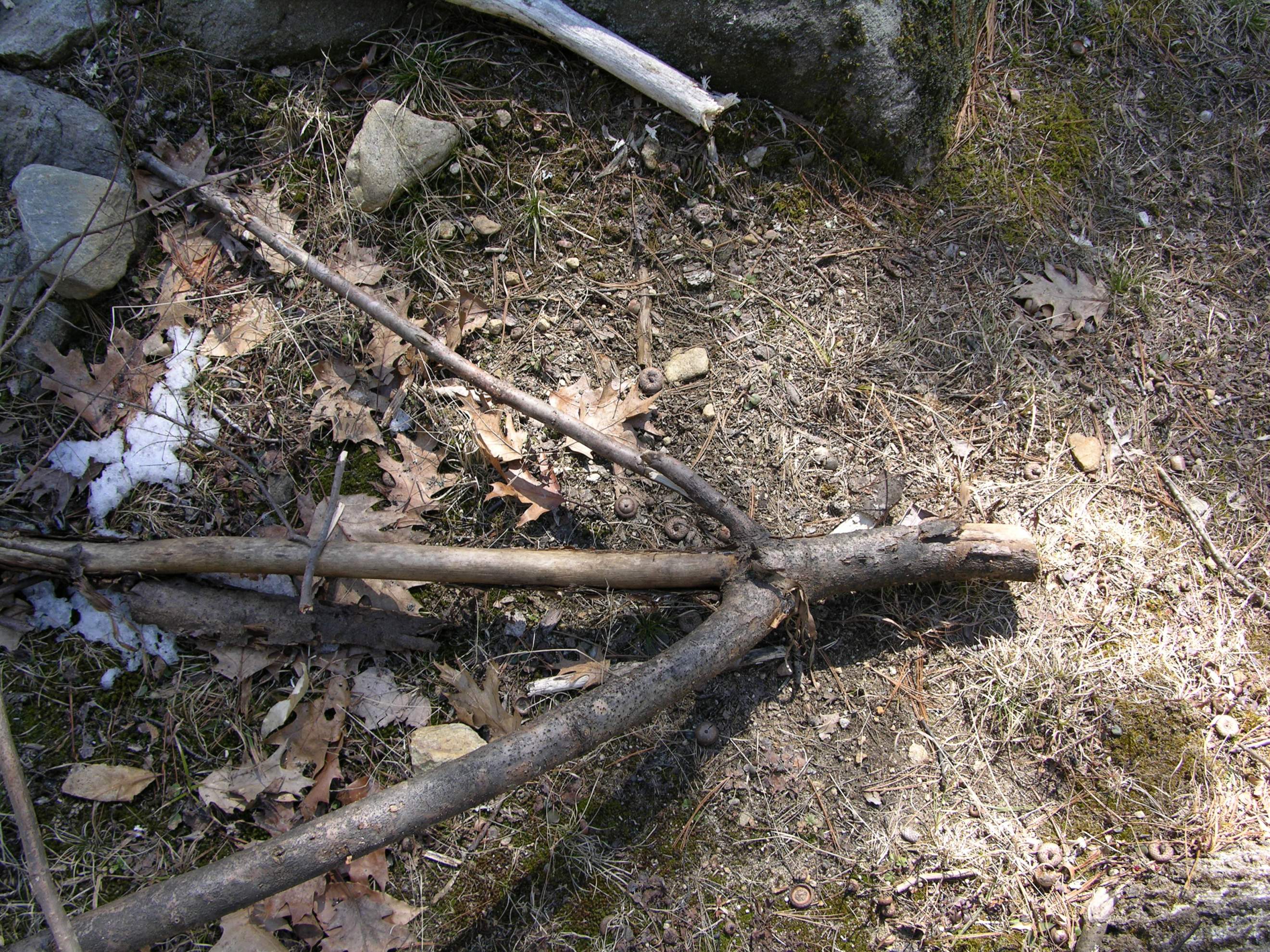

What it won't do is allow branches with a large Y in them that won't bend or break easily. so I just have to cut things like that up, picture of an example.
The last three pictures are of my son feeding a 25 foot piece of birch, starting at over 2 inches. we cut down early last fall. I was taking pictures as fast as the camera would allow. so it will give you some sense, of how fast it processed the material

   / New tool arrives #15
it will do what I want it to do...
That's about all that matters, isn't it?
None of the chippers will take those "Y" shaped branches unless the offshoots are really springy.
   / New tool arrives #16
When we have a Y, I just cut off the long pieces and then burn the Y's them...
