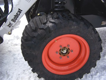

I have a new 2010 Toolcat that has had two tire tread separations.
The first occurred after just one month of use. I noticed a bump in the ride and stepped out to see a monster bubble on the left front tire. The local Bobcat dealer was hesitant to take the tire and try to run a warranty. I purchased a new tire and was eventually reimbursed a month later.
After thirteen months of use, the same happened to the right front tire. The local Bobcat dealer said, sorry you are out of the warranty period.
Both tires were essentially new with no observable wear on the tread.
They are Carlisle 27 x 10.50 x 15 Trac Chief tires.
I am I the only one who has had this happen?
I have a 2006 Toolcat with the same tires and never had a problem with the same tires on it.

Have not had this happen on tractor tires , im running titan r 4's , but had a lot of carlisle load range D trailer tires do this . All in a 3 to 14 month period , from purchase. Some were replaced by dealer , then I asked if he had another brand , and i've had Denmon? for the last 3 years problem free , hope it stays that way...

I had a Titan tire do this too, but it was from overinflation. Turns out my tire pressure gauge was reading about 30lbs low, so instead of 50psi I was running 80. Probably lucky I only had 1 failure. Oh, and this was a fairly expensive brand name gauge from the tool truck, not a cheapie one.
