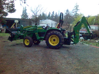

Replaced the 4300 with a new 4520.
Loved the 4300 with a few exceptions, just got a much larger place and needed more HP and more lift. Wife kept asking for projects that needed .* and she sold herself on us needing the larger tractor and new attachments:
448 backhoe, 4-in-1 bucket, pallet forks, self leveling loader, rear hydraulics. The rear hydraulics are neat! flip the switch and the joystick runs the cylinders on the big rankin rear blade. Most of the time to put on or remove the backhoe is the draft arms and links on the 3 point. The actual mount / dismount takes about two minutes.
