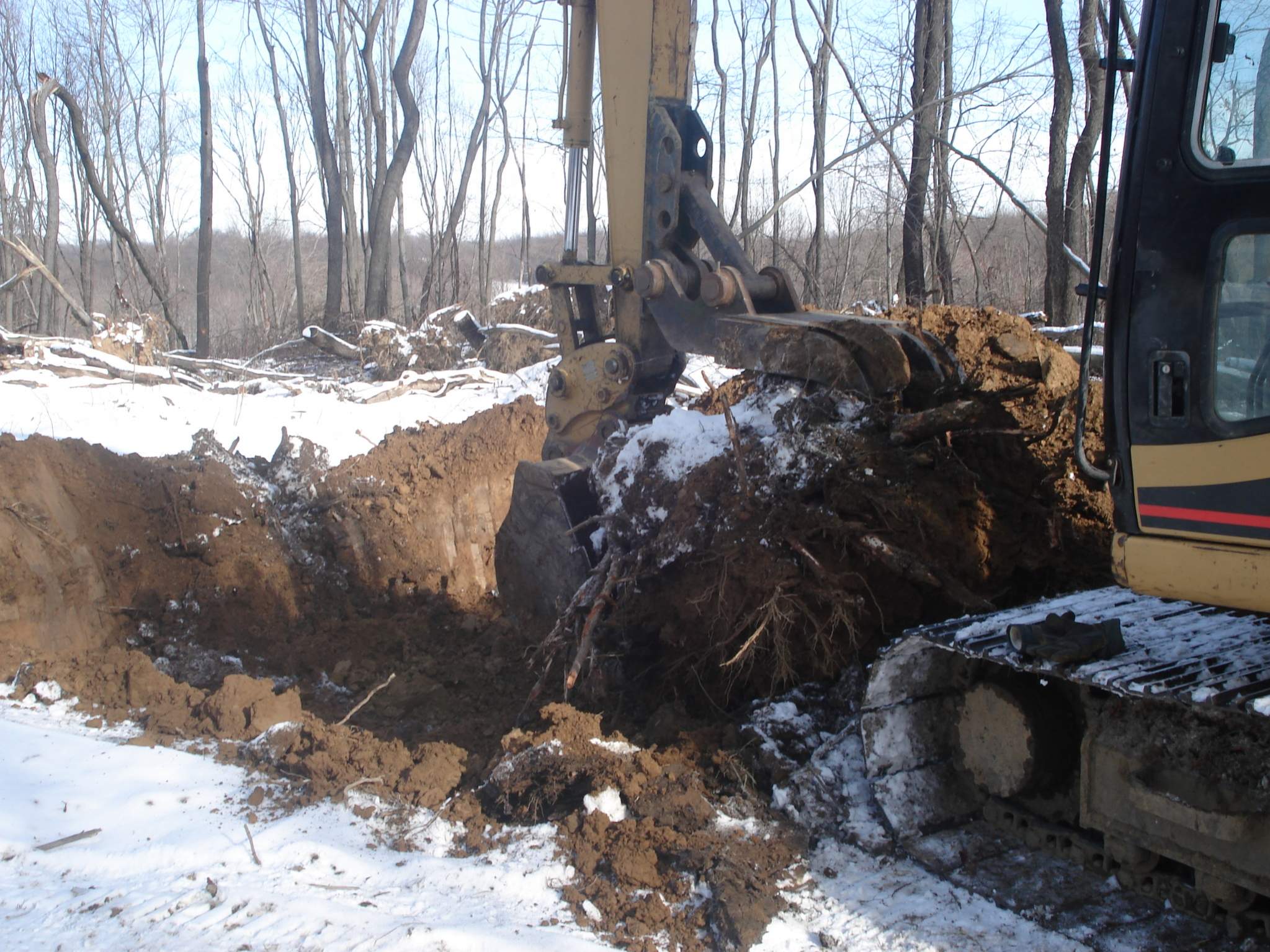

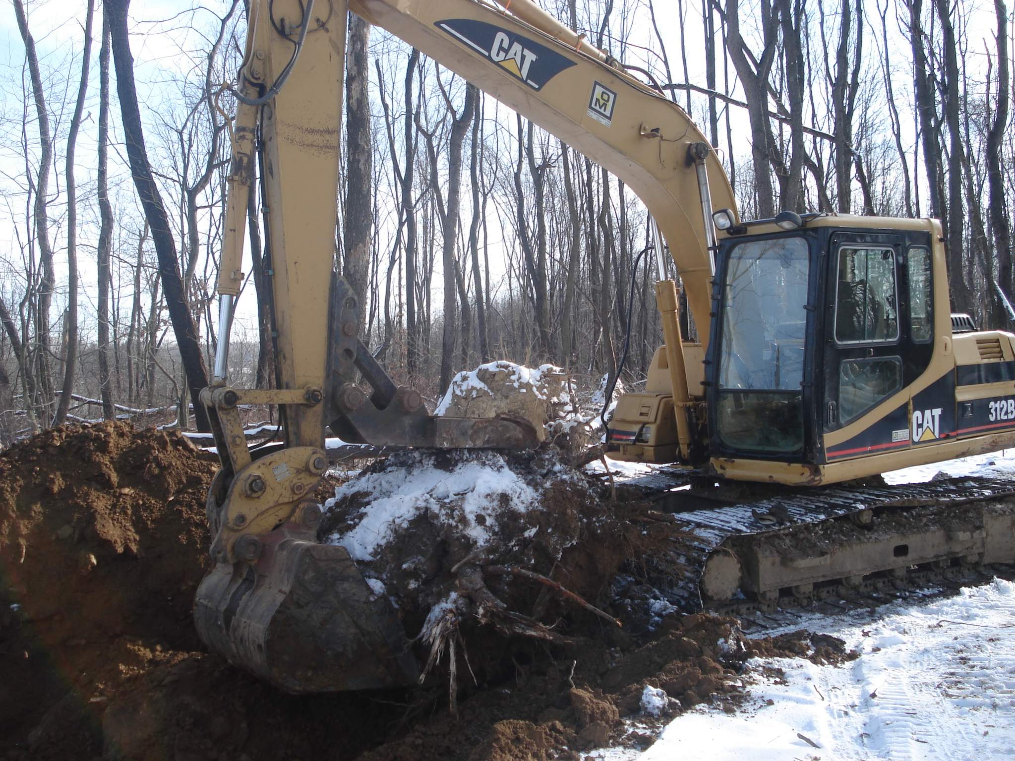

Man, what a great toy!! I spent around 10 hours pulling stumps over the last few days, definitely a great machine to have.
As Mike said, some stumps would pop right out, others I'd spend nearly .5 hour on em. Course they're frozen in, and I'm still on the upswing learning curve.....probably different species and root systems.
I was thinking it would be nice to have a larger machine to pop them with one scoop.....but then you'd lose all the seat/stick time??!! And as I said before, that size machine would be hard to get thru the woods.
I also "experimented" with knocking trees over.....man is it easier than the dozer!

On the stump issue; I will end up with several dozen stumps. My plan is to roll them down a steep incline located next to the homesite, hopefully knocking off most of the dirt. Once down on the flat, I can gather them together, and 1 of three options......burn em, bury em, or keep the pile of brush/stumps for game habitat. Or parhaps a combination of the three?? Any thoughts on these options would be welcome. I'm still debating.

Looks like your getting the hang of it pretty quick. That's a nice saw log in the pics. Are you separating those and keeping or selling? They're not worth a small fortune or anything close, but it is kind of a "green thing" and just a shame in general to outright waste them.
Right now, the guy that hauls pulp wood pays $15/ton. The amish guys will pay a little better but they're more selective on what they want and we have to haul to them. And the commercial firewood guys are running rampant too. I would really worry about letting any "home owner types" out to gather their own firewood. Too many lawsuit crazies out there.
IMO, If you have an out of the way spot, pile the stumps and leave to rot. They are not the easiest to burn. A stump pit always ends up being a PIA. When things dry out, I have a neighbor that needs an old stump pit removed. Whoever did the clearing for the horse pasture used part of it for stumps and logs. The horses have found 3 different spots thankfully without harming themselves.
