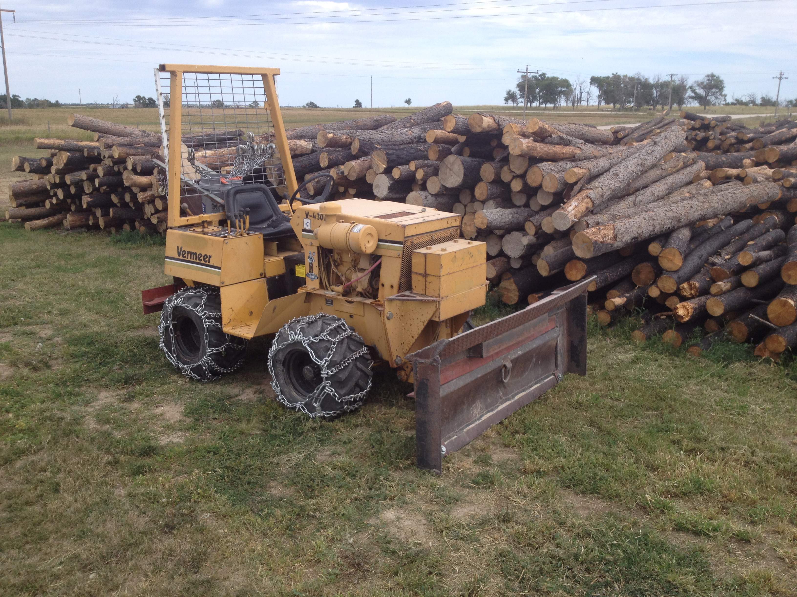

Well It's turned out to be pretty darn useful. I had the tires foamed. Added 130 pounds each tire but cost over $1,200.:eek: Then I bought the biggest chains I could find which cost another $600.:eek: That added over 150 pounds per tire and really gave the unit some stability on uneven ground and much better traction. And I will never have a flat.
I also added a piece to make the front blade bigger for pushing brush. It works great. Just put in in float and ram into the pile. I pushed some big logs that I know weighed over a ton with that blade as well. I also added a little back bumper and boom for the winch. I threw it together out of some scrap I had laying around. It's not pretty but it works.
The thing work great and it's' only issue is that it needs some more weight on back for when you back up a hill pulling something. It's working pretty good for what I need it to do. It's ran about 40 hours and burned around 15 gallons of diesel so that little Deutz is a fuel sipper. I am having a little issue with the fuel sloshing out the vent on the cap. I need to find a piece of sponge to put in the neck to keep if from sloshing around through the vent when working.
I changed all the fluids. It was noticeably quieter when I added the Delvac Synthetic to replace the old dirty likely dino oil. It has a slow oil leak from the rear pinion seal that will need to be addressed this winter. Other than that it's a dry machine.
