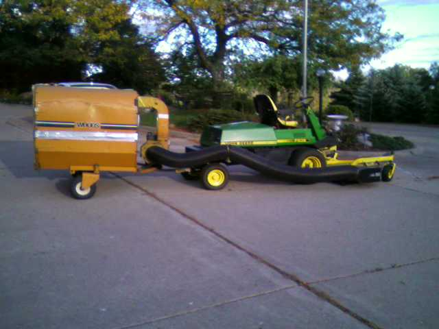

I have a Woods vac that runs along the same principle on a 72" front mounted deck. Mine originally came with a 6" hose which easily choked with any kind of grass + leaf volume. When the motor blew, I bought a Honda 6.5 hp motor which has a fixed throttle: max only. I made a new shroud for a 10" hose with corresponding 10" deck chute. Clear hose is $10/ft. Starts on the first pull even after sitting outside all winter. This thing will suck up a brick (and has) if given an opportunity.
If your compartment is too airtight, the blower fights too much back pressure. If the rpm is too low, insufficient pressure. Kinks in the hose reduce pressure. Mine will choke when a few sticks of just the right size get crossed up anywhere in the chute or fan throat. Once when unplugging it, it sucked a leather glove off my hand !
Best experience was cleaning up the side of the road where it must have picked up a lit cigarette. Neighbor came running out to show me that the unit was combusting all of the leaves, stick, pop cans & bottles, grass, and paper anything. Smoking like a russian tank after a Javelin strike. Burned the paint off. I still contemplate using this notion as a feature in the future !
