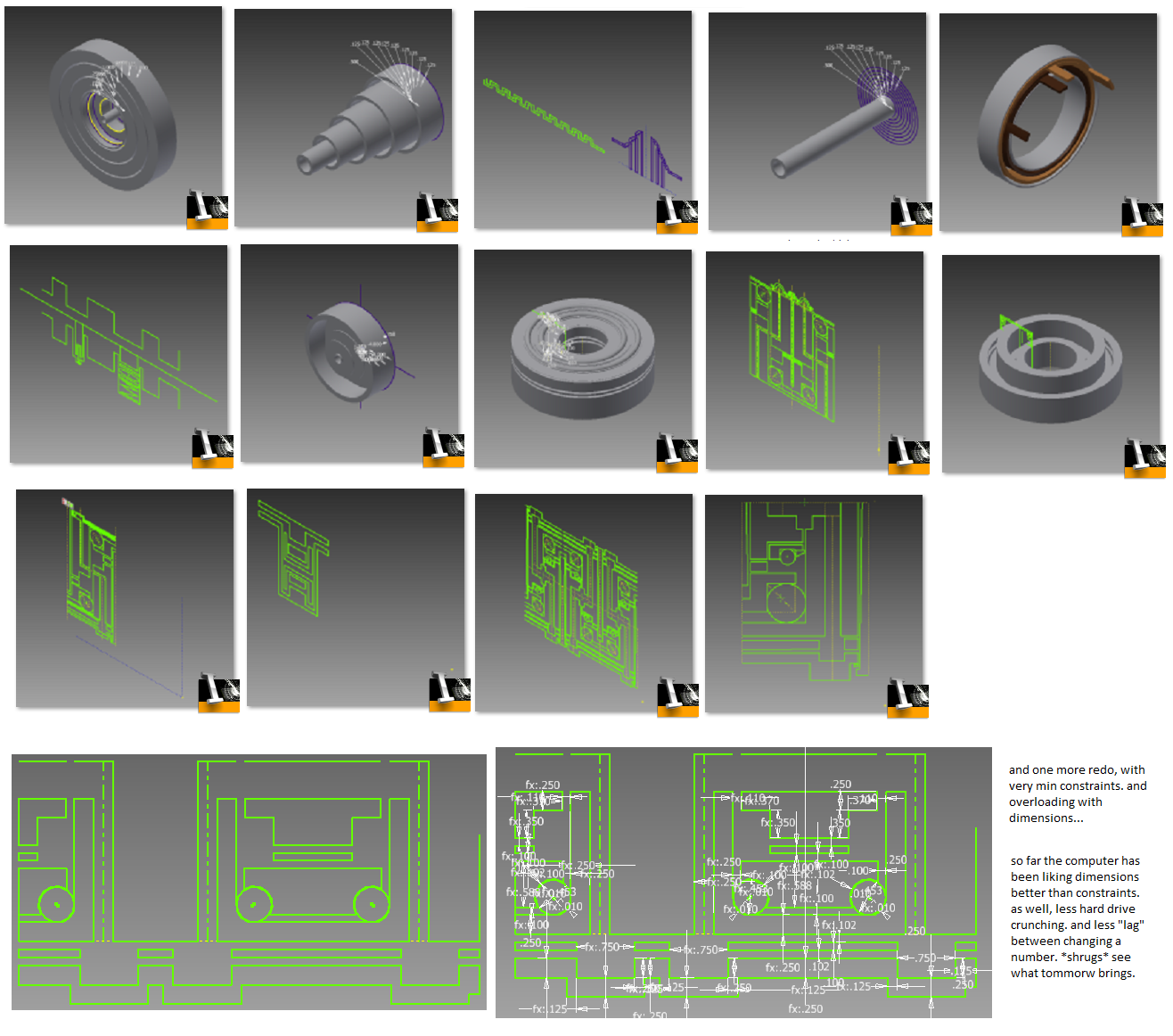

been battling with autodesk for last couple days. and not really much to show for it.
been trying to find the groove per say. of working through things and thinking a few steps ahead, in how to draw something up. and finding some things do and do not work so well. resulting in restarting from scratch a few times. the constraints of autodesk is the big one, and then dimensions linked to constraints. just makes things into garbage after so many edits.... do not pull a dimension off before changing another value and i end up with foo bar...
below is finally something that did not result in geometry not looking like a rag dog, after the puppies had it for a few minutes...
diagram created with autodesk inventor student edition.
dual transport wheels
---tire and rim lip (if you could even call it that, (quick and dirty))
---inner rim, with magnets on it. for an electrical motor. (have not figured out how to do elliptical or wavy "coils" of wire just yet) and hopefully some room for some brakes
---T shape support structure.
---axle though at moment showing as a single axle vs 2 half axles. not really sure how much room an electrical motor will take up. and it may come down to placing motor in one wheel, and brakes in the other wheel.

Looks like you are making good progress. Inventor and other solid modeling software has a big learning curve. Hang in there!

*shrugs* learning curve really not that bad, it is finding the limits, that gets a little frustrating. and in that thx for encouragement!

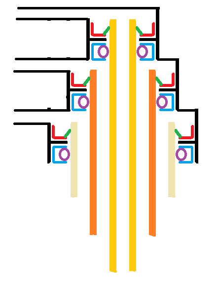

yesterday, backed away form inventor, to look up rotation seals, to deal with water/antifreeze (coolant) and air for (fail safe brakes) and getting inlet/outlet for fluid and then air through the 360 joint for transport wheels.
----the shaft or make that pipes going through the 360 joint, will not be rotating at any sort of RPM (revolutions per minute) but rather short degrees of 0 to 360 degrees. and rarely making a full rotation. that alone puts limits of what seals can be used. with many seal types relying on some RPM to create an actual seal.
----PSI (pressure) both for air, and coolant. is another issue, not just regular pressure during normal operation, but also when coolant over heats and boils over. and max relief valve setting for compressed air.
----temperature for coolant fluid.
----diameter of seals, and needing...
--------electrical wiring, and/or frame
--------1 to hold back fluid
--------(coolant)
--------1 to hold back fluid on both sides of the seal
--------(coolant)
--------1 to hold back fluid on one side, compressed air on other side of seal
--------(fail safe for breaks)
--------1 to hold back compressed air
----with above, then being limited to "height" or length. either above or below the 360 joint.
---other issue, is some seals are made for single direction rotation (clockwise or counter clockwise rotation) and not bi-directional rotation.
other issue, with coolant, is controlling how much GPM of coolant goes were. with hyd oil, and hyd motors, there was valves already in place. to control amount of fluid and were it went. but with water/antifreeze mix like coolant. there is nothing there. by default, or less i wanted to make a mile long path for coolant to circulate through. or place some sort of small size pumps or valving to help control how much coolant goes were. if nothing extra was put in, the result would be the path of least resistance would happen. and all coolant would go through path of least resistance, causing everything else to over heat. and tossing a bigger pump on and calling it good enough. does not cut it either.
other words, complexity of hyd motors vs electrical motors. electrical motors just got more complex, and needing a control system just to deal with coolant.
how the control system is put into place may have a very distinct advantage or dis-advantage. to min / max pressure and the 360 joint, and in that the seals.

below quick and dirty. of reducing seals / bearings down to 3 to deal with coolant and compressed air.

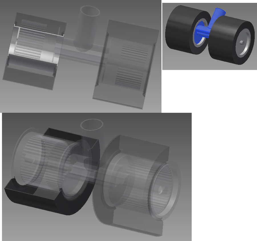

the 360 joint has taken a life of its own....
after getting fed up with constraints. i backed down, to just using parallel and perpendicular restraints. and using variable names, as dimensions are entered. slow going, but so far AWE! *looks relieved* less head aches...
was not really liking how far the last diagram in post 206, was poking up into the air. above the 360 joint. little bit different design. with 6 channels of bearings, and 6 seals. but looking much better and possibly a little bit more compact. still working on the new design with 2 Fluids (1 inlet / 1 outlet) and 1 compressed air.
various random diagrams. as i attempt to learn autodesk, and get something done for the 360 joint.
