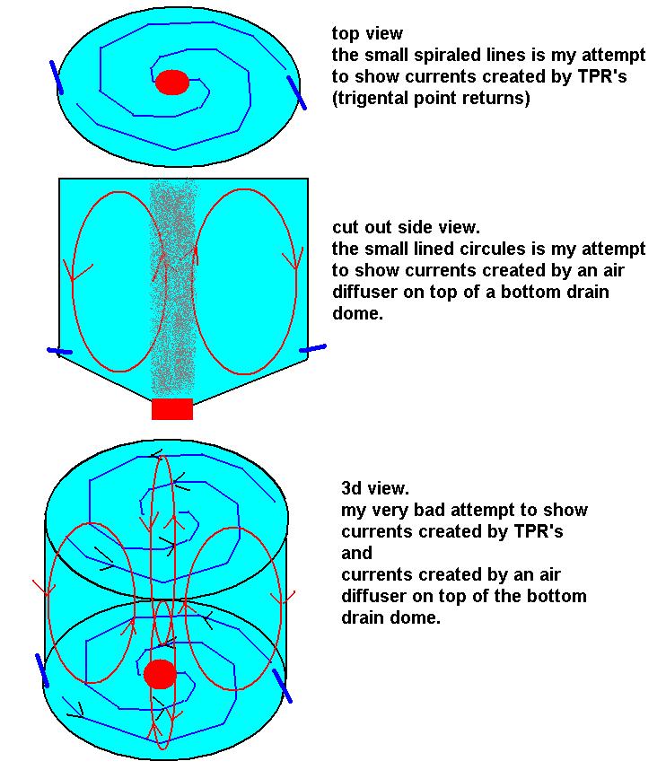

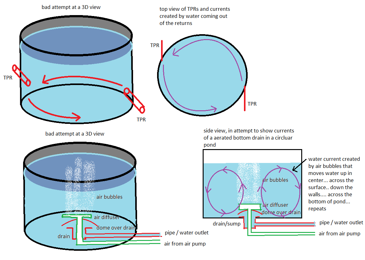

over on www.koiphen.com i learned about self cleaning liner ponds that have bottom drain with air diffuser or a "return" coming up through the center of it and TPRs (tangential point returns).
the TPRs, create a whirl pool or vortex action in a round pond.
the bottom drain sucks stuff down into it, while the air diffuser or return coming up through center of it creates an upward flow of current creating a "donuts shape current" were water current rises up in the center, goes across the surface of the pond, and then down the walls of the pond, across the bottom of the pond and then into the drain.
in sense a hurricane or tornado effect is created within the pond which primary purpose is to move sufrace muck (leaves, and like to skimmers at edge of pond) and thin bring fish poo towards the centrally located bottom drain. and in idea create a self cleaning pond.

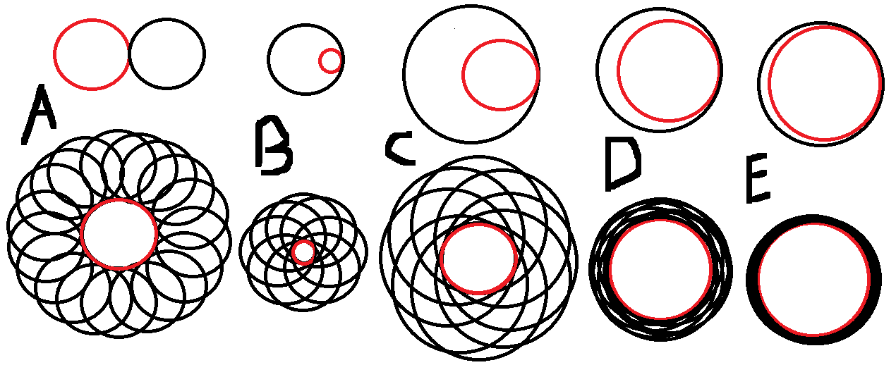

A = taking a paper towel roll card board center, and wrapping wire around it to form a nice tight coil of wire that fits side by side. then pulling the coil off the paper towel center, and slightly bending each turn to form kinda like a overlapping circular stair case.
B,C,D,E = all the same thing. unlike A were outside edge of the wire touches the inner circle. the inside edge of the circle touches the circle.
these 2D sketches might resemble a rodin coil. rodin coil = donut / toriod shape, with wire wrapped around and through center many many times. i am more looking for effect of a "circular stair case effect"
when i make shift them with paper towel roll center, i get what resembles threads on a bolt on the outside, and then female threads of a nut on the inside. these threads that are made from winding up the wire into B through E diagrams. is what i am wanting. BUT looking at B,C,D diagrams you can see the "gaps" that need to be dealt with. these gaps = no good.
the goal of(B,C,D,E) is to re create the spiraling vortex current that also has a donuts shape current going on as well...errr how do i say, the piston of the linear generator, would be the air bubbles, and instead of the water, it would be the coiling of the wires. to hold the magnetic / electrical current. E is only the first layer of inner coiling of wires. that would go directly against the outside of the cylinder that the piston would move in.
