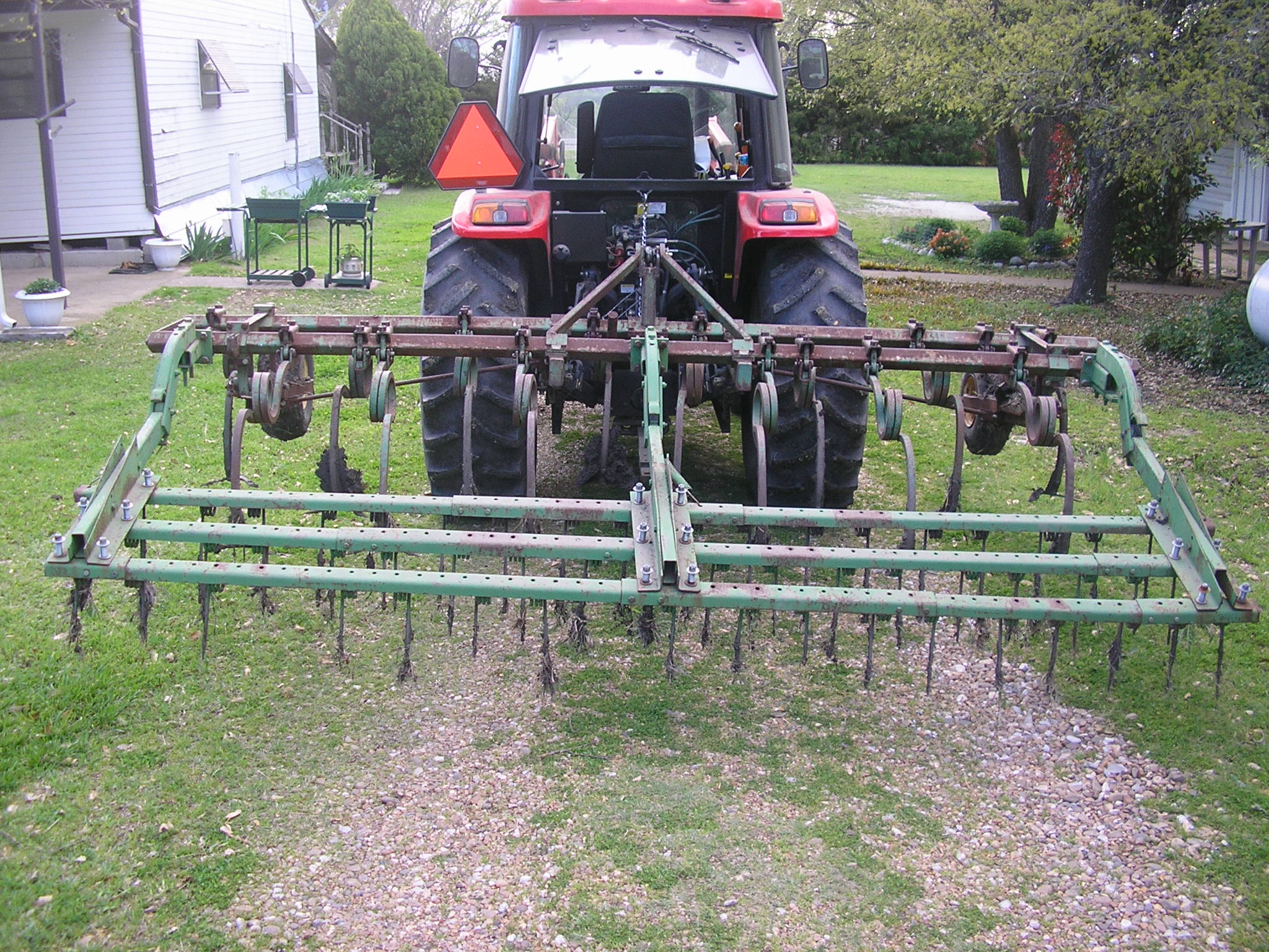

The only time the 6530 was "technically challenged" was when I hooked this JD cultivator to it, which is left over from the days when I used it behind my 100 hp JD 4230, and initially failed to set my "draft" control and 3 pt. 3rd member length (setting the 10"sweeps pitch) correctly.
