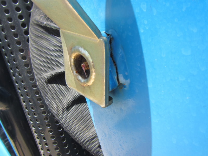

Since then I've gone to play with the new toy, I mean tractor, when I have time after work. Starting it up, learning to work the controls, checking to make everything works. I've got some basics down but will need a lot more time in the seat to get comfortable with it. So far everything works, the AC blows cold and even played with the backhoe. It looks like it has hardly been used. The tractor has 575 hours on it so decided to go ahead and do the 600 maintenance work while still in the driveway. That's still a work in progress. I did find one problem on it while I was going around greasing all of the zerks this weekend. On the right hand side where the latch pin connects the front end loader (FEL) to the tractor I found what looks like a spacer the pin goes through the weld to the FEL arm has cracked. I'll try to post a photo, I think this is just a spacer since it is just welded on 2 edges and not all the way around so I don't think it is structural. But if it is just a spacer then why did it crack? Perhaps not aligned right? The one on the inside of the FEL arm on this same pin is cracking too. If anyone else has seen this problem I'd love to hear your thoughts. I doubt the seller even knew about this problem since I didn't notice it until I was greasing. Soon I hope to remove the FEL and weld this back on. Any suggestions on removing the FEL? I've read the manual but by God I know they have people in Korea who can speak and write English in a sensible manner, I've met some. This translation must have gone to the lowest bidder. I've looked at videos for other makes of tractors but haven't seen any for an LS.

Looks like a nice machine. The cracked weld looks like it has been like that for a while. Odd place to say the least. Not sure why it would crack to begin with or if it would compromise structural integrity.

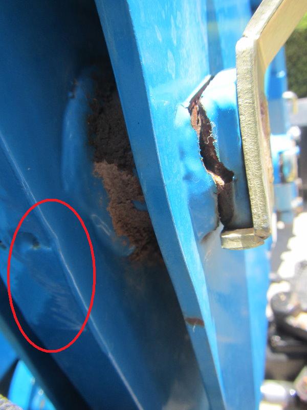

In your second loader pic it looks like the arm circled has a bend from something the previous owner did. Probably why the weld cracked. Just make sure the pin is straight and hole is lined up before welding the spacer back in place. The pin may be bent and need replacing after welding the spacer back on.

>>> In your second loader pic it looks like the arm circled has a bend from something the previous owner did. Probably why the weld cracked. Just make sure the pin is straight and hole is lined up before welding the spacer back in place. The pin may be bent and need replacing after welding the spacer back on. <<<
George2615,
I think you on to something, thanks for the advice. I'll look closer at that area. And a bent pin makes the most sense to crack the welds. If true it may be fun trying to get that pin out.

I've been looking at the photos you put up concerning the crack. I agree with George, the previous owner may have hit something that produced these cracks. What I don't understand is the failure at the welds? I'm wondering if the wrong type of weld wire or rod was used at the factory? The reason I say this is for two reasons 1) From looking at the weld failures, if I didn't know better, it looks like they used wire or rod for cast iron welding (the failed weld looks very porous for some reason?) 2) The weld itself shouldn't have failed! If anything, a welder using the correct setting should have produced maximum penetration to both pieces being welded. That said, the plate should have cracked or broken before the weld regardless if these welds were produced by Tig wire or Arc rod was used. When welding steel, the weld should be stronger than the material being welded to once it's finished.
I'd love to know what others with welding experience think? Almost there, If you have a professional welder make these repairs to your tractor, I would ask for their opinion. If for nothing else, to gain knowledge that may help you in the future. Plus, I like many would love to know as well.

My feeling is someone had one pin in on the loader and using the hydraulics moving the loader around to get the other pin in.
