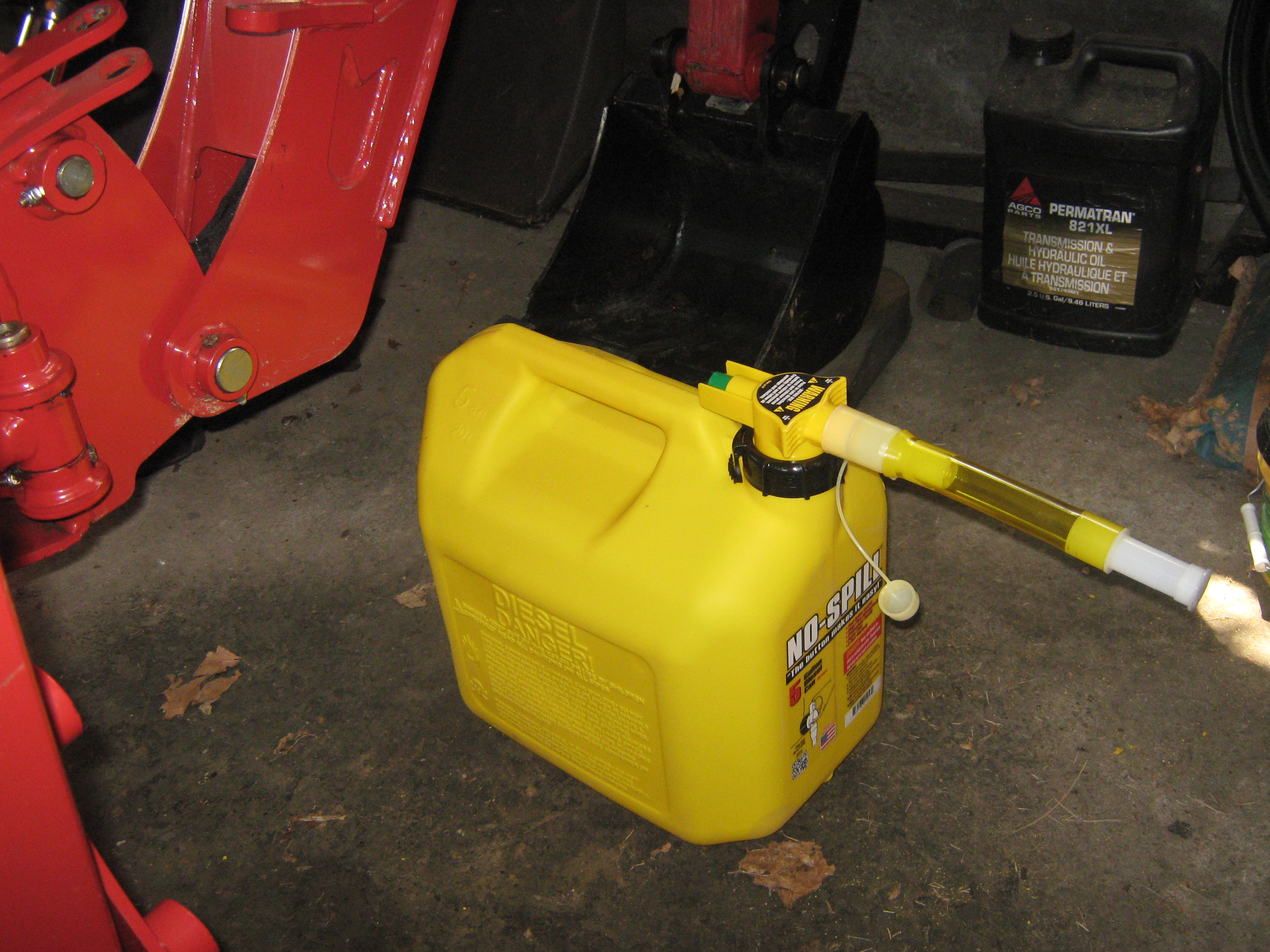

IMG_1310.JPGDon't even need a funnel with these, have a long spout with them.

Walmart in my area has Yellow diesel cans. I don't use the spout except as a lid. I have a big funnel with a screen filter on it.

Wish I would have learned about the no spill cans before I bought my last batch of cans. I would have liked to try them.
Walmart had the lowest price yellow diesel cans when I bought mine. I bought the high volume spout and vent kits from tractor supply and retrofitted all before I bothered trying to use them.
You are kidding about wanting to try those no spill cans right:thumbdown: They suck hands down. I agree with the yellow cans at Wally mart. I sure don't use the stupid pour spout though, way too slow. I use a funnel with a plastic paint strainer in it or my magic funnel if I want to wait for that slow thing .
All in all I can't see anything "good" about the new style cans. They cost too much and only hold 5 gallons. The best cans I ever saw were the Canadian 6 Imperial Gallon cans. Those puppys, a dying species are great and hold almost 7 gallons .
   / New Tractor owner in search of Diesel gas containers #30
Yeah, having a fill opening 3X larger than El Cheapos, a handle on the top and back, enough room to fill it with five gallons and have expansion space, a window to see fill level, and a vented, metering spout - all "sucks hands down."
I have an el Cheapo from Tractor Supply. If you sniff it you can smell China.
