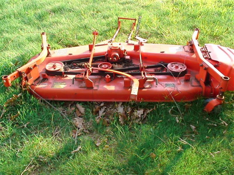

I may have just found one I'm hoping anyway. Can anyone tell me if a RC60-71 will fit? It calls for a RC60-72. I don't think there would be much difference between a b7100 and a b7200. The deck is brand new but sat out for a few years. I'll post a couple pictures.

I can't get the picture to load. How do you do that?

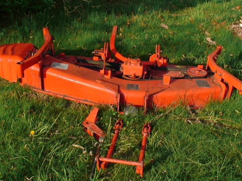

here's another

Thanks:p Does anyone know if this will fit my b7200 even with a little work.

the deck is supposed to be new but has sat out side for awhile. he is asking 1000. Does anyone kknow if I can make it work? thanks I'm supposed to let him know tonight.

I cannot say for sure if it will fit a B7200 but my B7100 tractor has a RC60-71B MMM. If you have a mid PTO you should be able to make it work.???
Best is to get in contact with a dealer who should be able to tell you. As I understand it there must be some type of compatibility between the mower and the loader.

I have the front pto with the drop box reversed splined. My tractor is gear driven not a hydrostat.
   / New tractor owner. Need some help. B7200 Mint #20
That would sound like you would have to reverse the gear box on the MMM and also need a longer drive shaft.
If you wish I could take some pictures of mine tomorrow.:D :D
