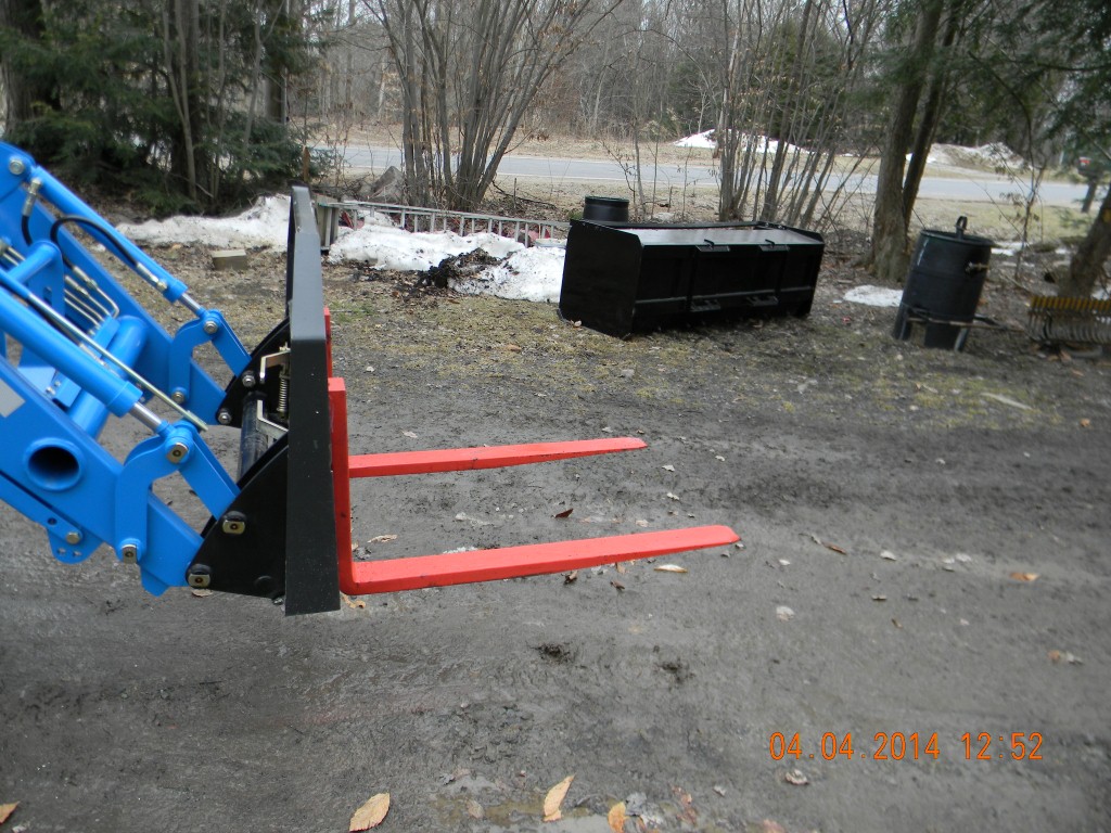

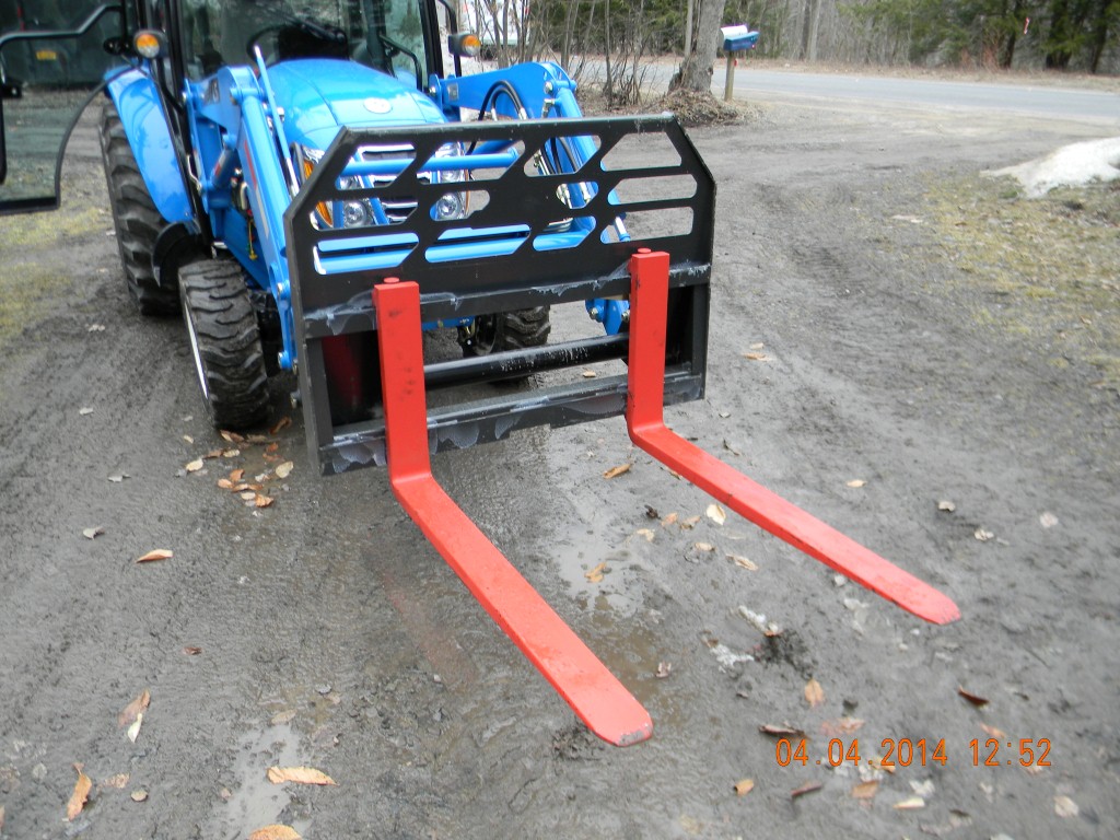

I just bought new QA forks and was going to buy from Titan. Many members recommended them due to the price. But I found a local source near me that sold me mine for the same price as Titan so I didn't need to wait. Mine are regular SS forks with a 5 or 6K rating. I forget which but I'll never max them out as my loader only does about half of that.
To the OP and any others reading most places that provide free shipping will do so if you have heavy items shipped to a business with a loading dock. I have heavy items shipped to where I work due to the dock we have. If you know someone with a dock ask them if you can have items shipped to their address for you to pick up. That way you can avoid a home delivery fee.
