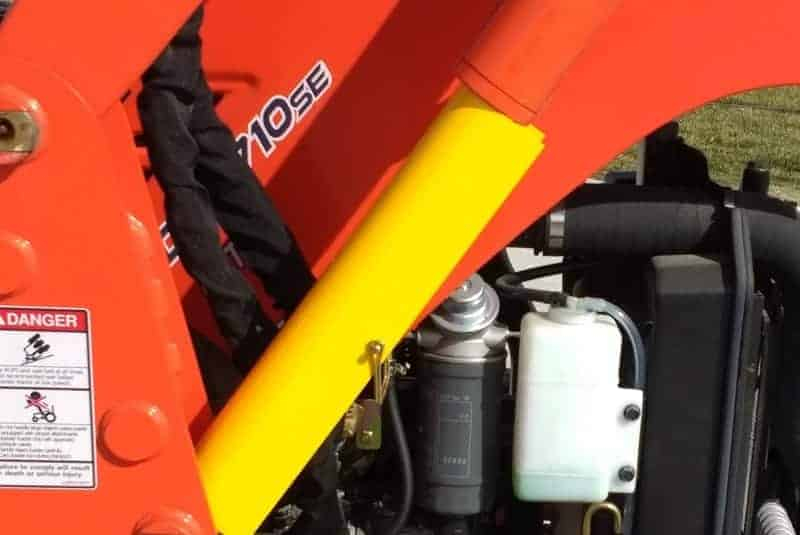

I have both I cant move it. I dragged it 4 feet with my truck and it left ruts in my driveway because I had the forks on the front in float. Id have to figure a way to raise them. The rotary cutter on the back I feel I could drop in place with a few good kicks but the forks IDK about.
   / New Tractor Problems #29
Put it in float and jack the loader up high enough to load on the trailer. Then cut a piece of angle iron the length to support the cylinder so it will stay when you lower the jack.
Something like this.
