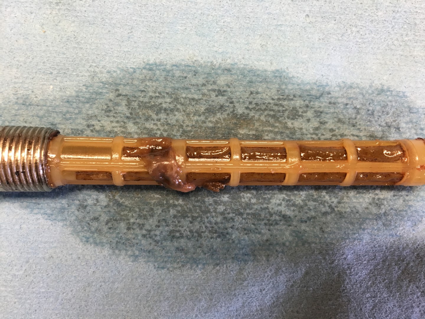

My 2015 5065E had a strainer attached to fuel hose fitting at tank, mine was stopped up with gel from "bio diesel", had same symptoms you described. I cleaned it twice then did away with it & replaced with inline filter I could see.Strainer After (Large).JPGStrainer Before 1 (Large).JPG
