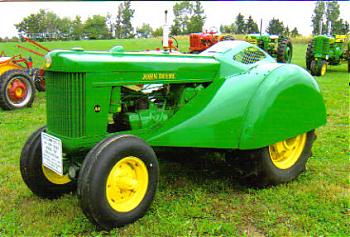

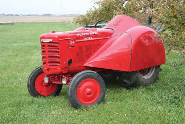

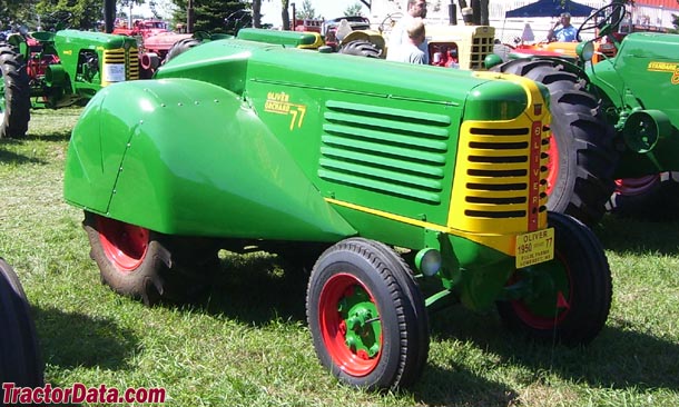

What other brands are available in Romiana?
Are there any Orchard models?
Orchard tractors from Google Images.
