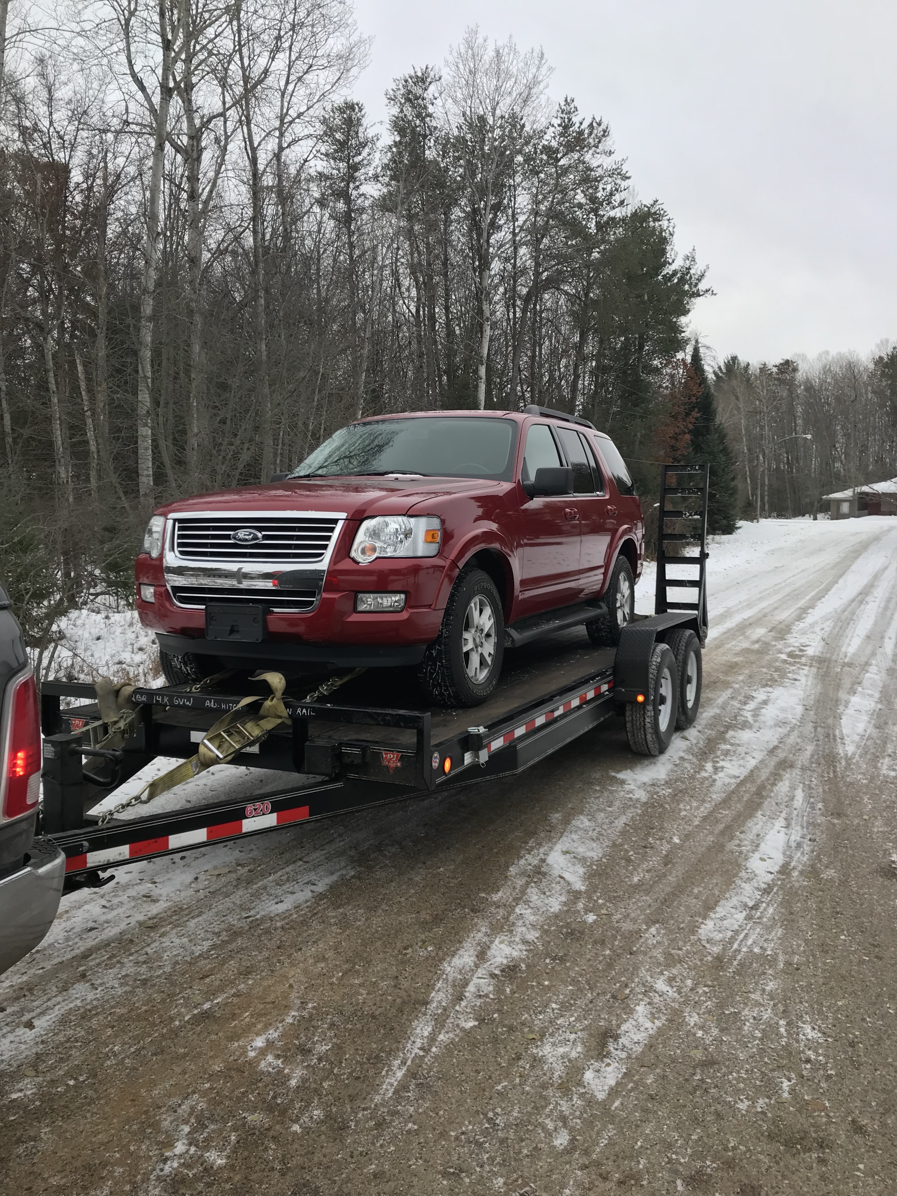

   / New trailer #6
I have a PJ 18 with tip up ramps... works great. It is a 12k trailer derated to 9980 lbs. because in California I would not be able to use with my regular license...
No harm in going longer... never know what might need transporting in the future.

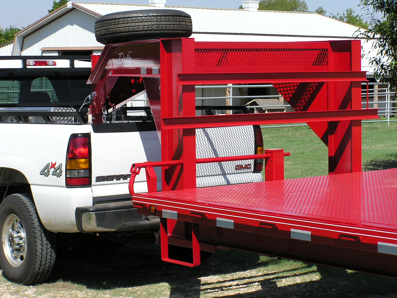

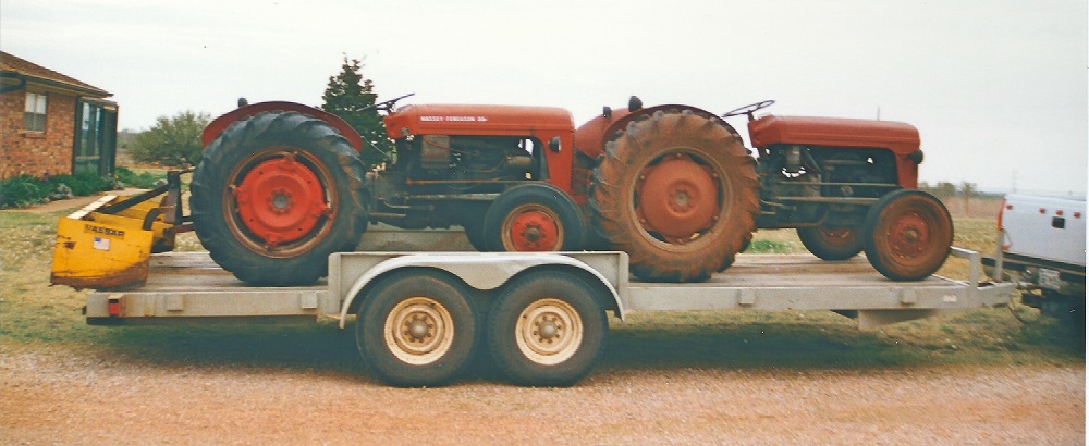

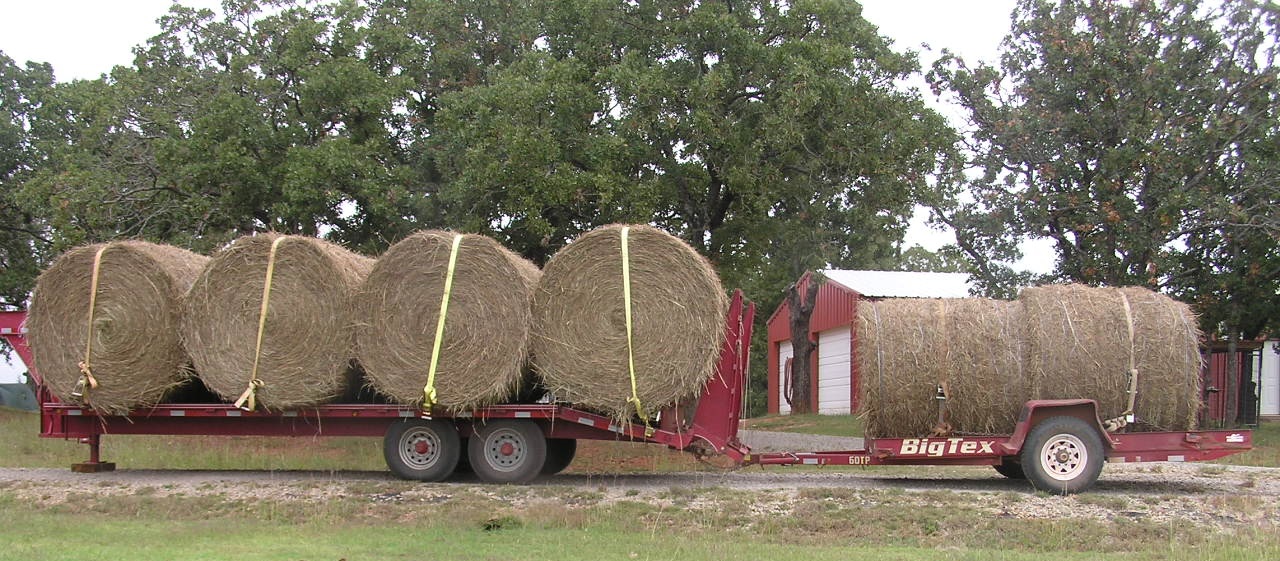

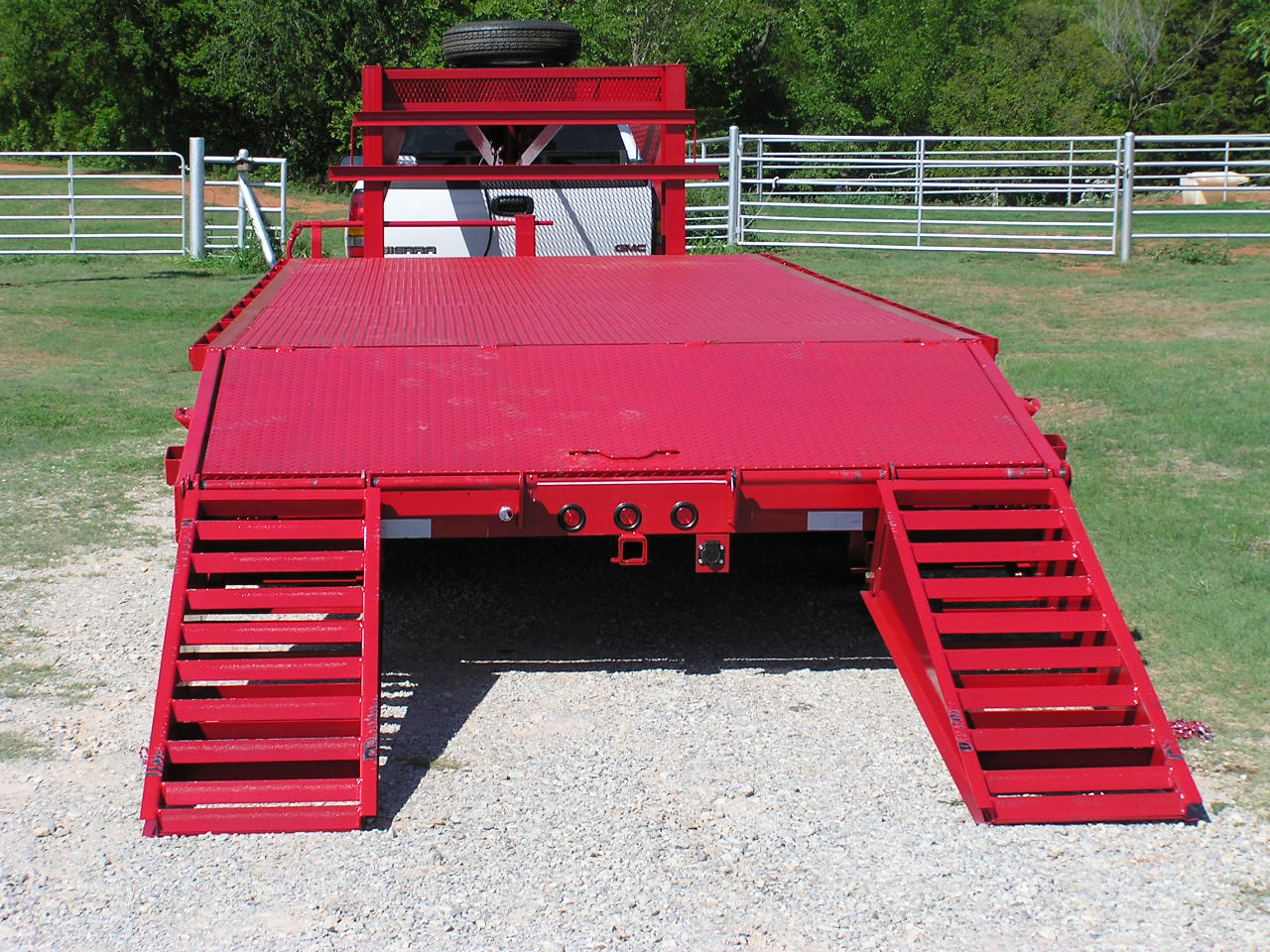

   / New trailer #7
Had a 20' bumper pull low deck:
Then my first gooseneck, picture from 2002:

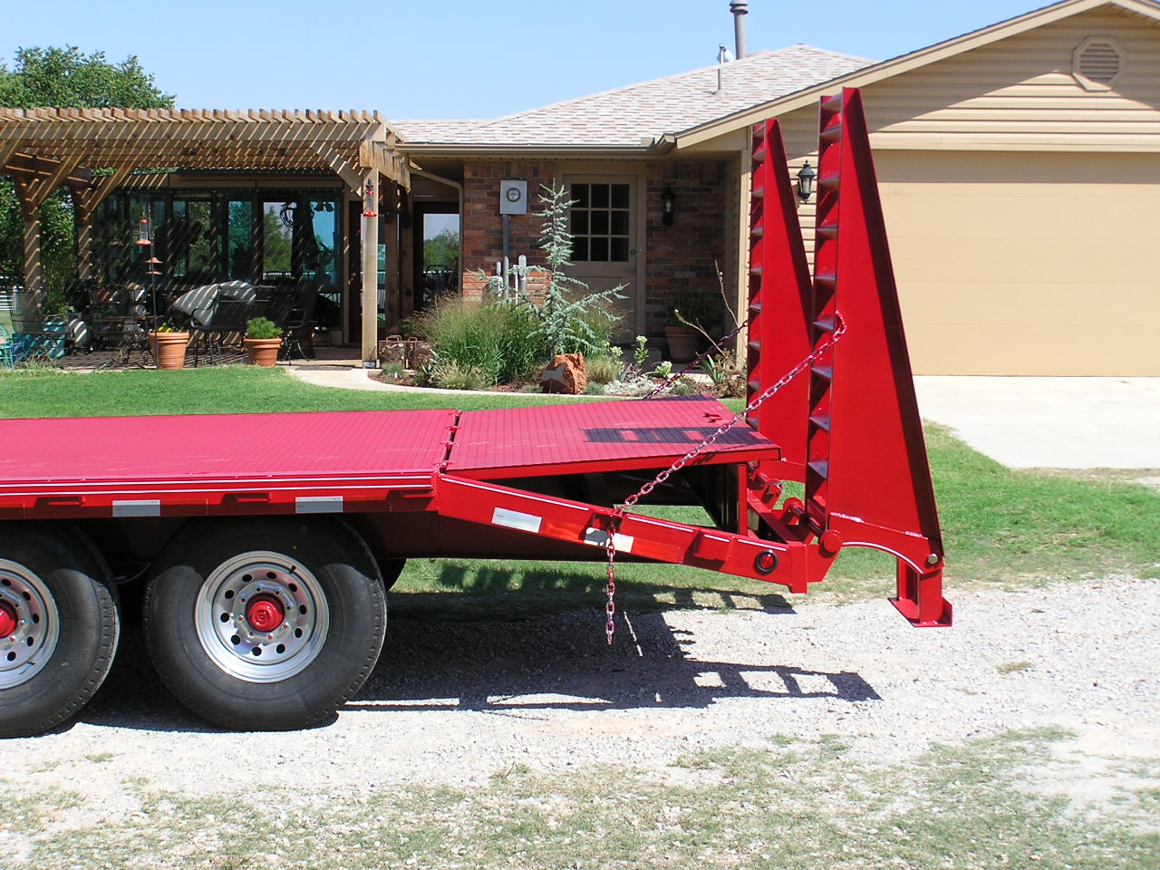

Bought a Gooseneck 18+4 deckover with a pop up dovetail 9-6-2006:
Still have it 13 year later, no plans to ever go back to a bumper pull.
This picture from 2015 is the latest picture I found:

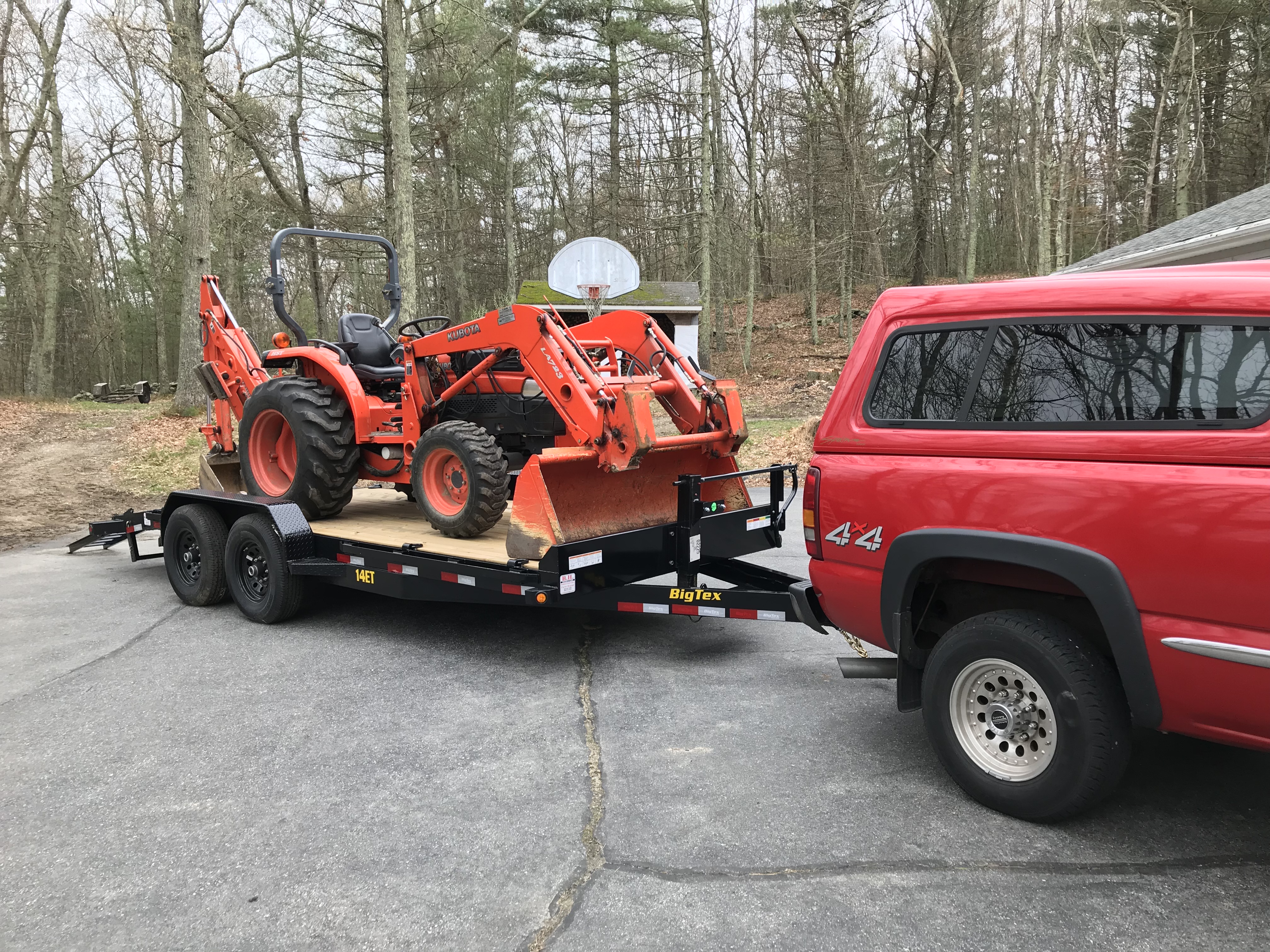

   / New trailer
#9
I tried to attach a picture?? The 18ft 14,000 lb derated to 9900lb Big Tex works great. Nice and solid transporting my tractor. No CT DMV hassle. They register it right at the store.
