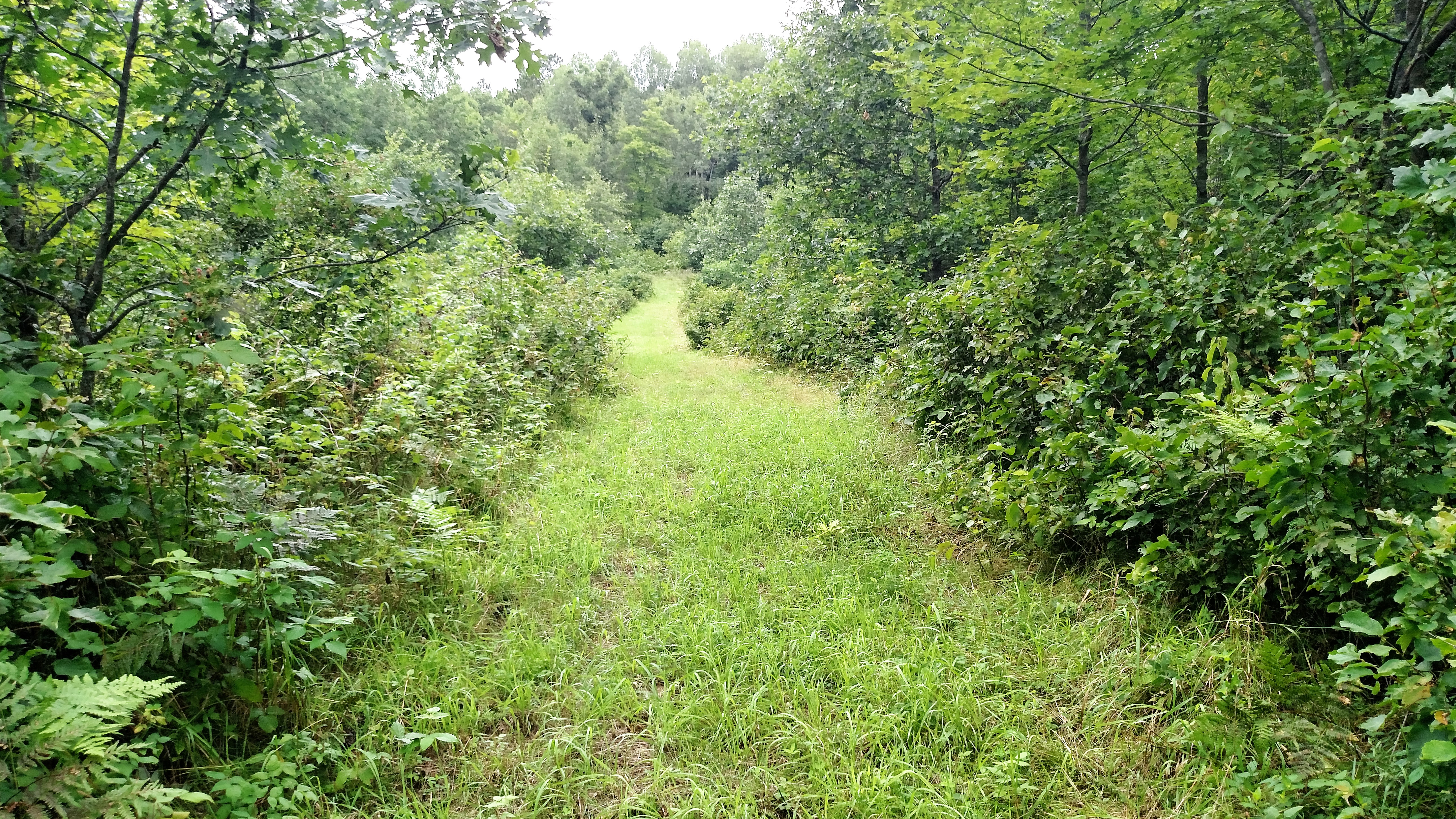

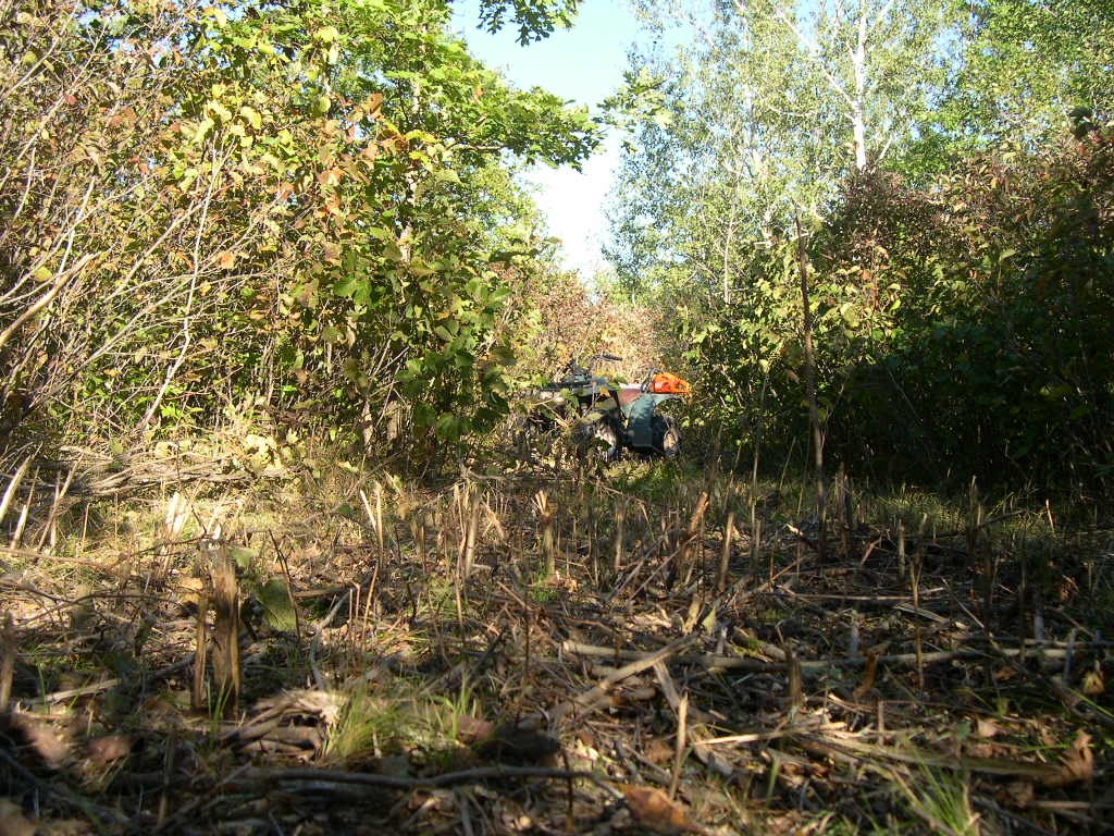

Mow it
Mow it again
Mow it again
(lather, rinse, repeat)
First Mowing
After subsequent mowings

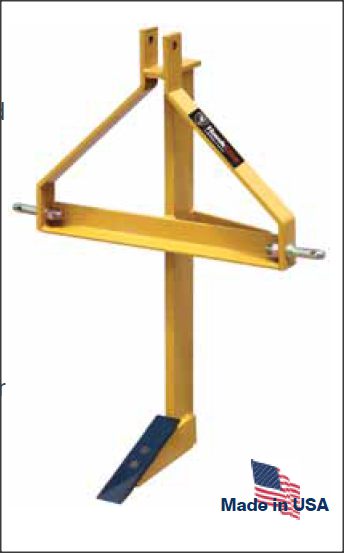

Not as fancy as a bobcat, but one of these low cost sub soiler/middle buster combos (and a 4x4 tractor) would be helpful to cut roots of some your larger stumps.
The more traction the better.
OP may even be able to get enough traction with his Ford 641 if using the 3-point arms for lifting up roots with this?
It's also a pretty good potato plow if you ever need one!
