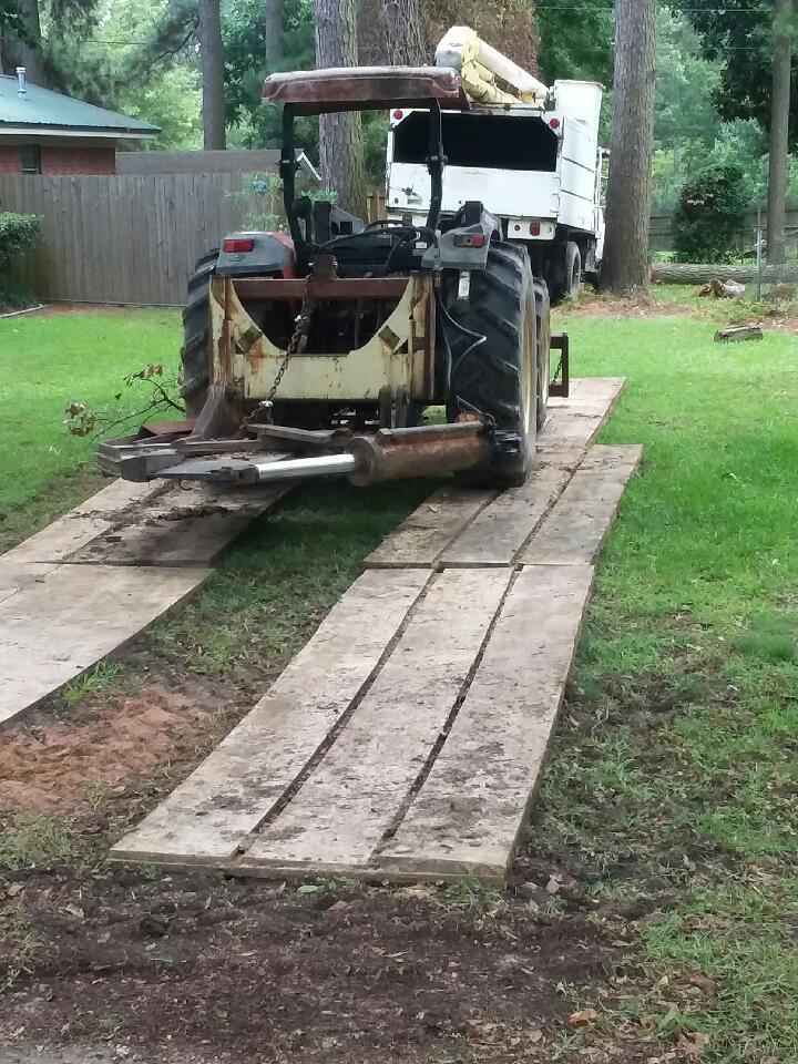

   / New Tree Shear slow closing. #14
This one's slow at 13 GPM.
