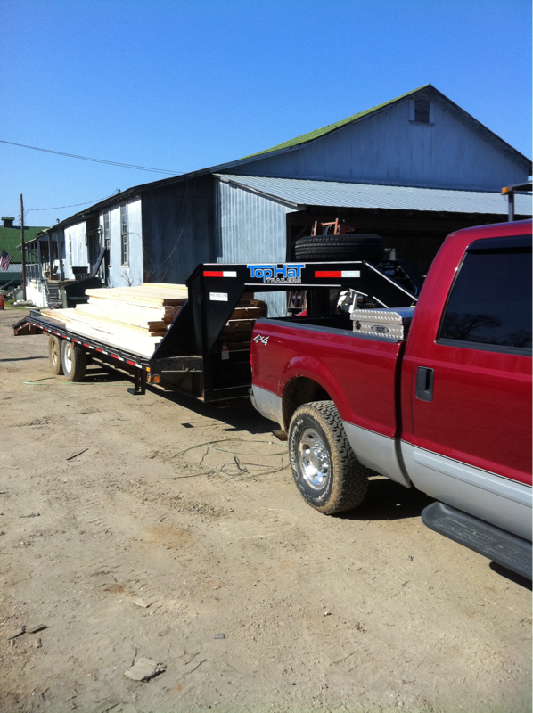

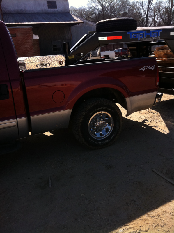

Finally some photos of new used truck I'll try to find more
