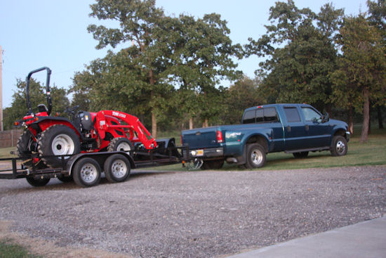

Thanks everyone for the words. I am having a great time with my TYM. It amazes me every time I put it to work. I am planning on getting a backhoe to clean out the creek bed, pond and trench a french drain...just for starters.
When we bought this house, it came with the Mitsu D2050 and these implements: box blade, grading blade, finish mower, rotory cutter, tiller and yard rake. All are 4', but they don't look too small behind the tractor. I have been spending some time getting these into shape...the rotory cutter took me almost a month to get the stump jumper off so that I could tighten the transmission back down to the deck. Working on the yard rake and tiller is my next step.
She's a little dusty from the work I've been doing, but I am attaching the photo of the homecoming...my wife asked if I was going to have a welcome home party :)
