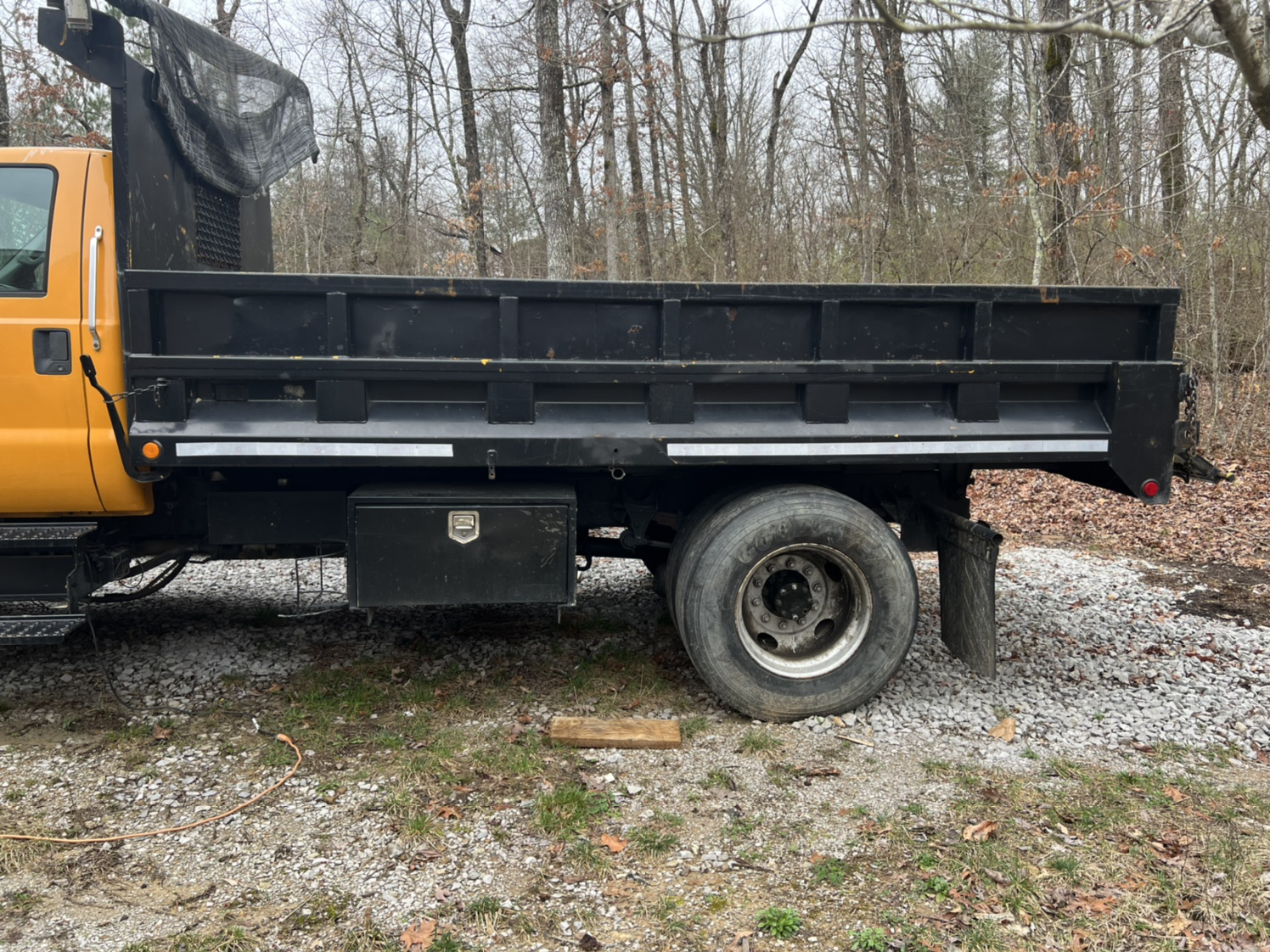

I have a 14ft bed on 12-6’ of frame. I don’t particularly like how much it sticks off. It makes it hard to pull a trailer and not cut into it. The axel center is 9ft from the cab. View attachment 785811
Are you sure thats only 18” of overhang? Looks like 2-3’ of overhang
It’s 2ft of overhang because the inside of the bed is 14’ which makes the outside a little more plus the couple inch gap between the cab.
   / New (used) IH 7500 Dump Truck purchase, modification & fix up
#137
OK that’s more like it.
I won’t have 2’ of overhang, probably more like 18”.
I just talked to a guy who runs a lot of state salt trucks and he said that should be fine for an 11’ body, but I think 12’ might not happen.
The 10” spacing from the cab and 18” off a 12’ frame means frame now has 10’-2” of usable frame. 11’ bed would have about 12” of overhang. 12’ bed would leave about 24” of overhang. I don’t know how much it’ll affect towing.
I don’t see many 11’ dump bodies for sale. 10’ much more common.

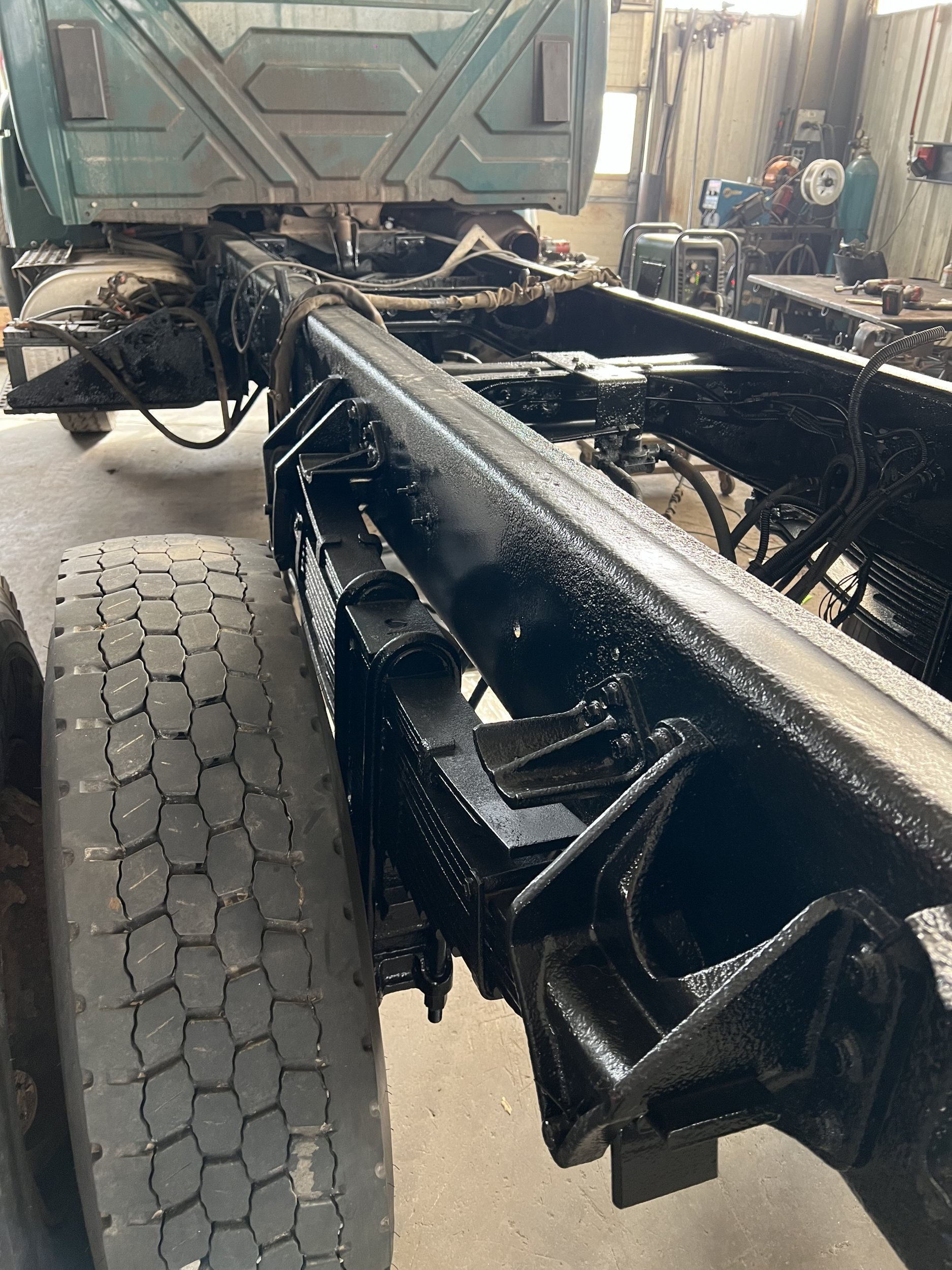

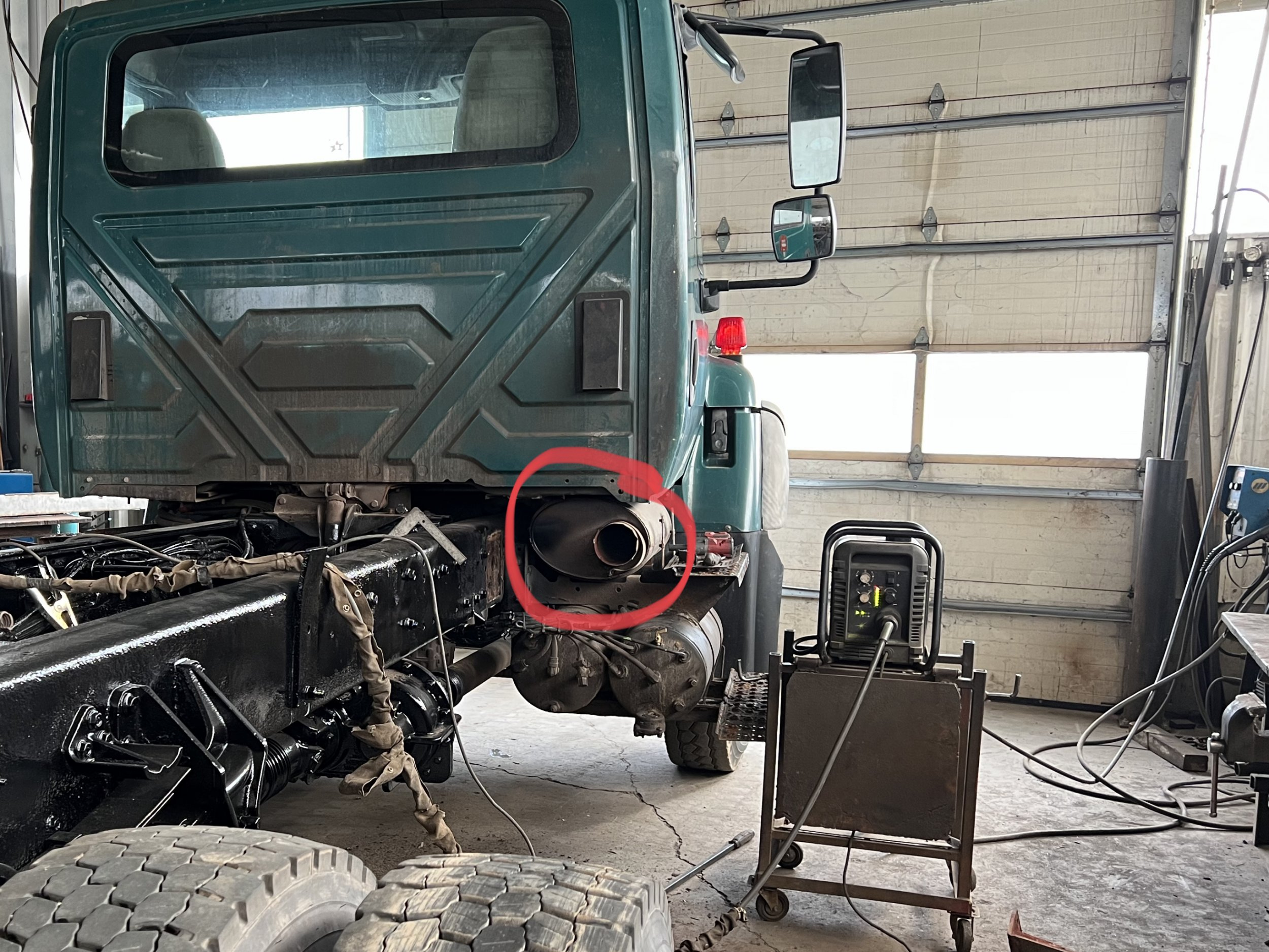

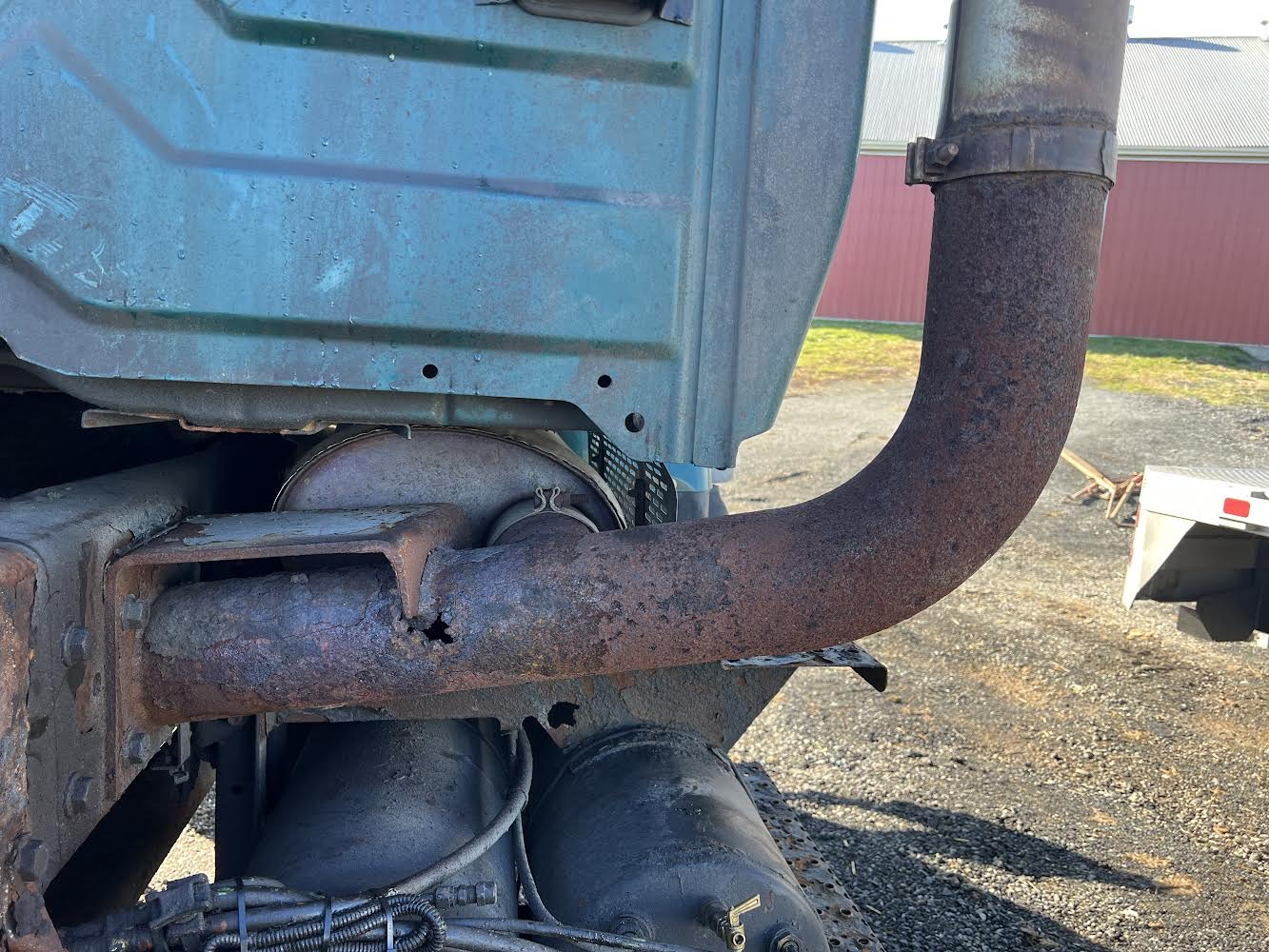

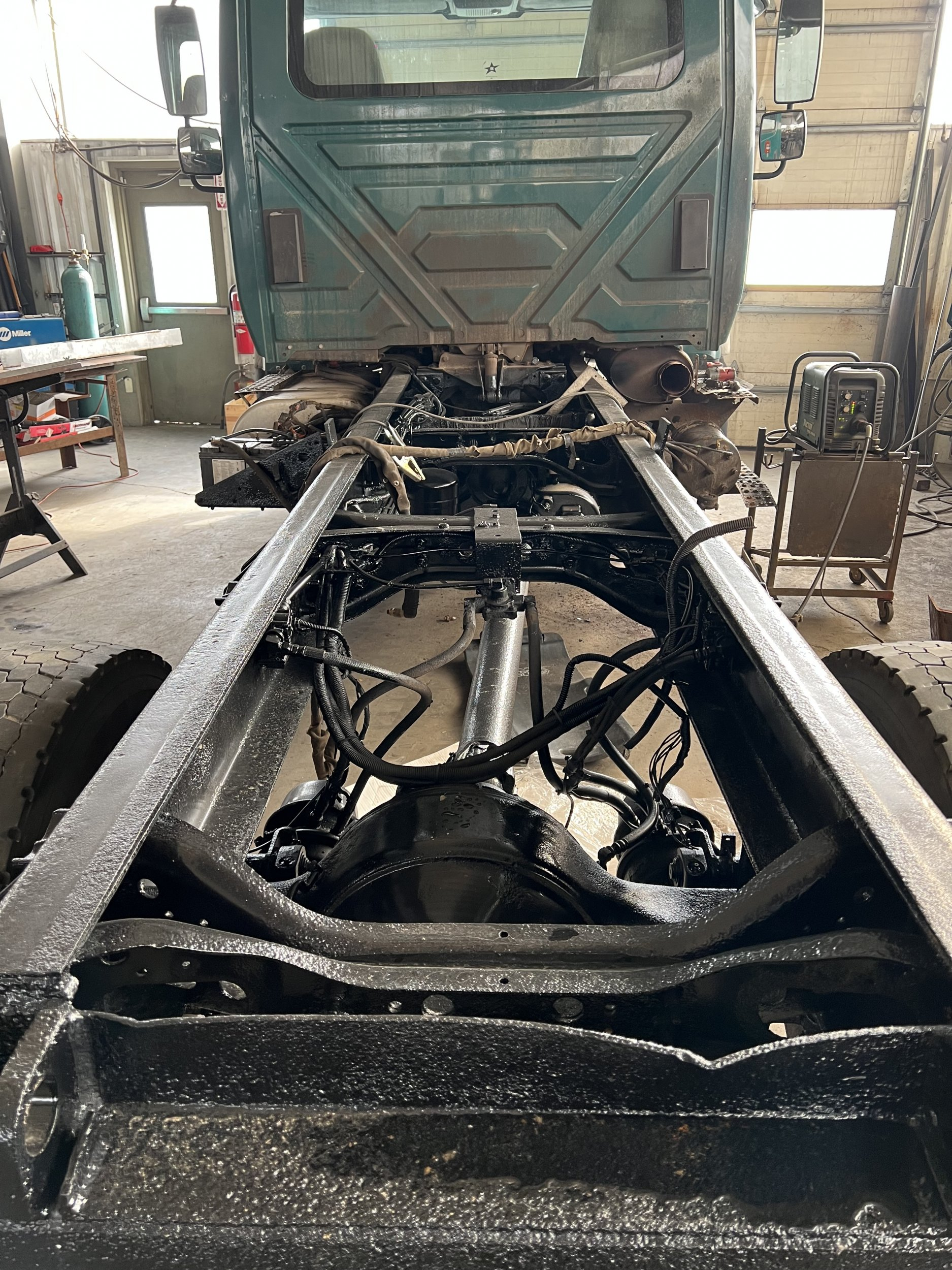

A few update pics. Truck frame is now sandblasted, primed & painted. It looks better, but reminds me of a kid with bad acne. The scars are still there. :oops:
We cleaned all the rust jacking out we could reach. You’ll also notice we removed the exhaust stack. I found some 5” exhaust pipe and we are going to try to fab-up an exhaust pipe. The stack is still good, but the bottom where water collects was toast.
I paid $18/foot for exhaust pipe and $24 for a 5” coupler. Not cheap.
Anyway, things are progressing, but slowly.
Not scars...character :).
What about just going with a turn down? If you can get away from a vertical stack it my prevent problems with a cab shield depending on the type and style of body you find.
You're lucky, there's no DPF or SCR to worry about. The newer trucks I was working on had $15-20K of exhaust crap behind the cab and enough structure to support a car bridge holding it up. Not only that, since it was an engineered system you couldn't move a thing from factory...nothing.
You get the frame flanges flattened down some? They don't look as angled up as they were.
......then we will know how to handle the end of the frame and moving the axle
Gonna have to watch your drive line angles too
