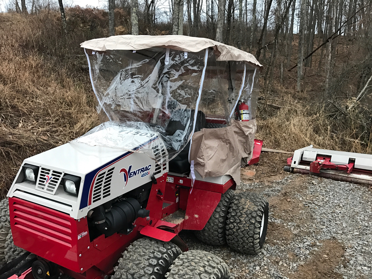

Put on a golf cart cover to keep rain and wind off of me. Hopefully will hold in some warmth. I probably should have set it out inside to get some of the wrinkles out before putting it on but as is offers good visibility. IMG_8310.JPG
   / New Ventrac 4500z owner #18
Put on a golf cart cover to keep rain and wind off of me. Hopefully will hold in some warmth. I probably should have set it out inside to get some of the wrinkles out before putting it on but as is offers good visibility. View attachment 492650
You can reverse the trans fan at the switch on your right side of seat. Not much but a little heat is better than no heat, I call that my poor man's cab.
