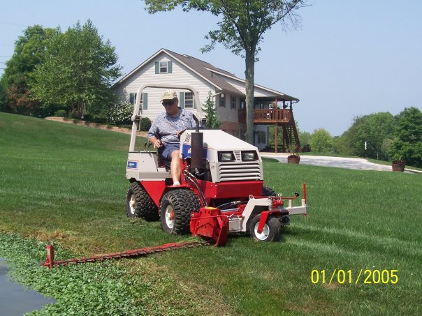

For the Samurai to work best you need to supply oil continuously through a power beyond valve. The standard Ventrac hydraulic valves do not have power beyond capability. Even though you could hook up the hydraulic motor through a standard valve you would have to hold the lever open all the time. This would result in overheating the oil due to the small openings in the valve spools. These valves were meant to be used on a momentary, not continuous, basis. I don't recommend you try it that way.
For a brief period of time an independent manufacturer in Ohio built a sickle bar mower specifically for Ventrac, but they are no longer doing that. See photo. Recently a used machine was for sale by Medina Tractor in Medina, OH. I don't know if they still have it.

Thanks Jack, I would plan to get the power beyond valve (would just need to find another way to mount it). I'll see what I can find out about the sicle bar !

Where did you get the one in the picture ???
Thanks again,
Bruce

I do not own the sickle bar mower shown in the photo. I do not recall where I got the photo--it was a long time ago. I have recently checked and learned that the mower was made by a third party in Ohio, but it is no longer available.
JackIL
