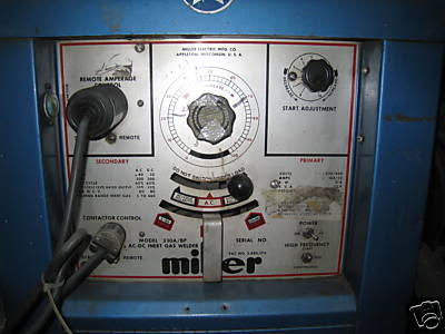

How old is your machine. I have a Miller 330 that was built in the 1950's that has a start circuit that can be adjusted from 0 to 100% of the amperage range that is selected.

That sounds like a high frequency for TIG which is different than hot start.
Has nothing to do with HF, which has it's own circuit and adjustments.
Say you are on the 50-225 amp range, you could set the main amperage control to 50% (about 112 amps), and if you set the start adjustment control to 60%, it would start at 135 amps.
Main amp control in upper center of front panel, start adjustment control upper right.
