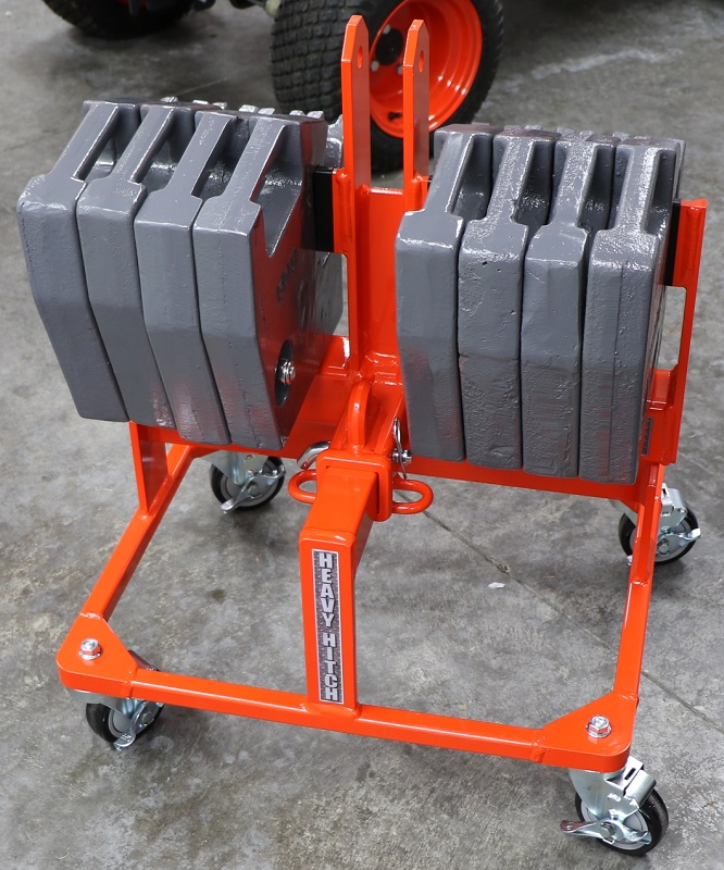

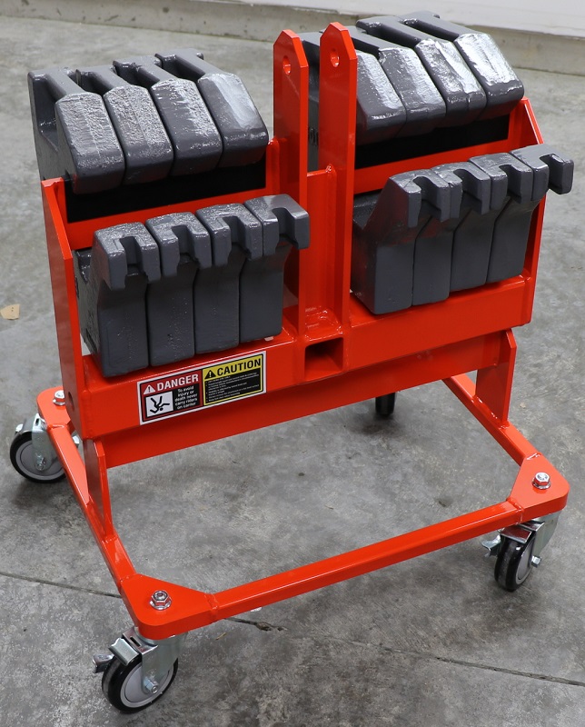

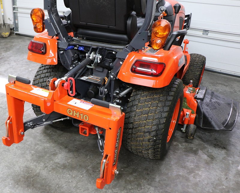

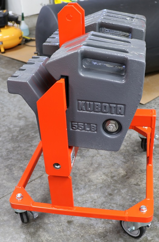

I went this route adjustable from 60 lbs to 500 lbs, Land Pride QH10, Heavy Hitch weight bar/hitch receiver, Kubota suitcase weights, Heavy Hitch weight cart for easy on/off with the Land Pride quick hitch. Note the Kubota suitcase weights on a Heavy Hitch weight bar will not fit the lower priced light duty Land Pride QH05 due to the arched Land Pride design on the QH05, note how far the weights extend forward from the weight bar.

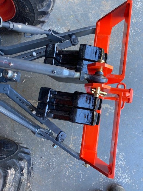

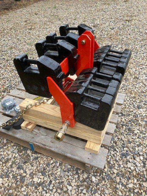

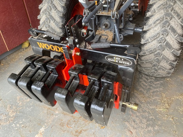

Are you still happy with your Heavy Hitch Weight Cart? I am looking at it for my B2601's dual offset rack Heavy Hitch. Also at their new heavy duty cart, which costs $100+ more. I think the regular duty would work, but I may have to keep it outdoors so it needs durability. I don't have enough cement or level ground to offer it much more protection than a tarp on my flattest gravel spot.
Also, I don't want it falling over if I have only one side of my hitch loaded. Normally I load the inner rack closest to the tractor with six 41 lb. weights. Somewhere I got the impression this unbalance would cause the cart to topple over, and I'd have to put some weights on the back rack to balance things. But the person I spoke to today at Heavy Hitch said that shouldn't be a problem.
I'd appreciate any insight from Heavy Hitch Weight Cart owners. My own attempt to make a 2x4 stand has not worked . . . It DOES topple!

Oh, and I see where I got the idea that weights are necessary on both racks of my dual hitch. The Heavy Hitch web site says for the standard cart:
  • Dual bracket hitch, but load must be balanced with an equal amount of weight on each side of hitch
This is NOT what users typically say or picture with the standard cart. AND their web site says the same thing for the HD cart.
