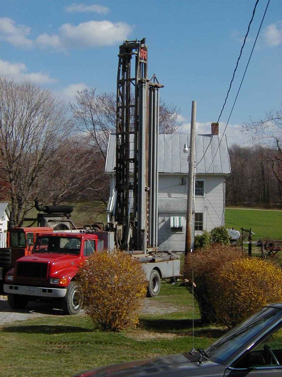

#21
I should know later today. Will keep you all posted.

Latest update. (as of 11:00 AM)
Second hole is 205'. Casing goes down 58'. Sides of the well (below casing) are unstable and will collapse in time. Only way to use what we have is to install sediment screen casing below the steel casing and backfill behind the screen casing with filter gravel (this will add $2366 to the price). Total cost for this hole will be $4866.00 + hook up and pump and tank. Total cost for first (dry) hole will be $1720. (He's giving us a break, $4 a foot instead of $8 and $100 to fill and seal)
If we decide to stop all work at this point it would be $2640.00, and we would be back to using the hand dug well, waiting between toilet flushes for the well to recover. I am told that once the rainfall gets back to "normal", the hand dug well should recover.
But will we ever get back to normal???? And what about the "next time".

Yesterday morning they checked what they had drilled on friday. The 130' shaft had filled in 10' on the bottom and in order to make it usable, a silt screen had to be installed and backfilled (between the stone and silt screen) with filter gravel. They drilled deeper to get a bigger reserve. The well is now 205' deep with 58' of solid casing and the rest (to the bottom) is the silt screen. Well has 175' of water standing in it and last night's pump test yeilded somewhere between 10 and 12 gallons per minute.
The first (dry) hole is 405' and driller is only (?) charging me $4 foot (vs $8) plus $100 to seal it. ($1720)
The second well was 205' ($1640) with 58' casing ($290) plus internal silt screen and filter gravel ($2366) plus grouting ($175) plus pump test ($200) plus well cap ($35) for a total of $4706.
Entire project is now to $6426. I guess it will be a while until I can afford some tractor accessories.
