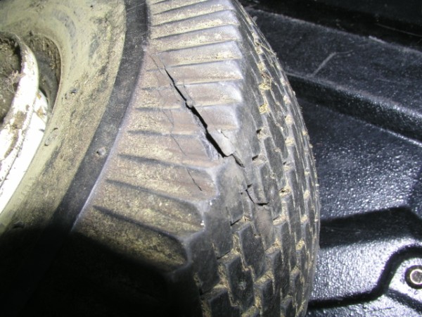

Well guys, I finally did it. It doesn't matter if you have pnuematic or solid tires. If you run over the entire caster it will cut the tire. Believe it or not I was mowing under some small trees and a limb must have caught one of the lynch (sp??) pins and the caster fell off. I did not notice it right away and ran over it while the mower was running.
Believe it or not the blades never hit any metal, just the tire itself. I really dont think PT will replace the tire so I have to purchase my own. Should I get another air tire or go will the solif or semi-pneumatic tire?
I have attached the tire/caster after my incident. I was lucky!

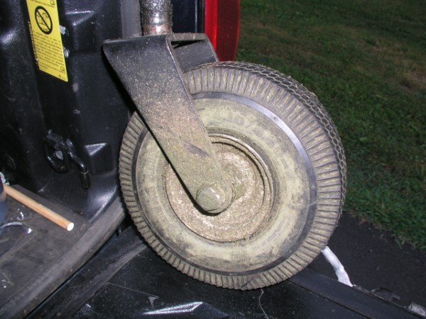

Another pic of the entire caster after the incident. Wow!
Has anyone used a bolt or something other than a lynch pin to keep caster in place?

I have had mine pop off the rim so often (before I put inner tubes in) that I would not use another pneumatic. I don't think you will be able to plug that tire.
By the way, my front tires have bolts with nuts on them instead of the pin. They came that way, I think you just found out why.

I noticed that Northern Tool lists a solid tire/wheel in the appropriate size. Sorry, no URL. From the illustration, it looks like it may be foam-filled. IIRC, it's about $20. If/when I have a problem, I intend to try them.

</font><font color="blue" class="small">( Has anyone used a bolt or something other than a lynch pin to keep caster in place? )</font>
All the finish mowers I have seen (fom 180 to 1430) have the pins as you describe. The brush hogs, on the other hand, all have bolts with Nylock nuts---for exactly the reason you have just encountered. If you frequently run in contact with low branches, I would suggest you consider a switch from pins to bolts.
