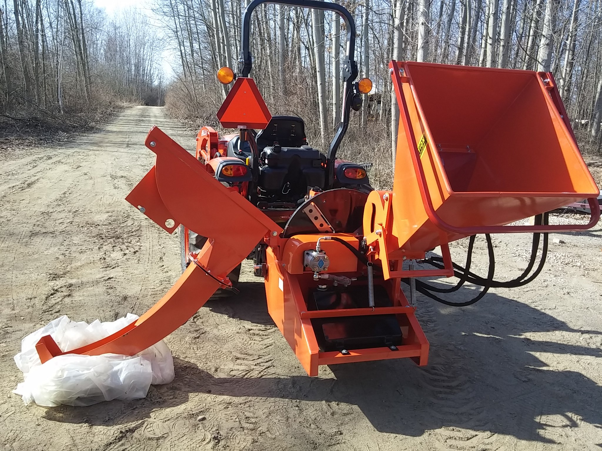

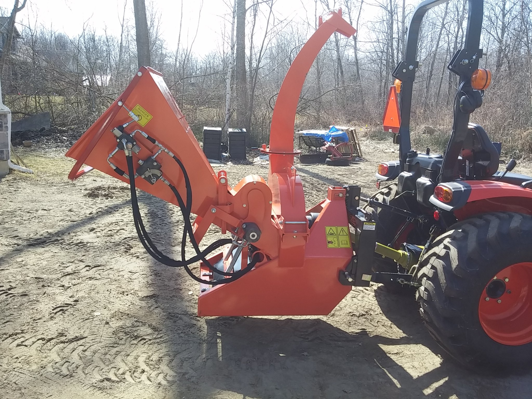

This is my new wood chipper. So far it has been very good. Hydraulic feed, variable rate, it will chip whole trees without limbing up to around 6".

Looks like a knockoff of a Wallenstein.
   / New wood chipper : guess the brand/model #3
Sure does. That tractor isn't capable of chipping a 6" diameter anything except maybe a rotten willow log or balsa wood. Not enough balls.
   / New wood chipper : guess the brand/model #4
Never had a problem chipping 6in hardwoods on my B2620 which has a smaller engine then the CK2610 that the chipper appears to be on. Yeah it'll slow it down, but even with mechanical feed I can do it, just have to feather the feed at times.
With that hyd. feed he shouldn't have any problems.
Correct, although to be fair I have chipped mostly garbage soft woods (poplars/willows/sumacs). But I do feel I could just slow it down a tad to chip hardwood.
Wallenstein gravity feeds at an angle, and their hydraulic feed has a straight chute, like a Woodmax WM-8H (which may or may not be a clone of the Wallenstein). Also the WM-8H is a 1080rpm machine, this one is direct drive 540rpm, 4 knives per rev. Much better for low HP machines IMHO. So Wallenstien is not the best match :)
