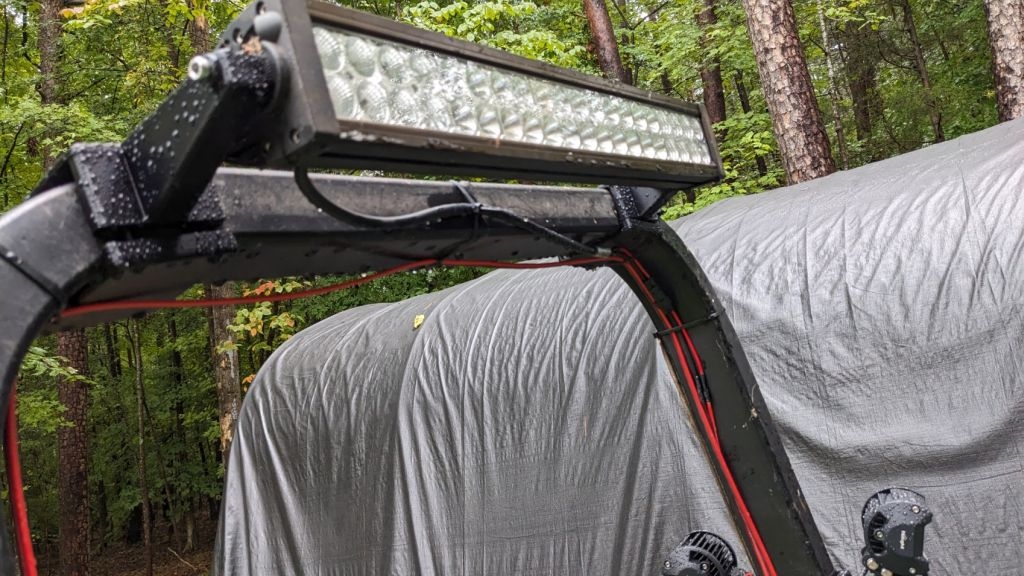

I have some new rear remotes for the 3038e getting installed on the right side & wanted to redo the work lights to keep the lower right portion of the ROP clear for the remotes install. All wiring runs up the left, over & down for the right side mount. No penetration of the ROP for mounts or wires. The lightbar is needed to supplement the headlights as they get blocked by the bucket when it is raised enough for movement.
These are the clamps I printed in ASA (temperature & UV stable). M5 screws & nuts used for assembly. M6 for the lightbar mounting.
Here's the full pic. Top lightbar, front & rear side lights.
Lightbar mount
Worklight mounts
14 AWG silicon coated wire, marine shrink tubes & weatherproof connectors. The side worklights are new, replacing the two I originally used. The lightbar is from the original install a few years back. It was originally mounted under the ROP & could be rotated front or rear facing. After replacing the seat, reduced headroom had me bumping it sometimes so I redid the mounting approach & added the rear facing side lights.
ETA: source files (.STL, Fusion 360, .STEP) now on printables: Worklight mounts for 3038e ROP by Nikdfish | Download free STL model | Printables.com
