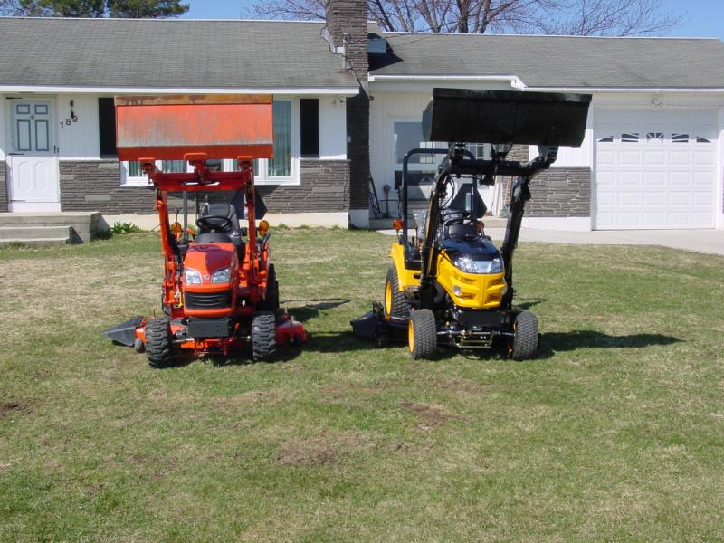

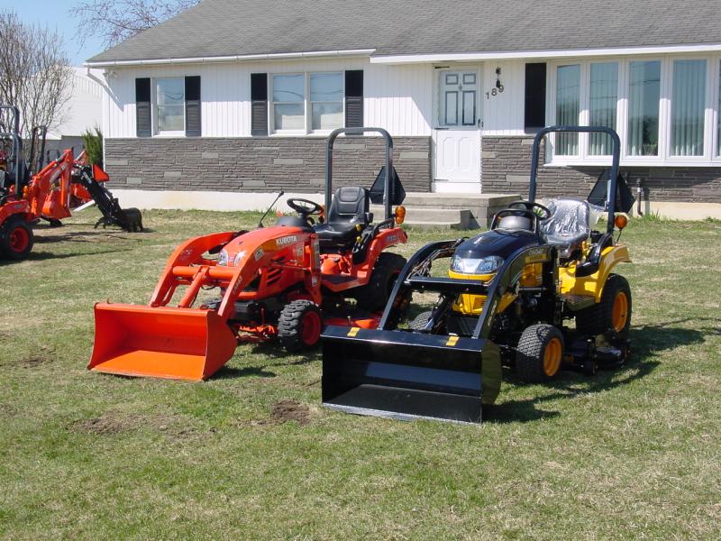

Here is a couple of pictures of the New Cub Cadet Yanmar SC2400 and Kubota BX2350V side by side

Comparison between the Kubota BX2350V and the SC2400 Cub Cadet Yanmar Sub-Compact Tractors
Kubota is 54.8 Cu In engine
Yanmar is 55.1 Cu In engine
Kubota is 1322 lbs
Cub Cadet Yanmar is 1280 lbs
Kubota 3pt lift 24" behind pin is 670lbs
Cub Cadet Yanmar 24" behind pin is 661lbs
Kubota Fuel Tank is 6.6Gal
Cub Yanmar Tank is 5.8Gal
Kubota LA243 is 1st numbers and Cub Yanmar CL100 is 2nd set of numbers
Max lift height at bucket pin 71.3 in - 71 in
Dump clearance 52.4 - 54
Reach @ Max Height 28.9 - 28.5
Dump Angle 45 degrees - 45
Digging depth 4.7in - 6 in
Bucket width 48in - 48in
Raising time to full height w/o load 3.5sec - 3.5
lowering time w/o load 2.7sec - 2.5sec
bucket rollback 2.4 - 2 sec
bucket dump 1.7 - 1.5 sec
Rated Flow 3.7 gpm - 3.5 gpm
Relief valve PSI 1778 - 1780 PSI
Lift Capacity 500mm fwd max height 518lbs - 550lbs
Lift Capacity pivot pin max height 745lbs - 700lbs
Kubota Breakout Force 500mm fwd 992lbs - Cub is measured at pins 1350lbs
