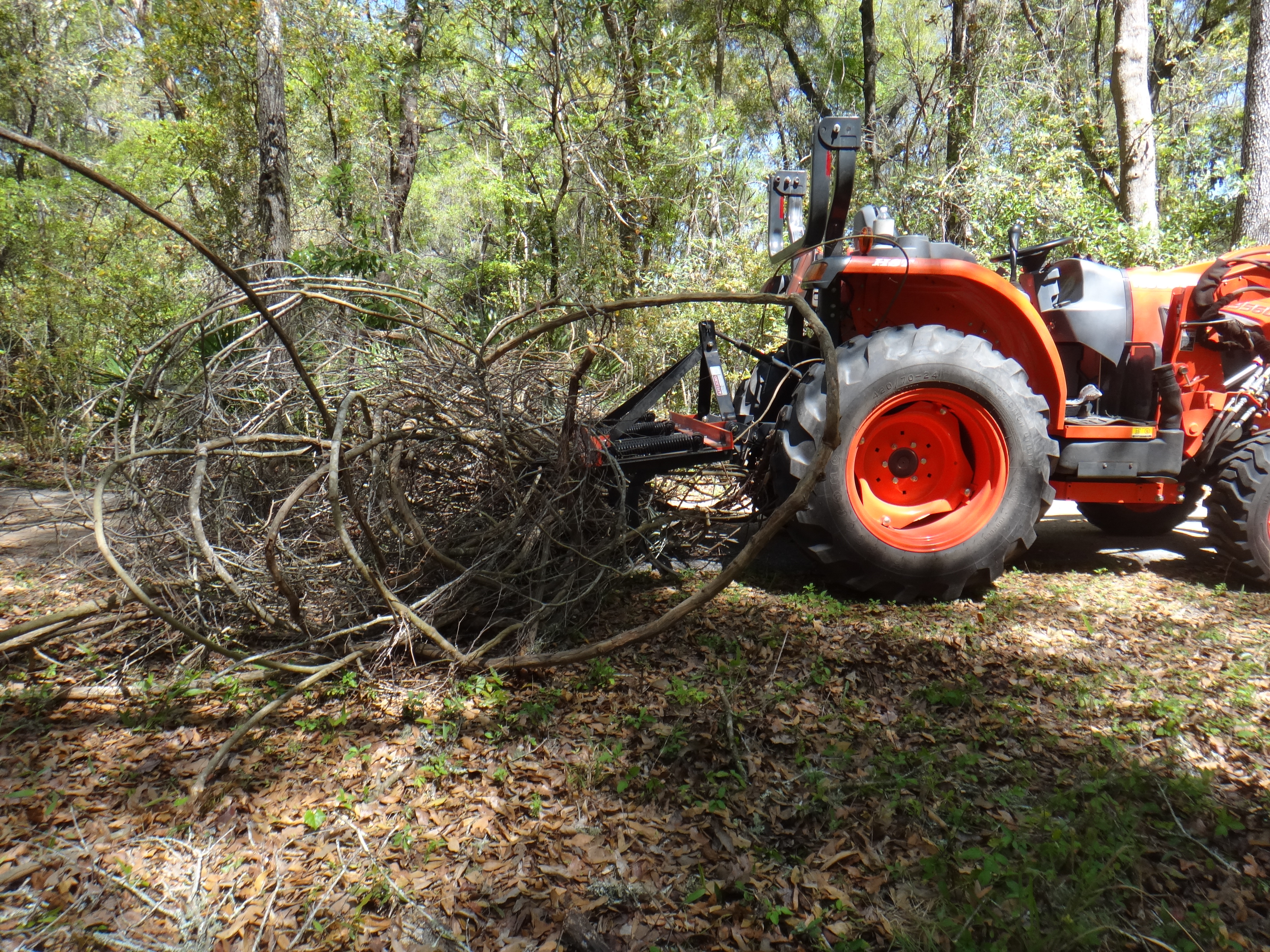

FEL is engineered to LIFT. You cannot push with FEL or you will bend/break it. (See above.) Heavy work should be done from the Three Point Hitch. While I do not have personal experience with Manzanita I have cleared a lot of Florida jungle with below grade roots. Consider mowing the Manzanita with a Rotary Cutter/Bush Hog, or ripping out the above grade plant with a Ratchet Rake, then raking out the roots with a spring protected Field Cultivator.
VIDEO: How to Use a Ripper / Field Cultivator - Gardening Series - YouTube
VIDEO: ratchet rake brush clearing - YouTube

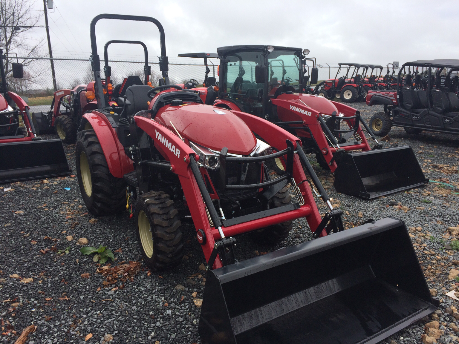

Can't help you with your vegetation removal. However, if your considering the L3301 you might want to check out the new Yanmar's as well.
The YT235 just arrived in dealers and looks pretty slick. 35hp 3cyl diesel, 3 range HST, price low to mid $20's. I checked one out today. Here's a pic.IMG_4334.JPG

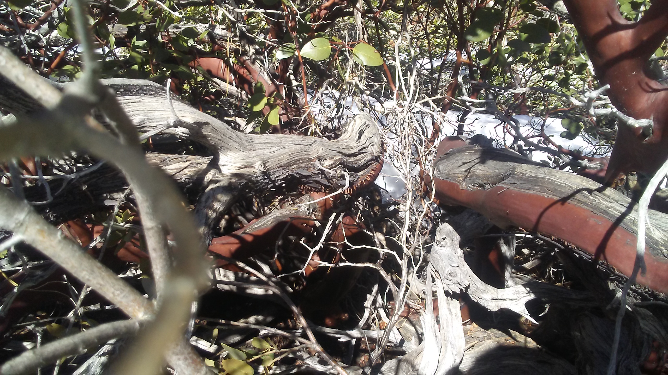

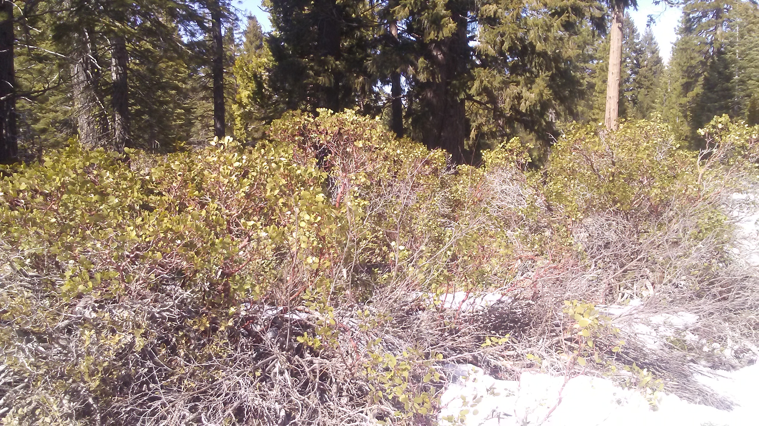

Thanks for the responses, i'll do some research on the yanmar, branson and mahindra tonight. Here's a couple pics of the kind of brush im trying to clear. Manzanita has shallow roots but thick wood stems so its hard to imagine a brush attachment would be able to cut them up. A grappler looks like it would do good.

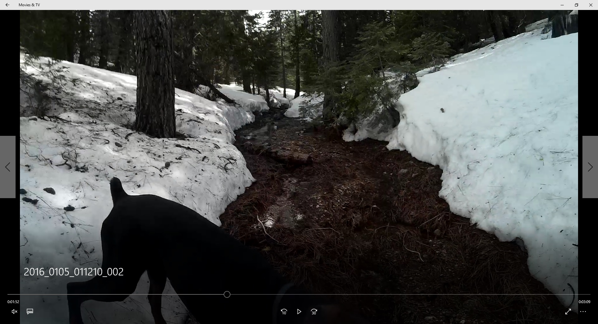

Another main thing i need a tractor for is to dig a pond. I have a small water drainage that has a large flat area that i need to dig out and dam up to store water for crops, showering, etc. The dirt is soft so i think a loader would do pretty good. Also need to build more out buildings which require digging a foundation and pouring concrete, along with a septic, sewer lines and water lines. I dug my house foundation by hand last summer and dont want to have to dig another, which is why i want to buy the back hoe attachment once the manzanita is clear and the pond built. Have a ton of trees that need to get cut down and turned into lumber, but i think the fork attachment will work great for that.

A medium duty Rotary Cutter/Bush Hog will slash that Manzanita down to ground level. Generally speaking, a medium duty Rotary Cutter is supposed to cut saplings up to 2" in diameter. I do not cut saplings thicker than 1-1/2" with mine. A Ratchet Rake will tear that brush out too, though slower than mowing.
The weight loading on tractor tires is HIGH. If you fill the rear tires, the tire load increases. Add a Backhoe and the tire load increases by ~~500 pounds~~. Tractors are prone to bog in soft ground. So tractors with Backhoes are infrequently suitable for pond work.
Sometimes, in a period of very dry weather, a Box Blade can be used to excavate a pond. Rarely, though.
VIDEO: POND Box Blade - YouTube
Usually a mini-excavator is necessary, which has a long reach arm, relative to a tractor Backhoe, and operates on tracks, not tires, spreading the load.
VIDEO: POND EXCAVATOR - YouTube

Good info. That ratchet rake seems to be the way to go, i just cant imagine a bush hog chopping up thick manzanita. Here is a pic of the area where the pond will go. Its in the middle of a drainage with two hills on each side, so i'm planning on pushing the dirt from the intake and center of the pond down between a narrow area forming a dam, so it wont be a typical pond built on a flat area as i already have two hills to work between. The snow may make it a bit hard to get an ideaUntitled.jpg

I'm familiar with manzanita. The stems can get to 2" or more on mature manzanita and it's a hard dry wood. I'd want to hear from people who have used a ratchet rake on it before I was convinced it'd be useful on older manzanita. I would not want to use a brush hog on thick manzanita but I cringe when I hear a lot of loud banging from mine. Maybe a extra heavy duty brush hog. My coyotebrush is too thick for a brush hog or anything short of a forestry mulcher so I'm clearing it with chain saw and chipper.
