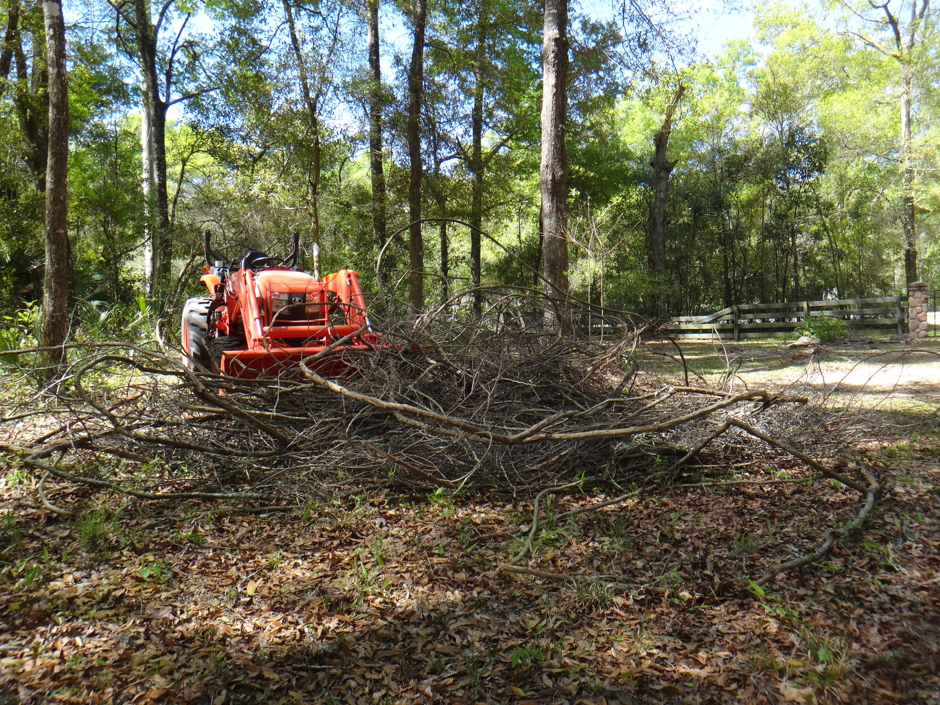

I've cut/cleared a lot of manzanita with my L3400. I used chainsaw to get to exposed stump, leaving at least 18" stump for push/pull leverage with FEL. Hard on equipment, and way too much manual labor. New L47 TLB with grapple and backhoe makes it more fun. Stack in manageable piles for chipping, rent a chipper w/ hydraulic feed, or stack/compress pile and burn in the winter months.

From youtube videos it looks like a grapple would rip the manzanita out. Would be nice to be able to move them into piles. Looks like it would work for moving timber. I'll be looking at a larger tractor...doesnt look like the L3301 would be able to handle moving timber around.

Ratchet Rake is an A-1 tool at piling debris. Down oriented row of 1-1/2" teeth combined with curl provide just enough grab. FEL articulation in two planes makes debris piling a snap.
You can order any size Ratchet Rake from the T-B-N store, button a the top of this page. Freight is offset by no sales tax. TSC sells the Ratchet Rake too, but TSC is hit-or-miss on Ratchet Rake inventory and you have sales tax.
