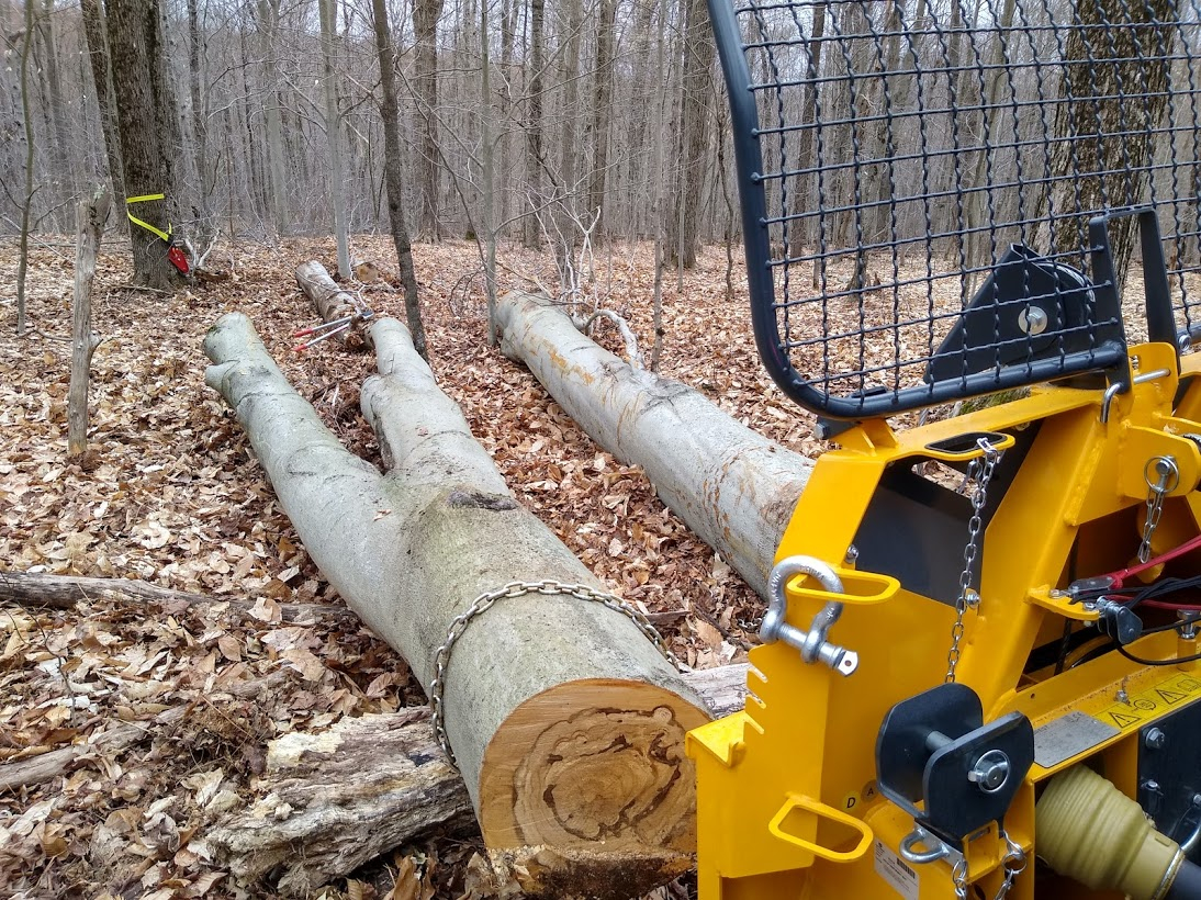

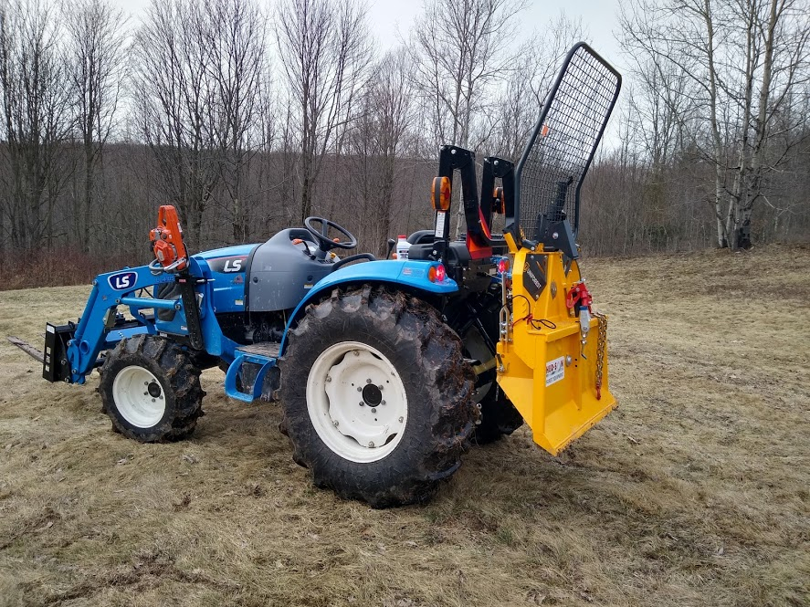

I bought a mt350 a year ago and it has been fantastic. Tough machine that has given me no problems and has done everything i've asked it to do without issue. I use it mostly with a Uniforest/Hudson logging winch to pull out cut and downed trees and you'd be amazed at the weight this can pull. Good luck with the new machine and trust me it'll do everything you ask it to do and more.

Heres a pic of the winch, and what it can pull....mt350 with loaded rears- slow and steady and it can pull almost anything within reason

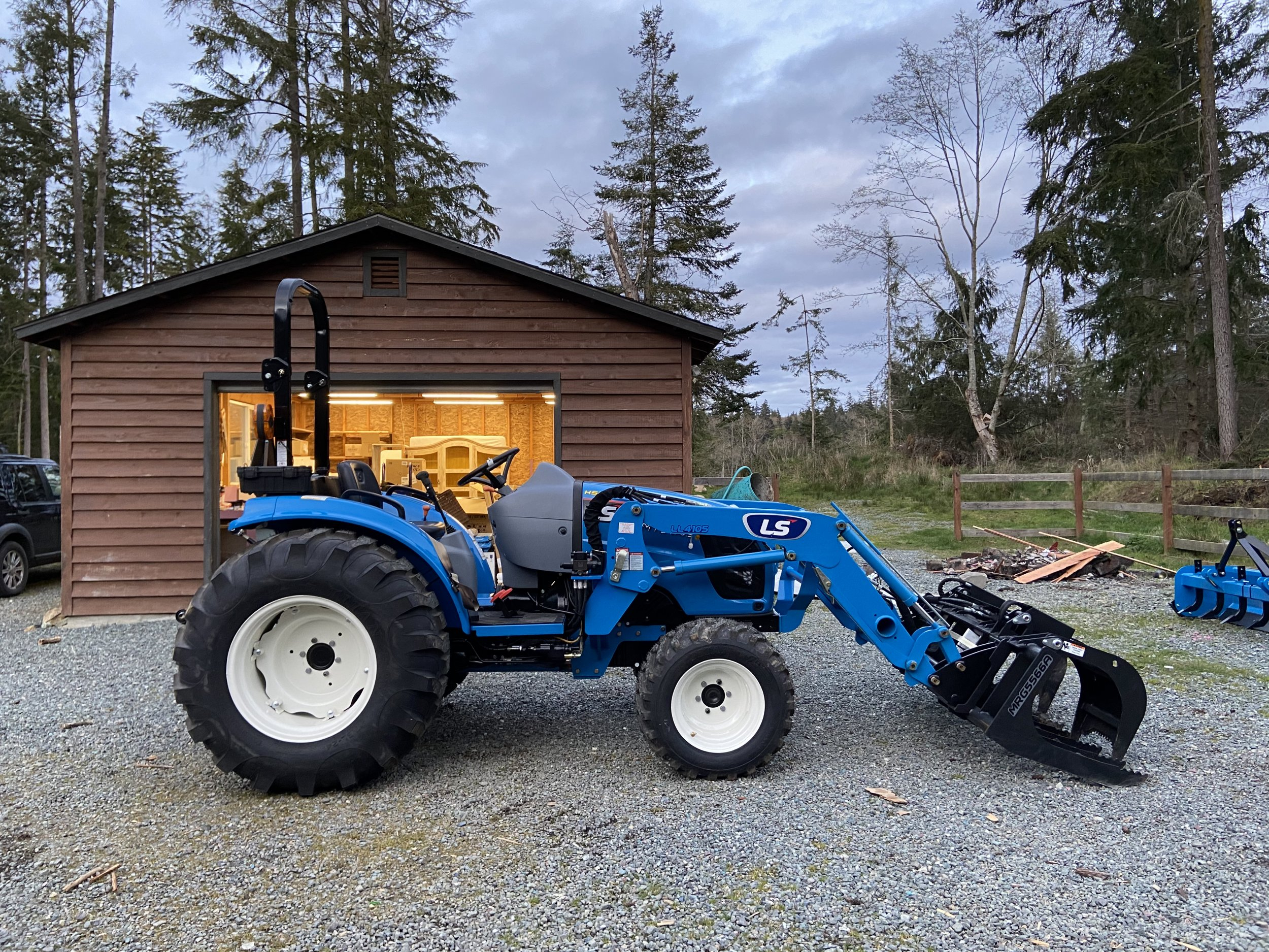

Well, the mt350 arrived last week and my only complaint is not having enough time to play with it!
The grappler is awesome and is going to be very useful. Still getting the hang of the box blade... I’ve been practicing on some washboard in the driveway, and created a flat gravel pad for the kids trampoline in the yard.
I think I could really use that winch. Haven’t used the pto yet. Need to get some earplugs for the wife 😁
