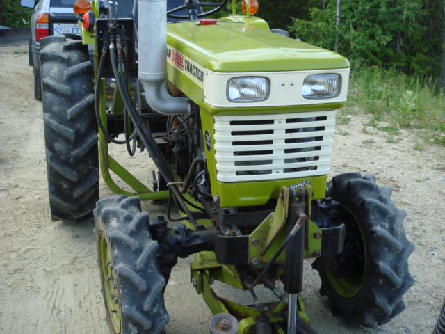

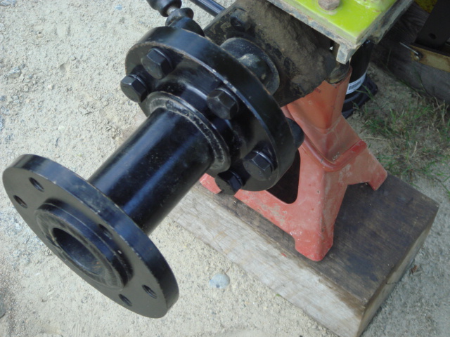

I added the spacers on to my 240D. My rear tire width is now 5 feet outside to outside. It gives a nice stable look to the tractor, certainly better than original.
Added a few pictures for anyone who might be interested.

Your 240D looks good! Thanks for posting the photos.
Here's another way to get 5 ft width. My 240 is 2wd so I don't need to worry about front/rear tire ratios, and it came with separate rim/disc rear wheel assemblies. A previous owner had put on 12.4x24 tires on the proper 11 inch rims, apparently off a Kubota. Overall width is right at 5 ft. The big tires carry more water ballast which is helpful for a 2wd.
