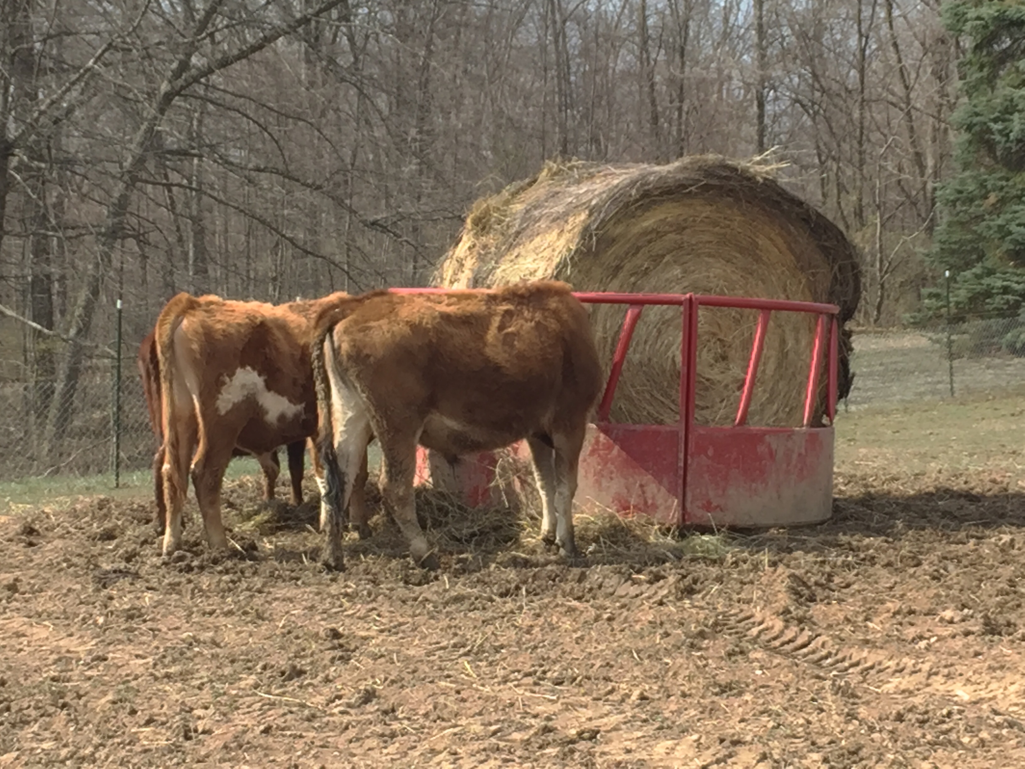

I ended up buying an 05 4320 for around the same money, here's why I needed a bigger tractor on 3 acres. IMG_7252.JPGIMG_7255.JPG
I also figured up that I put around 3h a month on my tractor, so I have roughly 155 years left before she's wore out lol, that's at 6k hours, she could go past 9k hours with proper maintenance, I'm 26 years old, my grandkids could get my tractor lol.
That being said I'm super glad I got the tractor I got, it's not too big at all, actually I wouldn't mind a 55hp tractor to run a proper round bailer. I could run a 4x5 round bailer but just barely, but I like all the options a big tractor has to offer.
Due to FEL lift capacity (round bales weigh 700-1500lbs), I needed to be in the 3 series (30-40hp) range. That bale in the pic was over 1000lbs and I was glad I didn't have a smaller tractor to handle it with. It was so heavy my 400 loader couldn't curl it at ground level, I had to lift it 3-4ft to get it to fully curl.
