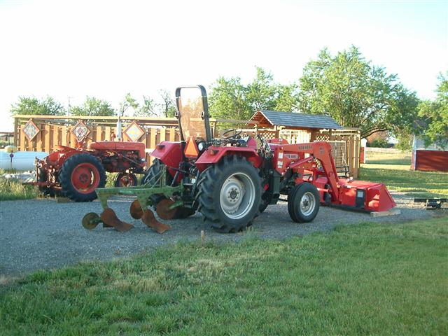

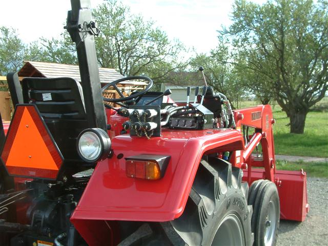

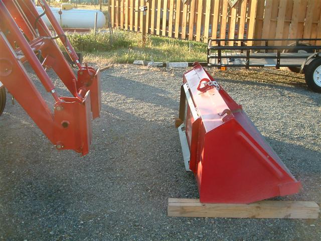

My 2008 Mahindra 5525 (54 hp engine, 45 hp pto, 2WD, gear tranny 8F/2R, power steering) with the ML250 FEL (6-ft bucket, 2950 lb lift to 10.5 ft, skid steer quick attach) cost about $19K plus tax new. I use it for haying on my 10 acre spread. Something like this rig would handle all you present and future chores.
YOu need to think about features you want on your tractor--like rear (and possibly) front hydraulic remotes. My 5525 has triple remotes installed by the dealer when I bought the tractor ($750). Larger tractors generally have dual rear remotes.
Also, get chain hooks installed on the FEL bucket-- my dealer installed mine (I bought the hooks, he did the welding, including a 1/4" thick reinforcement plate along the top of the bucket. You can see these hooks in the 2nd photo above along with the skid steer quick attach rig on the ends of the FEL arms.
Of course, you can save $$$ by going with a smaller tractor, but with the size of your place, I wouldn't go below 40 hp (pto). Or you can go with a used tractor--but that puts you in another ballpark where you need experience in sizing up candidate tractors and where you need to be able to do a lot of the maintenance/repairs yourself.
