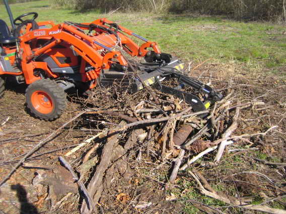

I am doing similar work on about 4 acres and would suggest you consider saving the same $$$ and getting a 20hp tractor TLB but adding a true grapple rather than a 4 in 1. Unless you need to have a mini bulldozer (which the 4 in 1 will do), you would find that for grabbing a moving brush that a true grapple is a far superior tool. I doubt a 4 in 1 could take a bite of brush like this (photo). If you don't want a grapple, consider adding a "add a grapple" to a regular bucket. I am pretty sure that would also be better for brush than a 4 in 1. The 4 in 1 has its place but it is more of a construction tool than a landscaping tool.

Follow up photo, same "bite" with grapple as seen in earlier shot.
