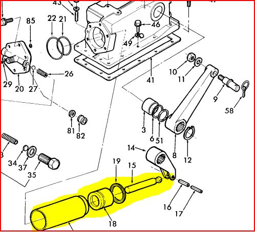

Hello I am new to the tractor scene and need a little assistance. I have a 86 Ford 1910, my first question is when I shut off my tractor is it normal for my 3pt hitch to drop all the way down. Next is it normal for the tranmission and PTO to get very hot during bush hogging. Here is exactly what happened, I had to drive about 45 minutes across the lease before arriving to the spot I was going to cut, immediatly after getting there I started cutting in some pretty thick brush for aprox 1 hr. When I was done I shut down the tractor and noticed excessive heat coming from the transmission housing. I also heard a hissing noise coming from the top of the rear diff. After investigating the hiss I found it was some sort of relief valve. The PTO shaft was also very hot to the touch. I check the fluid and its clean and has the proper level. Any help would be greatly appreciated.

The answer to both questions is no. If the lift drops when engine is switched off, it indicates a sizable internal leak in the lift system. The heat issue could be pressurized oil forced through a small space(relief valve?) I assume the hissing sound is with engine running, right? The parts breakdown shows more than one hydraulic option for your tractor, with/without draft, single or double remote valve, etc. Each option has different componants that could be involved. I suggest you access an online parts break and identify the system and componants that most resemble what you see on your tractor. That should help narrow down the possible causes. Could be as simple as a sticky or rusted piece of linkage.
   / Newbie Hydraulic Question #3
Leaky lift piston seal is a huge possibility and the easiest to repair.

Thanks for the reply Harry. I do not have draft and I have a single remote valve. The hissing was when the tractor was not running. I said a relief valve but im not sure what it was. Its a vent on top of the rear differential and has a plastic cap on it. when I touched the cap it felt as if it was spring loaded and air started coming out even faster when I applied pressure sideways on it.
Where is the lift piston seal located? And wouldnt I see fluid leaking from the tractor. I dont see any visible leaks.
JC,
Is this what you are talking about?
   / Newbie Hydraulic Question #7
Bingo.:) Yep, #19.That is right. I'm not saying that is your problem for sure but the likelihood of this to be the culprit is very high. checking it easy , cost you one hr of labor if you do it yourself and material is under $15. I'd check it before I dive in any deeper to more sensitive part of the hyd system. You might look at the link below. There is a lot of info thee but you'll be able to find what you need.

Thanks for the info Jim. The lift drops almost immediatly when i shut it down.

First of all you were working the tractor hard in very high ambient conditoions,(98°F is considered hot but in may not be considered that where you are from!)) The transmission is not 100% mechanically efficient, more like 90% or less. The 10% or more loss in efficiency shows up as heat in the transmission so your drive line fluids can get plenty hot, especially when they start out at 98°F. That's normal. Hot fluid also means the casing is hot as is anything else bathed in the fluid.
Secondly, there is probably condensed water in the fluid. When the fluid gets hot, the water vaporizes and the air in the compartment get's hot too. The hiss you hearing is probably from the vent for the rear axle/hydraulic compartment which is most likely under the seat. If you hear the hiss when the three point lift is raised and the tractor is running then it could be a stuck open relief valve in the hydraulics but if you hear the hiss with the tractor shut off then it' s most likely the hydraulic compartment vent. Make sure that vent stays clear because otherwise the pressure can build up in the compartment and blow some seals.
As far as the lift dropping, it depends how fast it drops with an appropirate load on it. If your load is rated at 1000 lbs don't expect it to hold up a 1500 lb weight. It may open the relief valve and not hold that when the tractor is running. It's normal for the three oint hich to settle when the tractor is shut down with a weight on the hitch. If it rops imeditely, you have a leak somewhere. It could be some crud in the relief valve holding it partially open or it could the piston seal on the lift cyinder. If you hear a kind of screaming noise with a load on the three point and the tractor running, that could be a partially open relief valve. A modern tractor with aproperly functioning hydraulic system might settle in anywhere from 15 minutes to 24 hrs or longer.
Obviously a 15 minute drop indicate more leakdown but it still maybe acceptable. On my TO-30 Ferguson 15 minutes is considered acceptable sealing.

3pt drop is very likely a leaky oring.. that's the hiss you hear at shutdown. oil lekaing. mind you it could ALSO be other leaks.. like a lekay relief, check or safety valve. bototm line.. SOMEthing is leaking.
as fo rthe heat. an hours worth of hard work, after a 45minute drive on a 98' day? i'd expect something to be hot too!
make sure it has the proper oil at the proper level and make sure no hyd remote ports are kicked in to operate.. past that. it's got a internal leak.. not a huge deal to fix or ignore as long as the pump makes enough flow to overcome it when running.. :)
