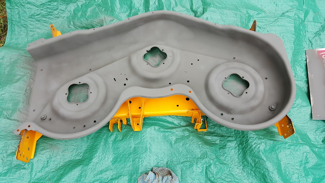

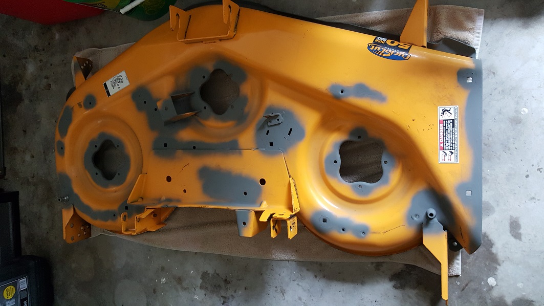

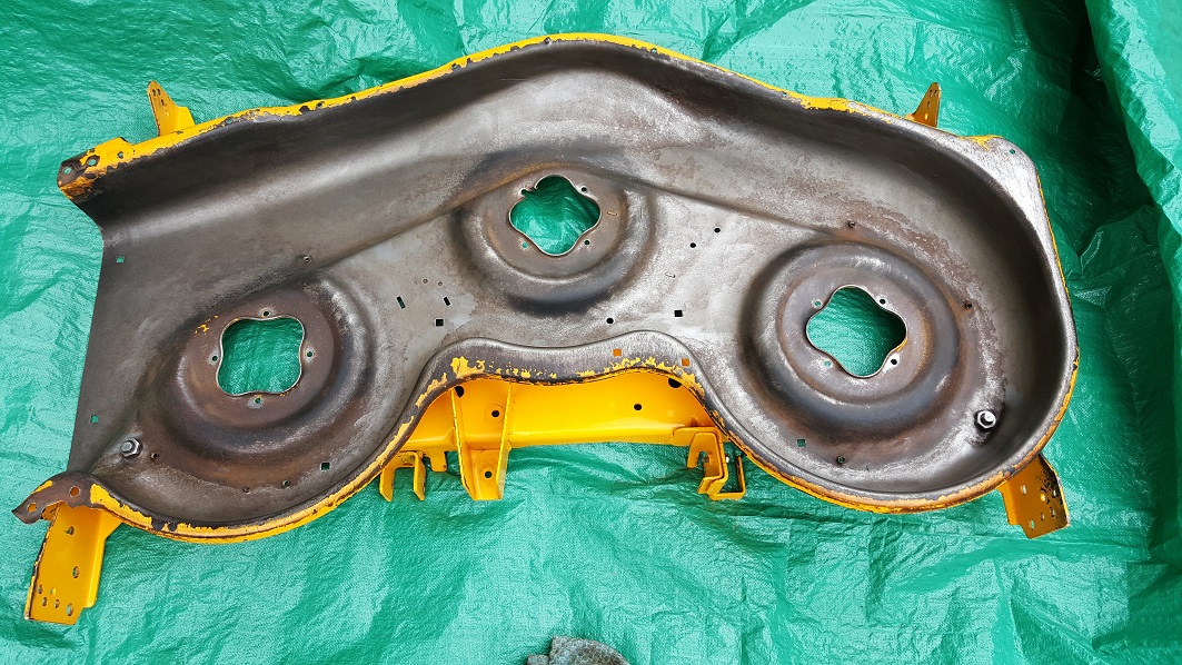

Today I attacked the deck, removing all the spindles, idler pullys, etc etc. I used a wire wheel attached to a drill and shined all the rust up pretty well. I used some course steel wool, blew debris away with blower, and cleaned with acetone and a rag. I used rustoleum self etching primer and put a couple coats on.
I found a rattle can of cub cadet yellow at tractor supply. Figured I'd use this for the top of the deck, should I use something different for the bottom of deck? Also got a can of mo deck from tractor supply.

farmingusa - you've done a good job on the deck - both sides. The rattlecan yellow will do just fine over the primer on top and you can spray under if you desire. But, won't be long that the grass cuttings and other stuff will take that paint and primer back to bare metal. Lots of people have tried all sorts of finishes under their decks with mixed results at best... usually best just to make sure you put machine up with deck as clean/dry as possible (scrape if necessary) - and in the fall, make good use of the dried fallen leaves - they do a great job of scouring out the underside.

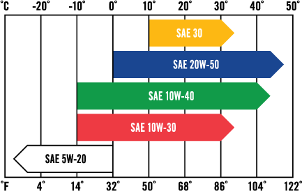

Having 50 plus years of experience with engine owning and maintaining....in everything from mowers to tractor trailers, I sure wouldn't recommend running a straight 30 weight oil in your engine. This chart was taken from Kawasaki's site.....take note of high temperature operating limit they suggest. In Florida, a 30 weight (or a 10w30) isn't going to cut the mustard.
On any engine, most wear occurs at start-up. A multi grade (10w40, 15w40), will flow, and begin lubricating, quicker....reducing wear.
I just serviced and put my mower away after completing it's 11th year of use. Always use a 15w40 dino oil....and I'm in upstate NY..... mower now has 1,130.4 hours on it, and still runs strong, doesn't require any make-up oil between changes, no drips, leaks, smoke...
Do a bit more research before using a 30 weight in your climate

OP - gotta say that Bob is right on advising 10w-40 vs 30w for your engine. Stays pretty warm year round down in yer neck of the woods...
